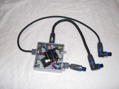

I've always wanted to try my J110 and T39 as a bass combo and I finally got a crossover built. I built it in an external box for flexibility. With a little trimming, the inductor fit just right in an FS electrical box. Pic below.

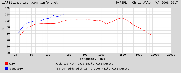

Perhaps the chart below shows it visually. If I'm pumping equal low-end power into both the red and blue lines, the red line is adding very little to the overall low-end volume and is mostly a waste of watts.

Part of that lies in the fact that at those lower frequencies the T39 is just way more efficient and there fore dominant.If the raw Jack efficiency was equal to the T39 then I would think you will get an increase due to mutual coupling. In this case since the Jack efficiency is roughly 5db lower I doubt there's any gain in the lower region under 100 hz.
If you dont get at least 3db increase your just not gonna hear it.Of course there's the mixing cabs thing to worry about as well. The Jacks I believe are no longer horn loaded in those lower ranges so basically that becomes a direct radiator with reflex ports running with a Horn sub. That I believe is a no-no!.

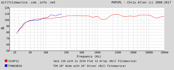

Another interesting chart is this one. It's an equal voltage comparison of the low end for a J210 (4 ohm) and a single T39 (8-10 ohm). The graph says they are about the same volume and that's what I found with an informal listening test in my garage. Of course, as we learned earlier the T39 is getting there with half the power.
I don't want to push them to war volume in my garage, but I'd like to figure out which rig has the highest maximum output (assuming unlimited amp power). The J110s are loaded with 2510s and the T39 is loaded with a BP102. The BP102 has more xmax, but the J210 has two speakers. Do those cancel each other and leave it a wash?

DaveK wrote:The BP102 has more xmax, but the J210 has two speakers. Do those cancel each other and leave it a wash?
Pretty much, though as you noted the T39 gets there with half the power. That's always the trade off, size versus power. A smaller box can equal the larger one with adequate driver displacement and enough power. But load that T39 with a 3012LF and enough power to drive it to full output and it leaves the J210 well behind.
