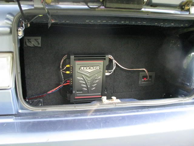

I got a Pioneer head unit, Pyle 4x6's in the doors and 3.5's in the rear. I also picked up a Kicker amp 2 channel, Bridged at mono for 100 watts. I feel I had more than enough power.
I set the amps X to low, and the head unit X over to 100hz. (I don't know what to set the high pass filter too, I think 80 or 63?).
I mounted the amp on the sub which might of been a bad idea due to the sub vibrating so much it might rattle things loose and cause a malfunction.
I set the bass boost and gain on the amp to all the way down to start.
The clarity of this box is unreal. It sounds just as good in the car as it does in the house but lower. Probably the tight quarters in the trunk.
I had to set it in side to side due to the small space in the trunk of a VW Cabriolet. (pics tonight, wife took the car to work :evil: I WAS GOING TO!).

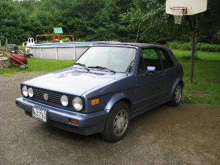

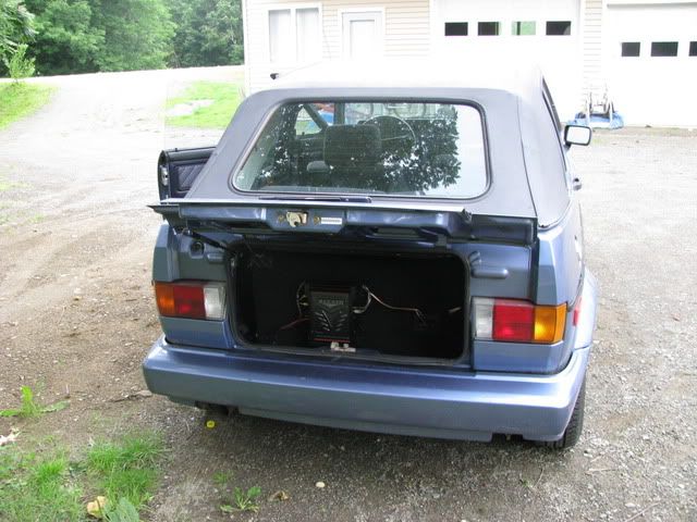

OK here we go!
Small car I know. Thats why my wife drives it.
It sounds so rich and has big bass.
Too much for me, but for sales......
I have the amp turned way down and the bass booster turned off. With that off I still bet it would beat a 12" front loaded car sub.
The thing I like about this one is that unlike the front loaded car subs, you don't have to be careful of breaking a speaker cone. It is all self contained in it's own little box.
Though this car is small and makes the box look big. :mrgreen:
