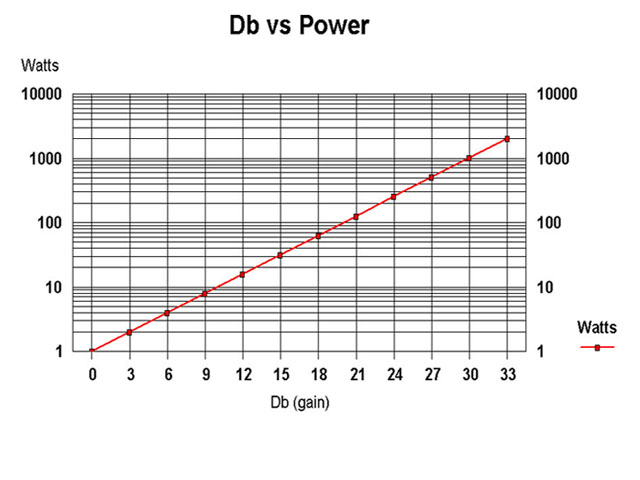

Sydney
Re: O10.5 holy crap on no watts!
#15 Post by Sydney »
In the end, it is not about the gross power. It is all about the individual sensitivity,
The significance of the sensitivity is shown when you graph db vs power.
And because we perceive sound logarithmically not linearly with power
A typical speaker producing 90db for 1 watt requires 10 watts to get it to sound twice as loud , the next 10 db require 100 watts, and the next doubling of apparent loudness would require 1000 watts, BUT would be unobtainable because voice coil thermal effects have already started and the voice coil would fail.
A horn speaker with a sensitivity of 100db/1wt/1M already sounds 2x as loud as a 90db speaker for the same wattage ( ie add the 1 watt/SPL value to the graph value ). At 10watts it is 110db, at 100 watts - 120db (theoretically). On the average the horn will only require a fraction of a watt to be very loud.
High Sensitivity starts you off ahead of the game.
BTW: It is not uncommon to have peaks that are much higher; A 90db speaker with 1 watt has been observed requiring 200 watts for brief peaks.
With a high sensitivity speaker you have plenty of headroom for these peaks.
It is the reason that guys with very small SET and Class A amps ( that only put out a few watts ) are satisfied when hooked up to full range horns.
Also something to consider next time a discussion takes place over the (in)significance of Max power handling; Very little is gained ( except damage ) after the 1st 100 watts (20db).
