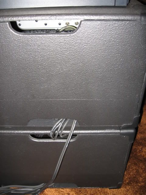

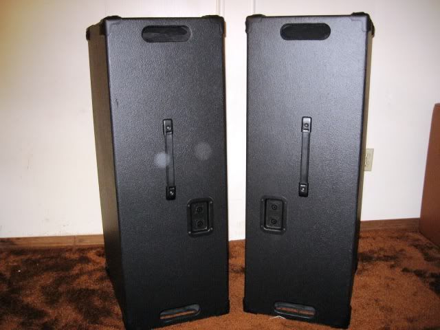

Anyone got pics of their finished cabs with it rolled on using one of these rollers?
This is the best shot I could find that shows the texture. It feels very smooth and not like sandpaper at all.
EDIT: This might be a better shot.
