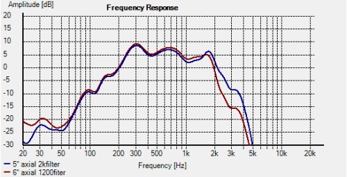

So I have two OT12s that were purchased off the forum by a colleague. They are currently loaded with Beta 12s and compression horns with ASD1001s. I’m looking for some better clarity and output, so I ordered a pair of Kappalite 3012HOs and a pair of FaitalPro HF108s and FaitalPro STH100 horns, at the recommendation of said colleague. My intention is to replace the OT12 compression horn with the Faital horn and cross them over at 1.2khz. So here’s my question: these cabs have a 5” phase plug. A 6” phase plug is speck’ed for Bills compression horn crossed at 1.2khz. What am I giving up by running this setup with the 5” plug, and which horn does the phase plug actually affect? Would it be worth the effort to add back material to have a 6” plug? I’m all ears, feel free to poke holes in this idea. Thanks!

With the 1.2kHz HF the 6" plug works better than 5". You could add 1/4" thick 6" circles to the front of the 5" plugs.

Thanks Bill, that answered my question. I will add the 6” disc if I’m not satisfied.

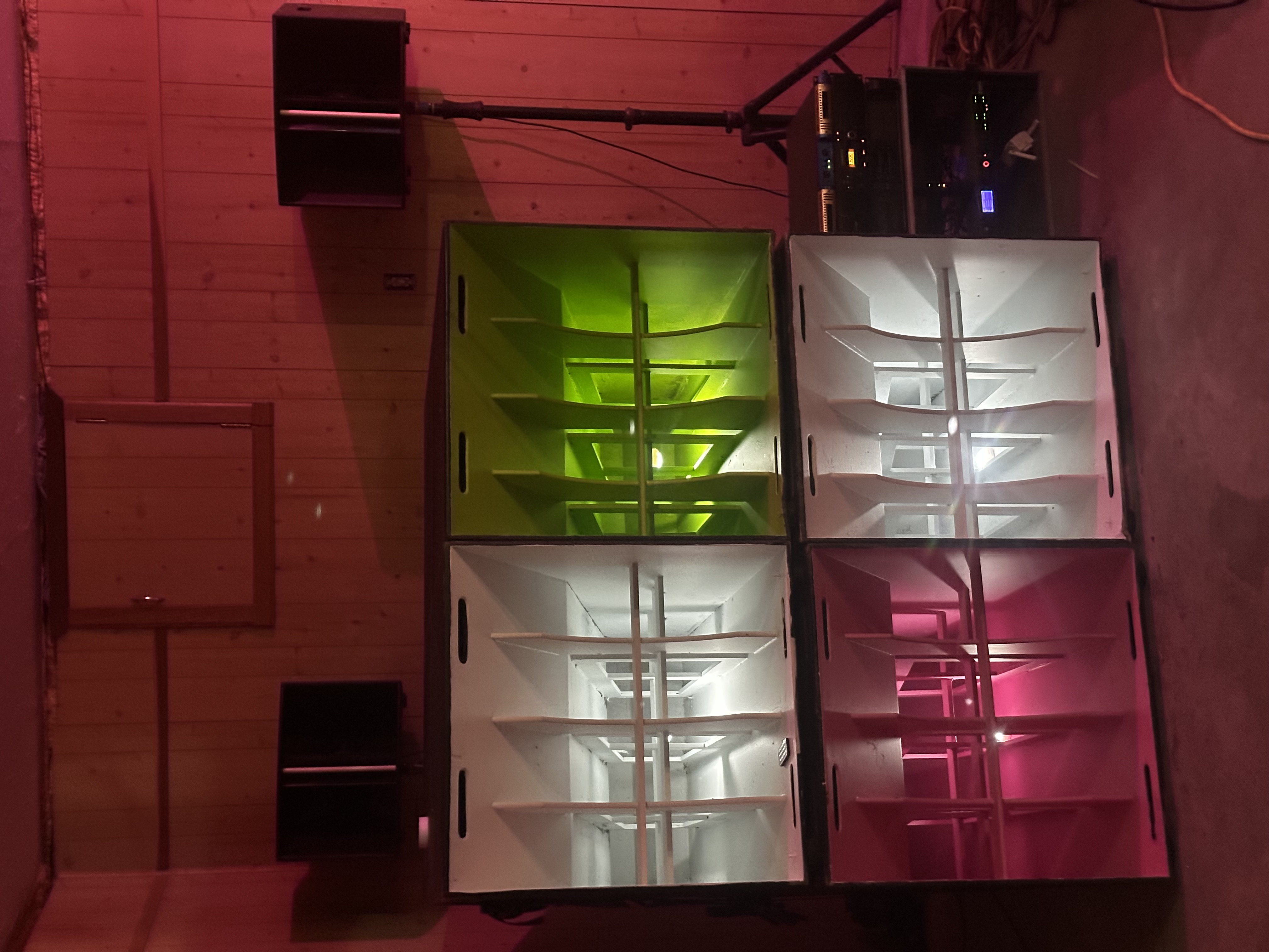

Had a great New Years with the two OT12s, and four T60s. I didn’t have time to change the phase plugs with having to get everything else ready in time. I did a quick outdoor measurement of the omnis the day of, there was a pretty substantial drop off at 1.2khz. Eq helped some, but I will definitely be modding the phase plugs in the coming weeks. The Kappalite 3012HO was a substantial improvement, I will be modding the other two Omnis shortly as they are now in my possession. Overall quite happy with the dispersion and amazing clarity from the compression horns at such a short listening distance.
