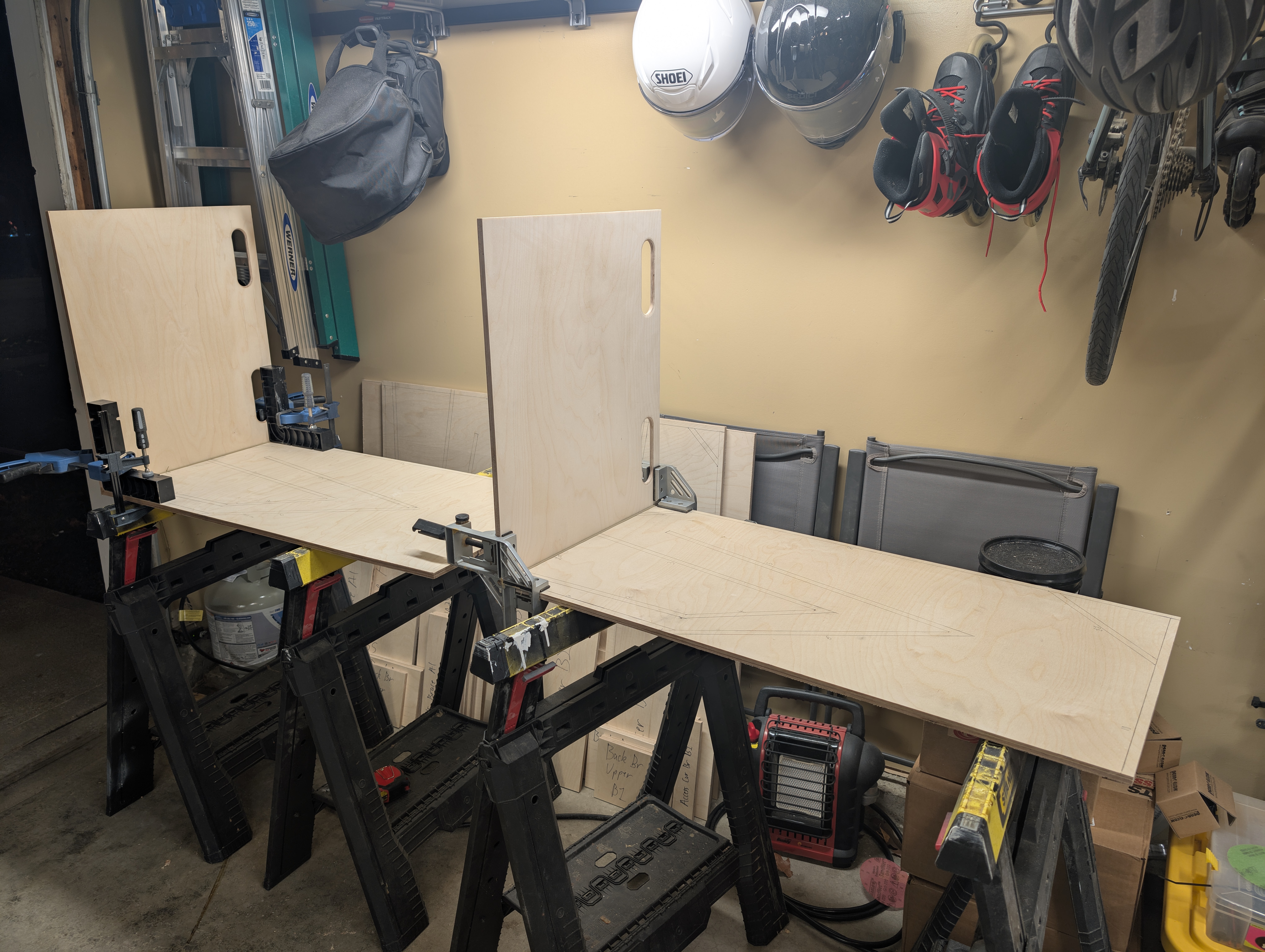

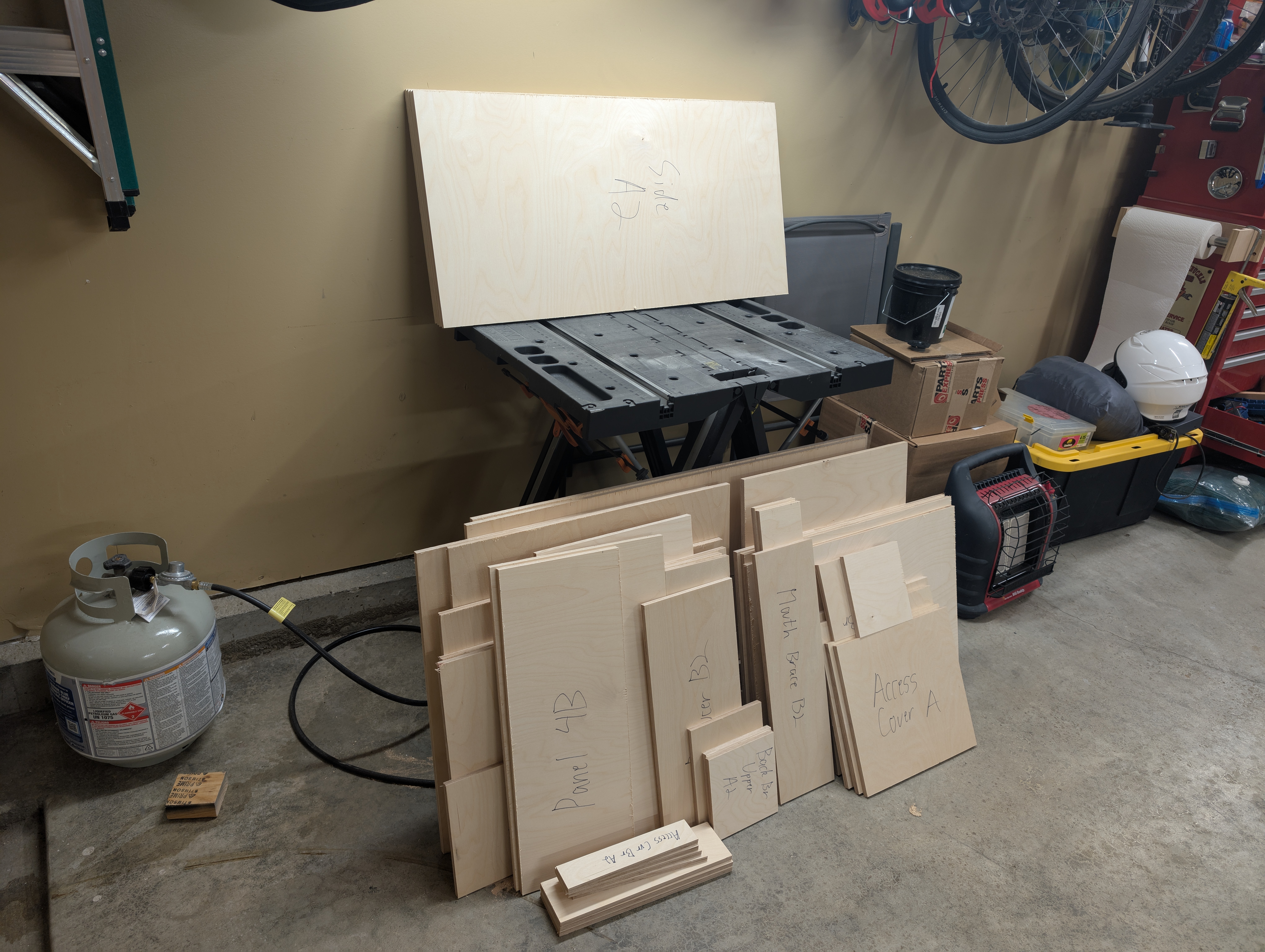

Hey y'all. Thought I'd toss up a thread to track the progress of the new T39s I'm building for a local ballroom. I'm not very far into the process but will add images and such as I go.
I opted for the Lab 12 because these will be stationary and not moved much or at all. So weight really isn't a concern.

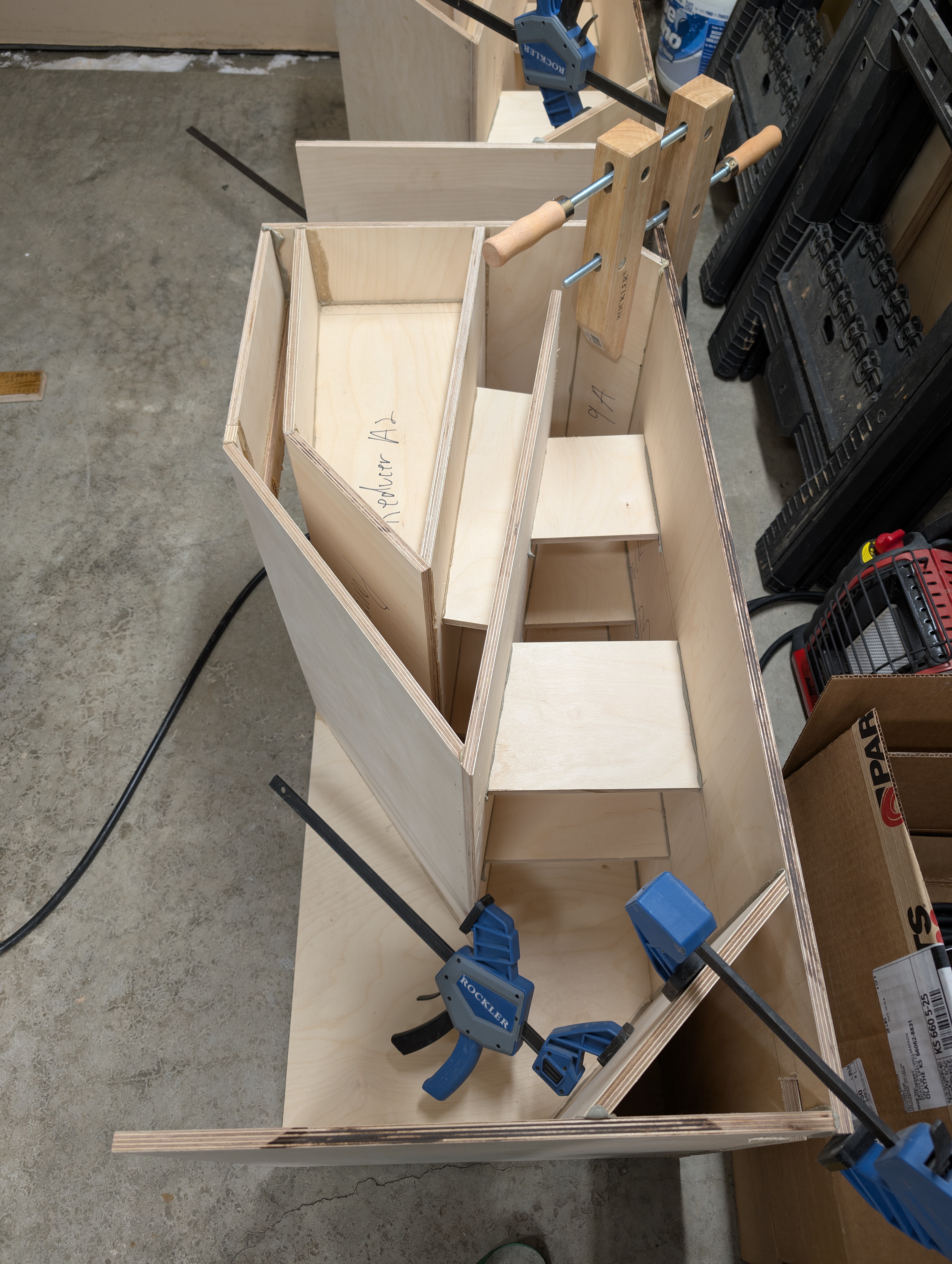

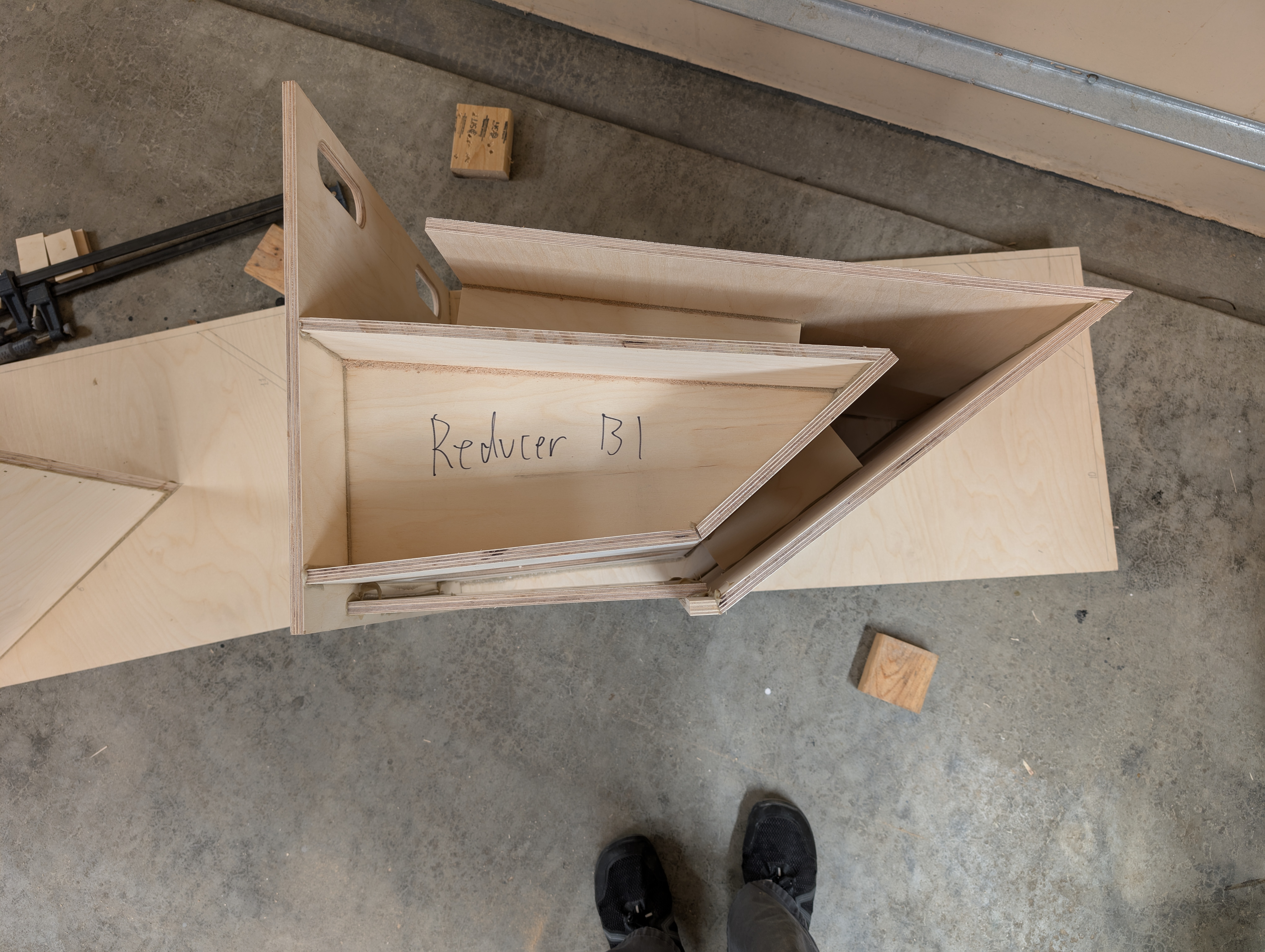

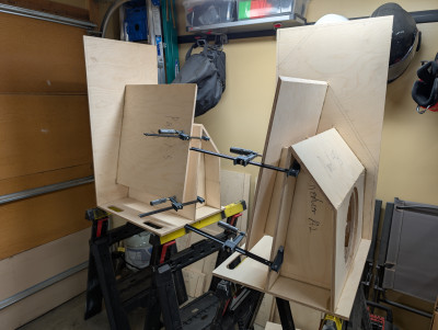

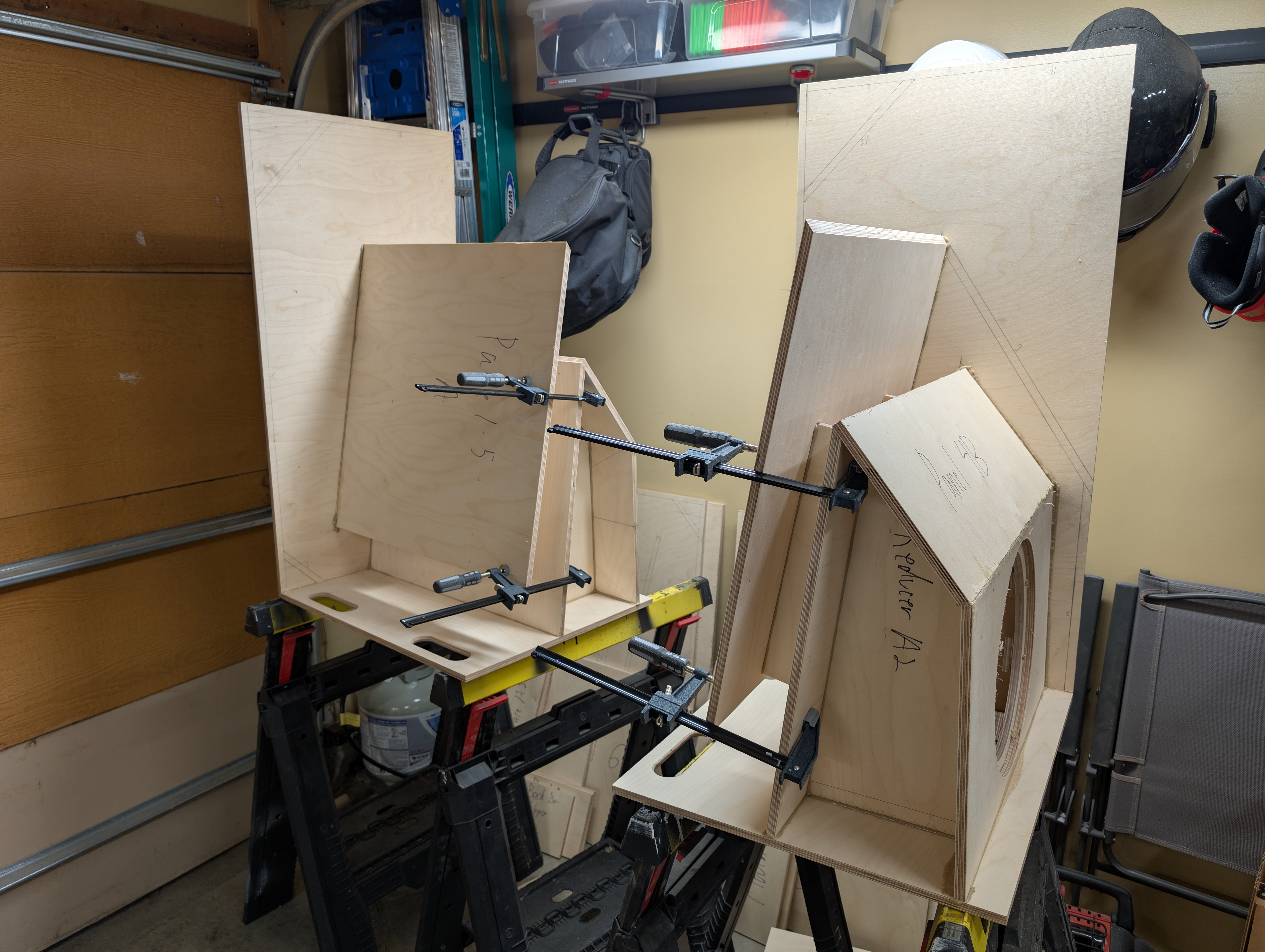

Got the baffles and reducers installed along with panels 3 and 4. The straps are there to help correct a little bit of warping that occurred. So far so good.

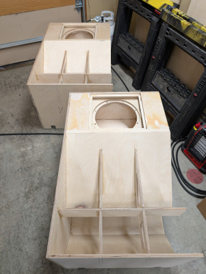

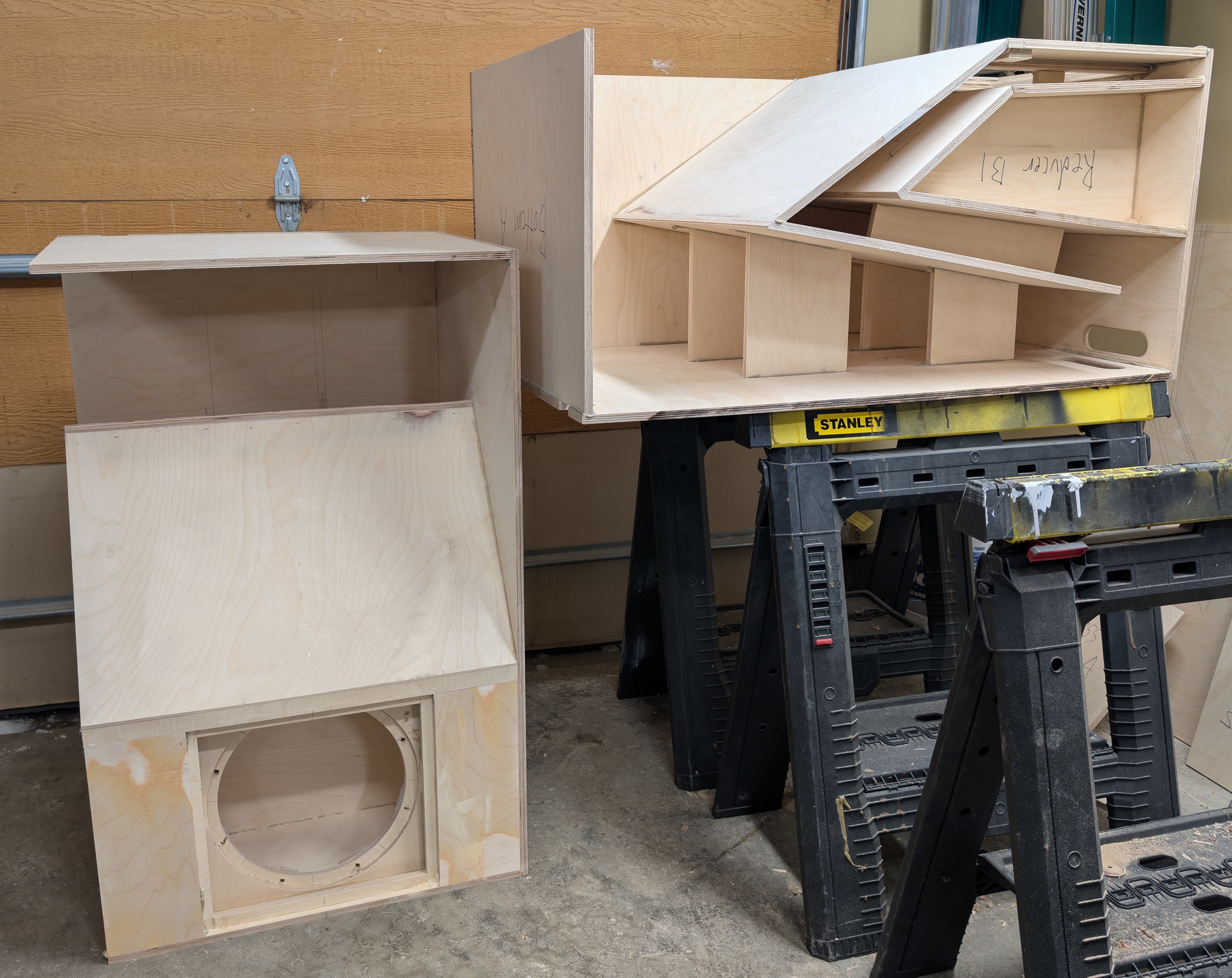

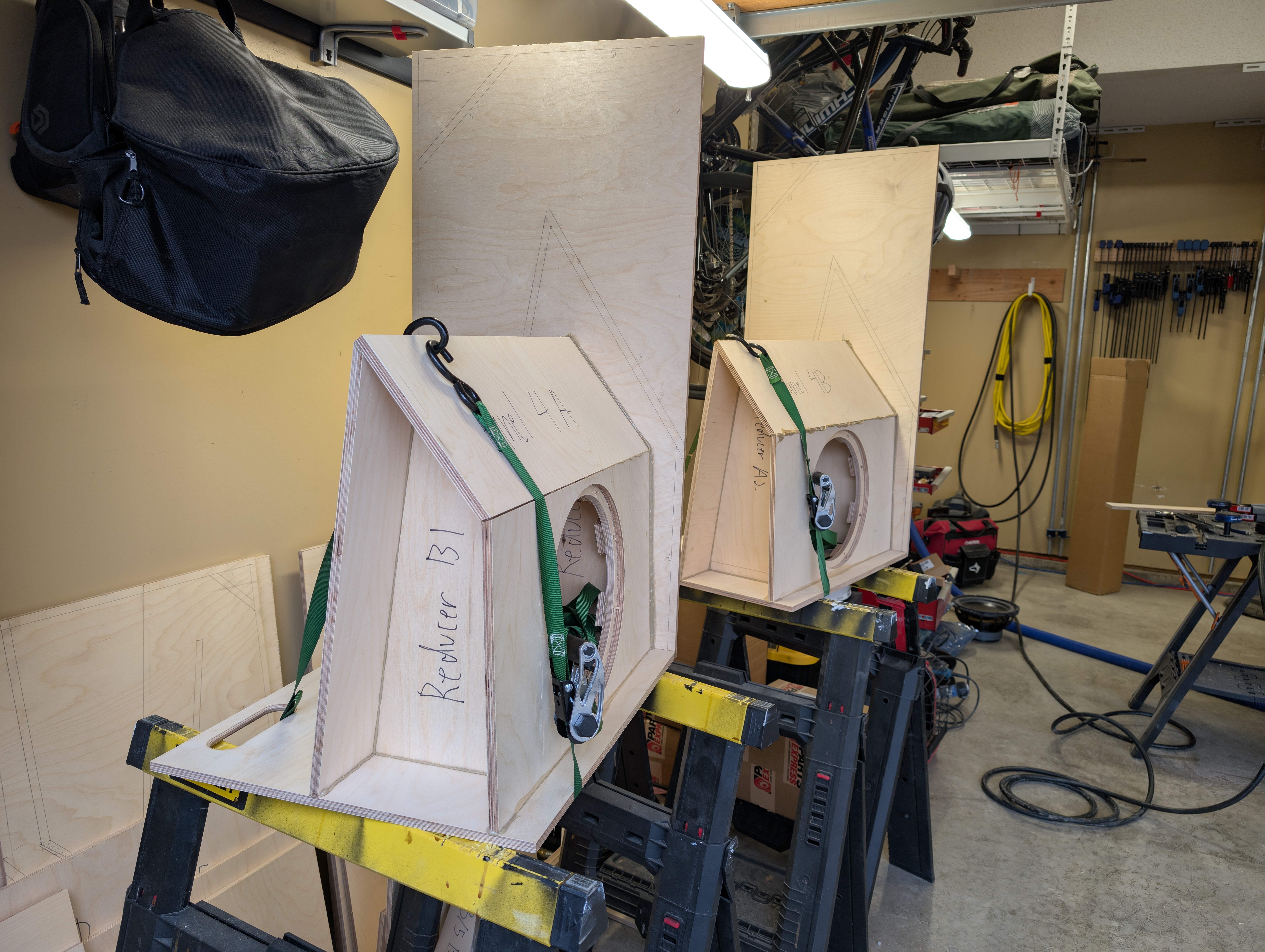

More progress! Panels 5 & 6 and the P6 extension is installed and the driver cover flanges are in place. The braces for the flanges are not installed yet. The cabs are starting to look like something!
They're not perfect, but they should be solid once done.

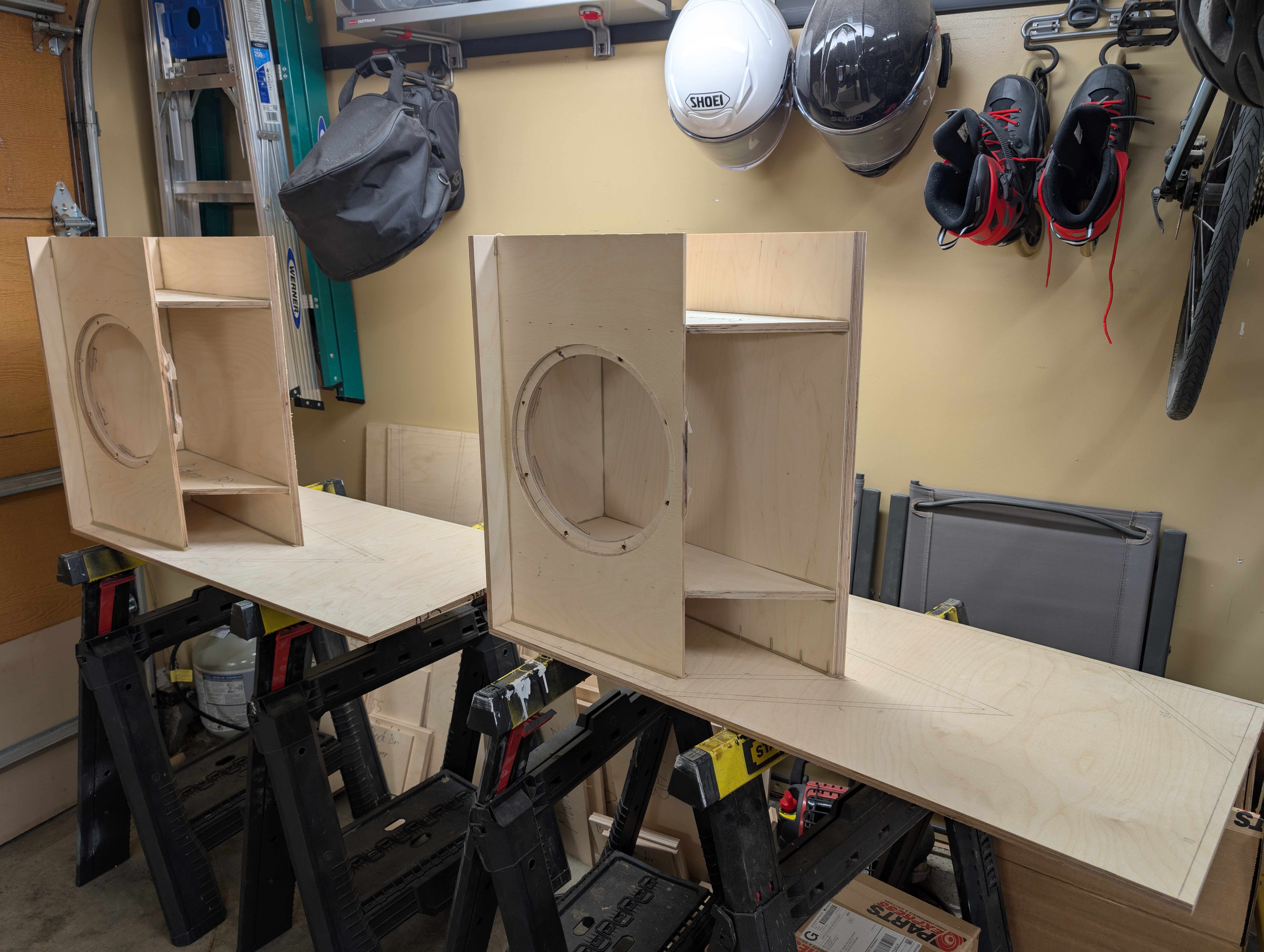

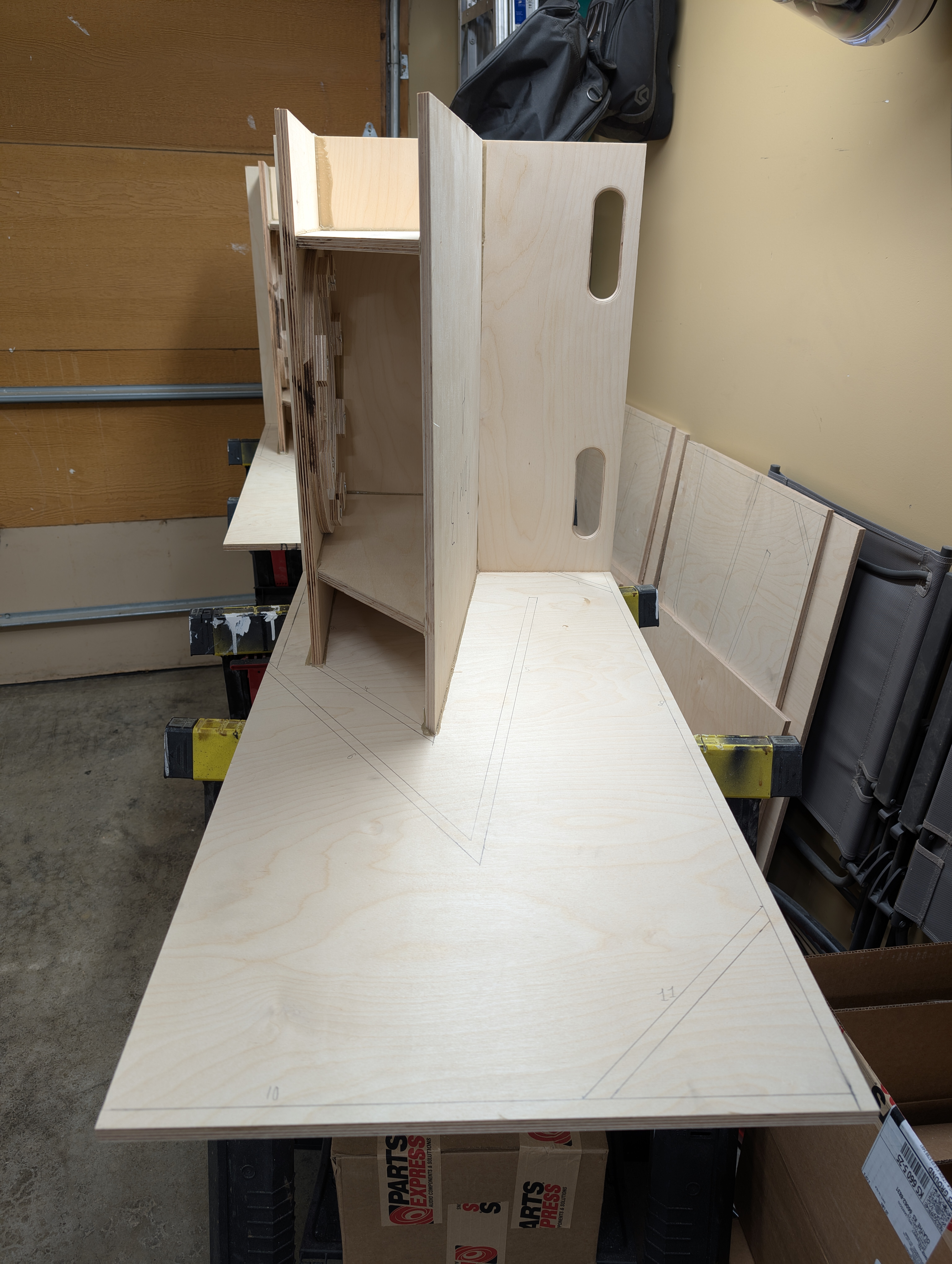

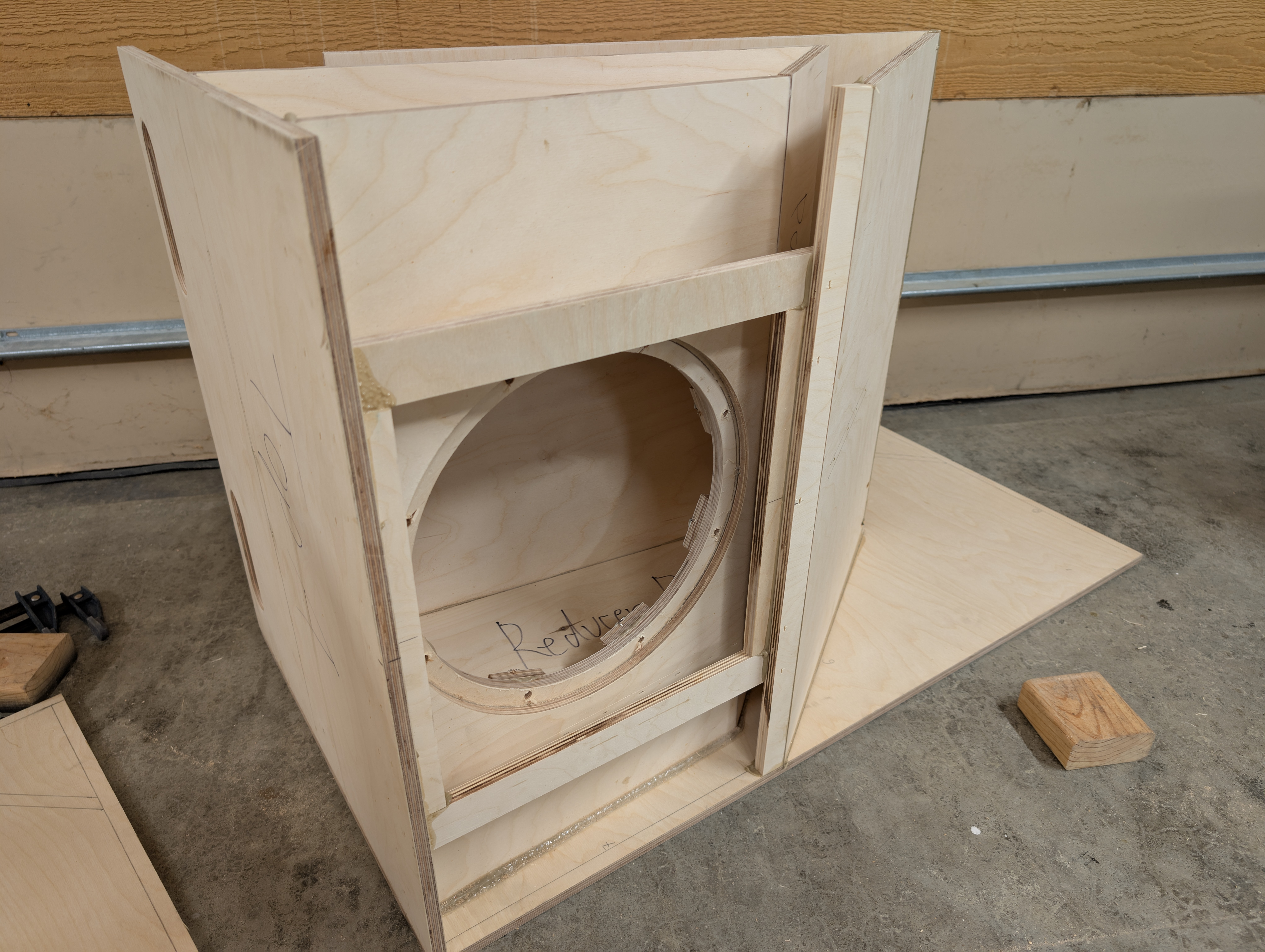

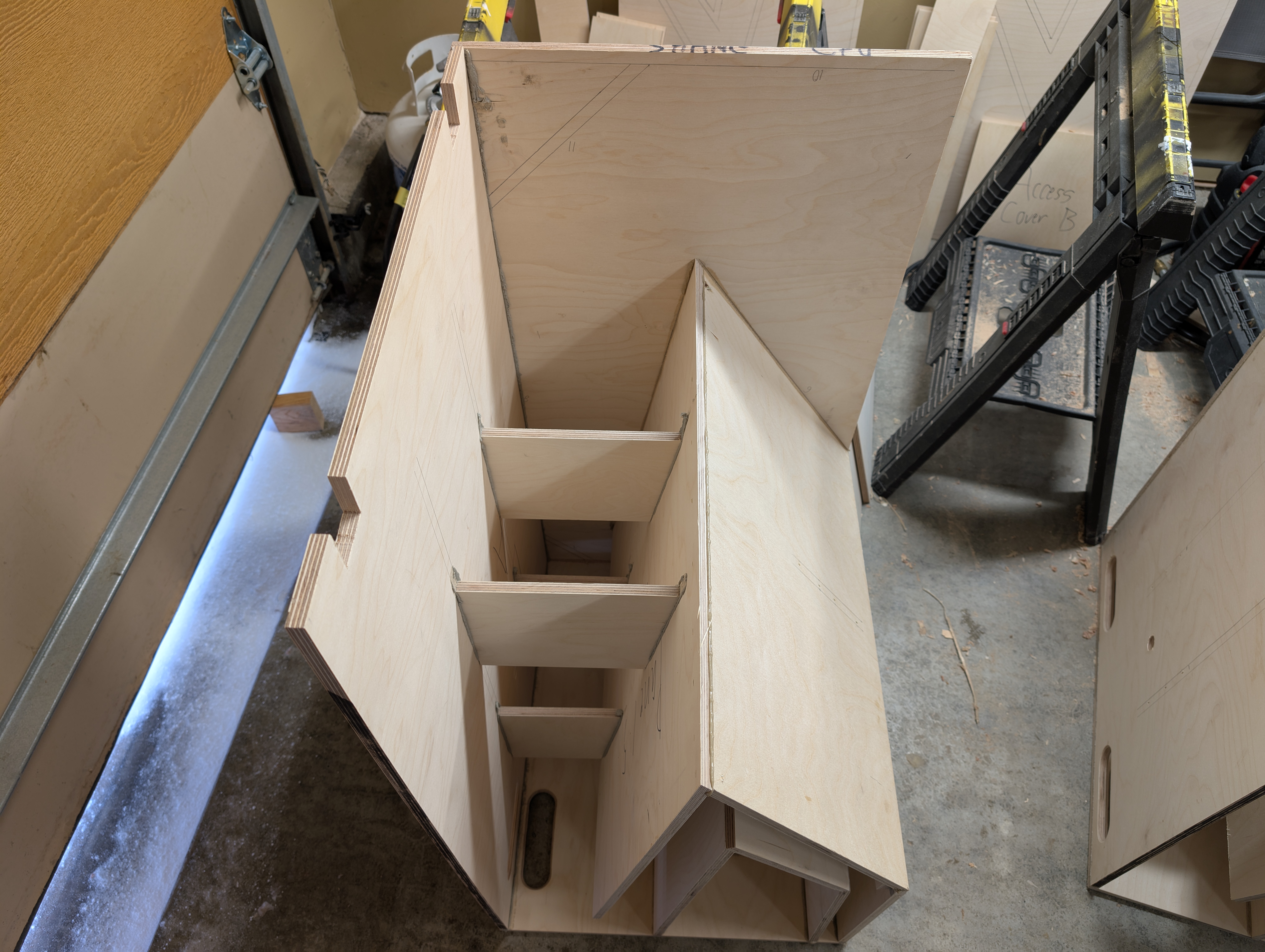

Got more done on the T39s. Got all panels except the second side installed. I have the horn mouth braces cut out (not pictured) and mocked up now. Need to file and router them, then I can permanently attach them. Now is the time to thoroughly check for and seal up any leaks before the second side goes on so will be doing that as well. But the construction is almost complete! :hyper:

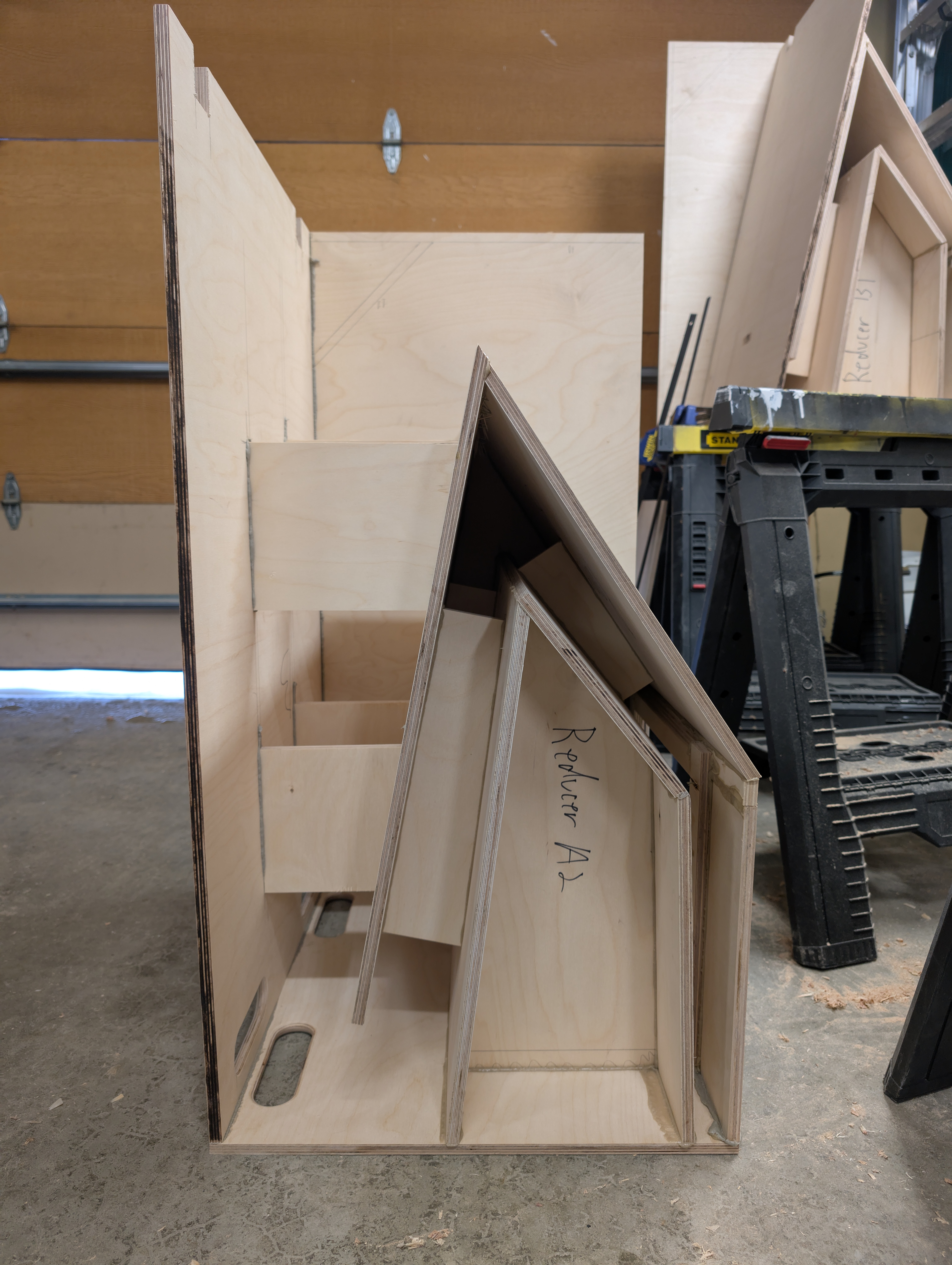

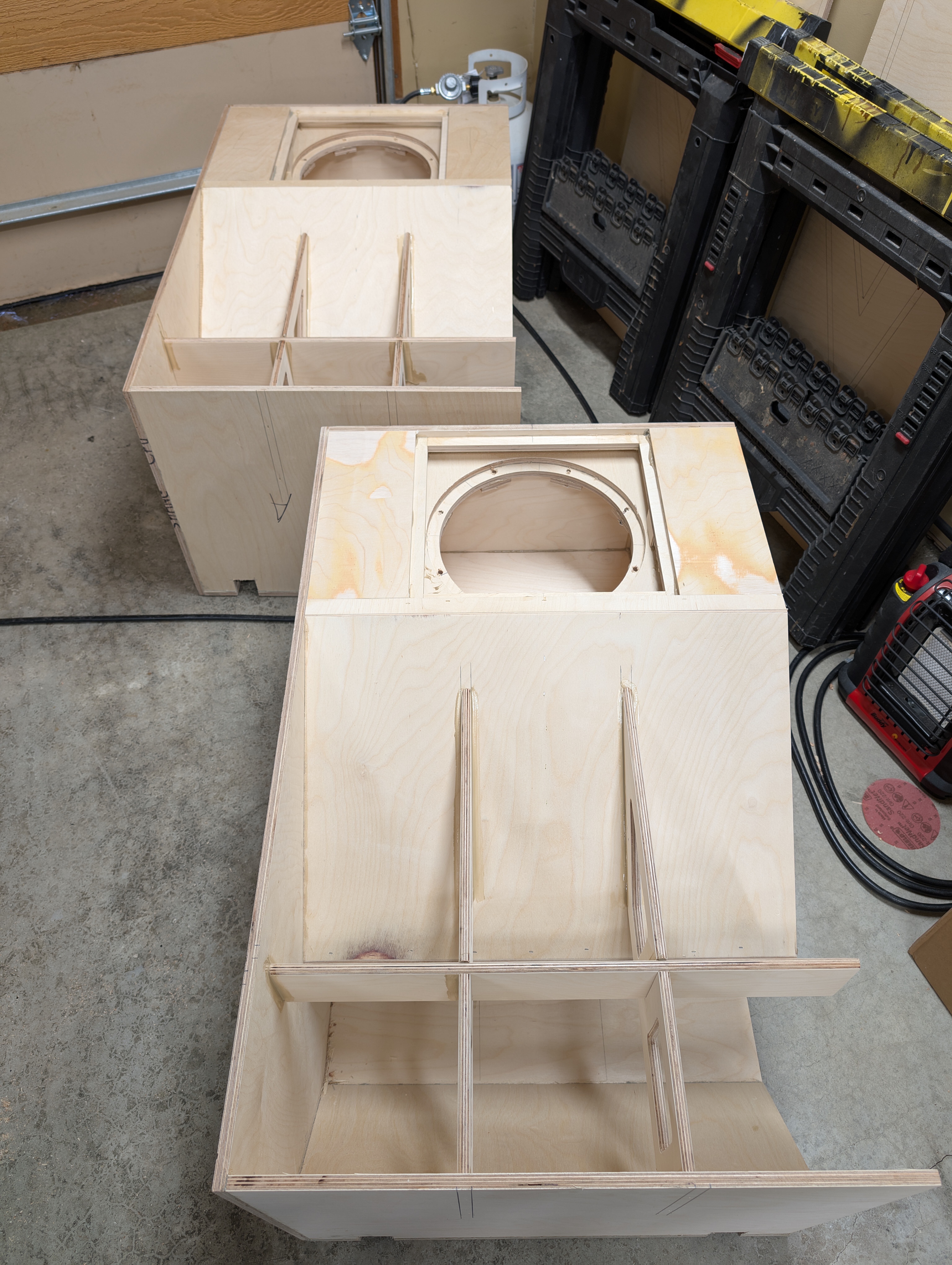

Mouth braces installed!
Also went through all the glue joints and added more PL wherever needed to prevent leaks. There were only a couple spots. Squeeze out looks good everywhere else inside the cab.
