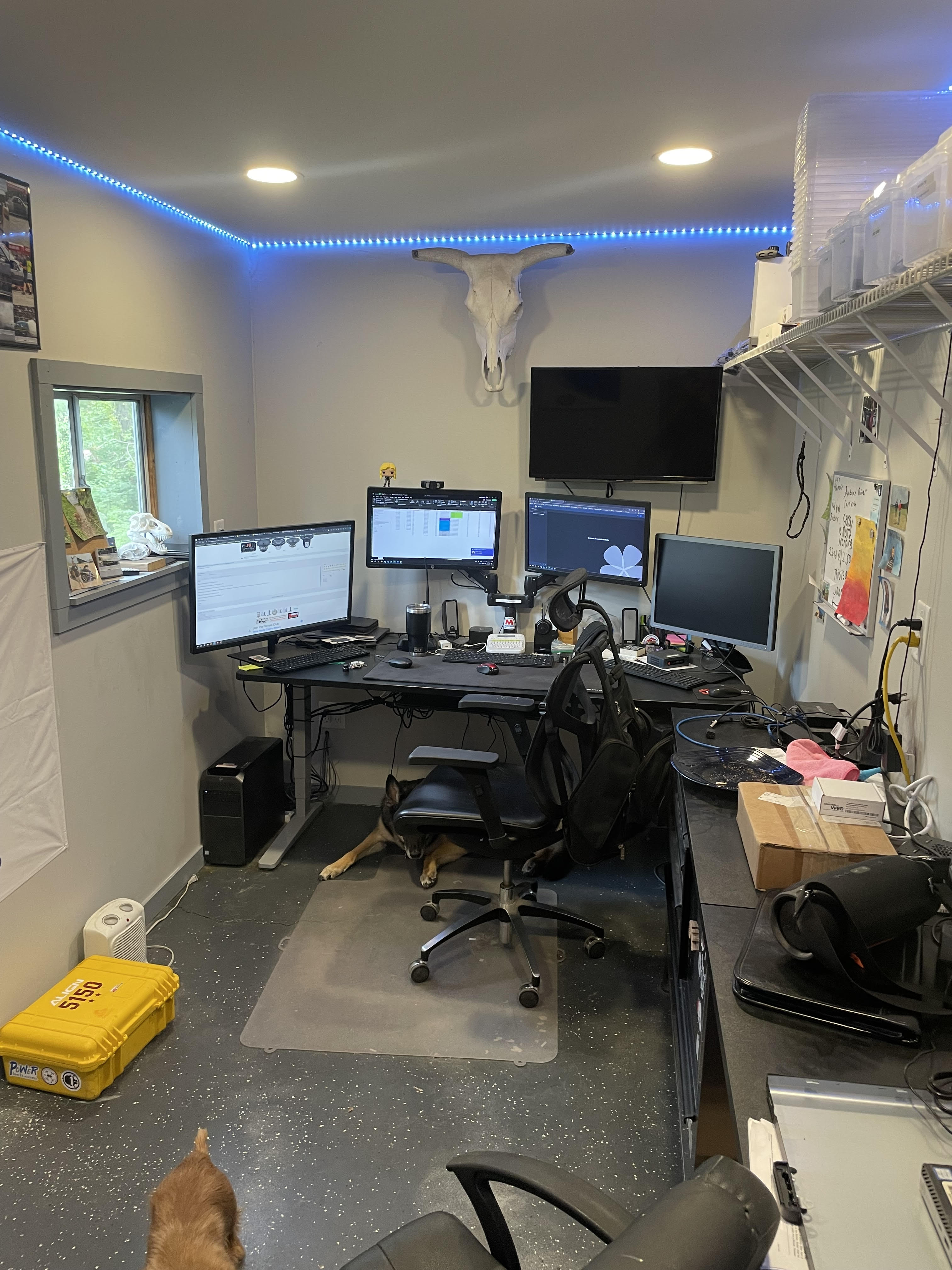

Re: Bookshelf speakers
I use a Truck Tuba in my office under a corner facing desk/work counter like a kick panel. You don't notice it unless it is pointed out. Sounds great with my old pair of KRK 7000s. If I was building something new, I would maybe do the 3" small SLA's. I'm not sure if Bill was referring to the standard ones or the small ones, but both would work great, I would imagine.I also use 6 driver SLA's in my main system, and they always sound great.
