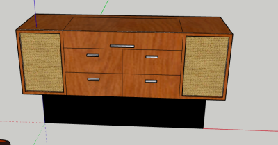

I realize that placing the sub directly under the mains might not be the best place, but I have to keep the wife happy and I need a small footprint for all of it. Here is a screenshot to give you a better idea. The TTLS will have an 8" driver in a 14" high build.

Just a thought though, if the mouth was on an end and not firing to the rear, it would give you the option to push the console all the way up against a wall if the need/want ever arose. In your rendering/picture, is the black base the TTLS, or is it planned to go elsewhere in the design?
I think having the mouth 6" off the wall should be fine. Bill, is 6" sufficient?
