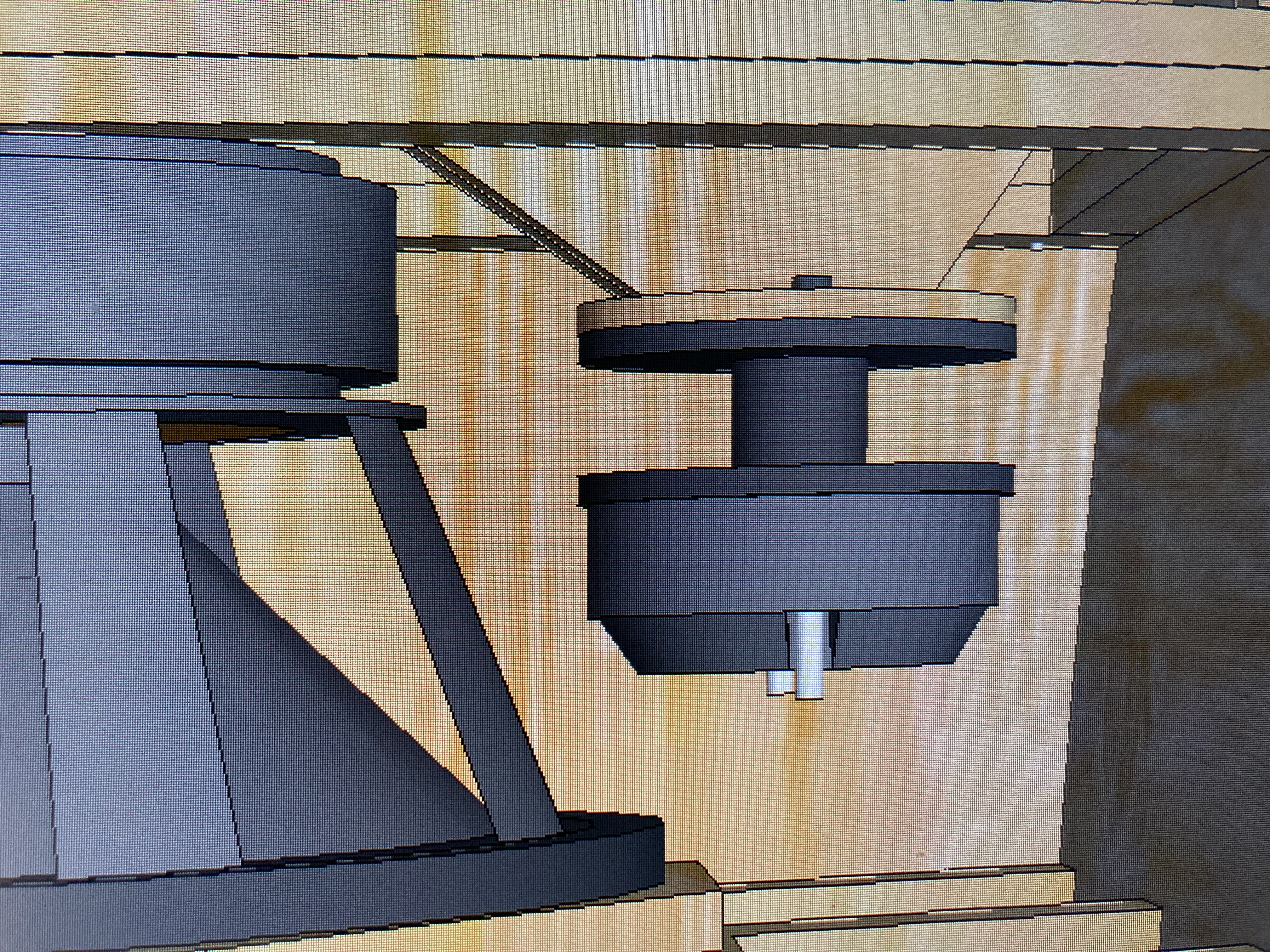

But, then I had a look at the Sketchup file, and I started playing around with the ruler tool...
The Sketchup:
I'm not sure which driver is modeled in the Sketchup file. It seems like it might be the NSD2005. Anyway, the driver modeled in the file measures 4" in diameter, and 1.75" deep. That depth measurement is for the body of the driver, so it doesn't include the white wire terminals. Those might stick out another 1/4" or so. But since they wouldn't hit anything anyway, I'm ignoring them.
I measured a conservative 1 and 11/32" gap all the way around that driver. I say conservative because I looked for the smallest clearance between the upper edge of the compression driver and the lower edge of the woofer frame. To actually measure it, I used parallel imaginary lines to extend these surfaces, and found the perpendicular distance between those lines. I hope that makes sense.
There also seems to be plenty of space between the diagonal woofer frame struts and the compression driver, so I don't think there would be anything to worry about there. I didn't actually measure it, only eyeballed it.
In theory, 1 and 11/32" clearance all the way around the driver in the model should let a guy squeak a PSD2002 in there, yes? (The PSD2002 would only take up 5/8" of that 1 and 11/32" clearance, leaving 23/32".)
If yes, then the next thing would be to reinforce the wooden driver mount to handle all the extra weight. Use thicker plywood for the circular mount piece, more triangular bracing pieces between the mount and the module, etc. Maybe we'd even need to reinforce the horn sides and reflectors? Or use thicker plywood there as well? I don't know.
The bottom line is, if there if enough clearance, and enough extra bracing, the PSD2002 just might work, right?
Or, at the very least, the PSD2002 might be worth testing in the real world? Not just in Sketchup?
Unless there is another factor(s) that I'm missing?
Thoughts?
The Sketchup:
Thoughts?

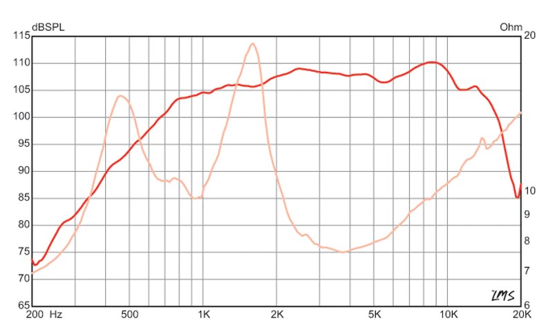

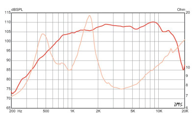

Also, I guess I'm confused. Well, obviously I'm confused.
The spec sheet says the usable frequency range is 1200Hz-20kHz.
But then there's the chart. From what I can tell, it shows ample output below 1200 Hz.
Huh?
Huh?

Re: Will an Eminence PSD2002 Driver work in a DR280?
From the Eminence website:
Usable frequency range
This is the frequency range for which Eminence feels the transducer will prove useful. Manufacturers use different techniques for determining Usable Frequency Range. Most methods are recognized as acceptable in the industry, but can arrive at different results. Technically, many loudspeakers are used to produce frequencies in ranges where they would theoretically be of little use. As frequencies increase, the off-axis coverage of a transducer decreases relative to its diameter. At a certain point, the coverage becomes beamy or narrow like the beam of a flashlight. If you've ever stood in front of a guitar amplifier or speaker cabinet, then moved slightly to one side or the other and noticed a different sound, you have experienced this phenomenon and are now aware of why it occurs. Clearly, most two-way enclosures ignore the theory and still perform quite well. The same is true for many guitar amplifiers, but it is useful to know at what point you can expect a compromise in coverage.
So, even though there is output below 1200 Hz, it could be beamy.
But aren't the DR280s two-way enclosures?
So, it might still sound good below 1200 Hz, but there would be increasing compromises in coverage? And the compromises would become increasingly noticeable the further down you go? Beamier and beamier on the way down... But as long as you're in the beam, the sound quality is still good?

If the hypothesis is correct, that the main reason for the changes in the plans was driver availability, then that leads me to the big question that will determine which fork in the road we take...
Assuming sound quality is the first priority...
Is a 1kHz crossover noticeably better than 1.2kHz for a larger outdoor system of DR280s paired with T60s playing mostly recorded EDM? Certainly it must be audible versus a 2.0kHz crossover, yes? What do you guys think?
And don't worry, thanks to Bruce we have a backup plan of ASD1001s! We are just thinking on how to get the fastest race car we can before our plywood arrives and we commit to cutting.

If it was I'd have done whatever was required to cross at 1kHz.
Rule #1: Follow the plans.
Rule #2: Follow the plans.
Rule #3: Never break rules #1 or #2.
There are many drivers that have the required specs. This is one of them: https://www.parts-express.com/LaVoce-DN ... quantity=1
