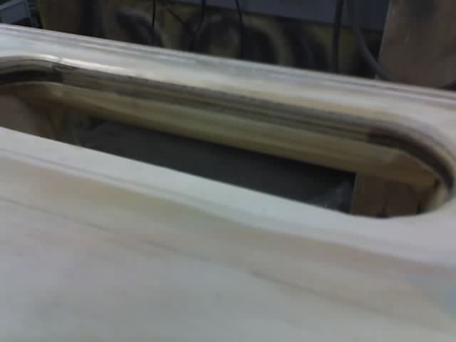

hey guys, do the stock cut in handles on the titans bother anyone? i put a piece of quarter round moulding inside mine and that made them feel much nicer. spaced the handles off the edge so the quarteround edge just met the edge of the handle cut out. very easy inexpensive mod and with the quarter round glued it also adds strength to the handles. allows for the handles to be closer to the corner so it's more comfortable. (to me at least.)
crappy pic

Good idea! I filled mine with body filler to ease the grip but 1/4 round seems like a good approach. :)
