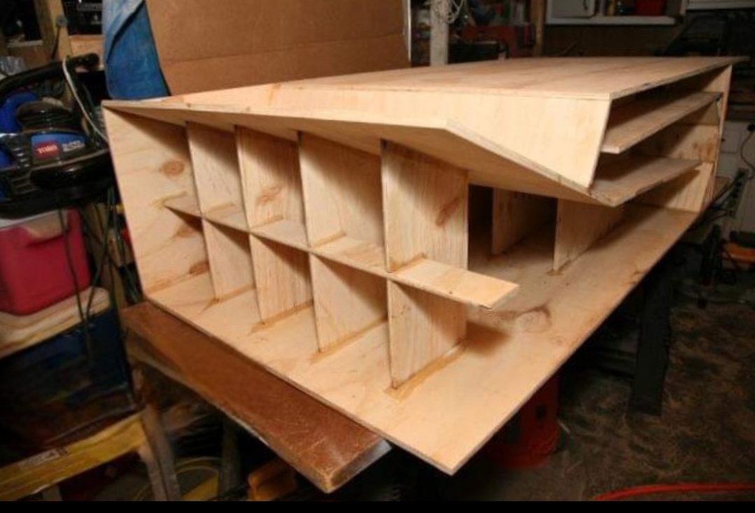

I am building a TubaHT Low Profile in 36" width. In the build instructions, it says that you can use 3 sets of braces for enclosures that are wider than 25", but not to exceed 8" in between braces.
A 36" wide enclosure with three sets of braces would have them spaced apart 8.375" (more than 8").
A 36" wide enclosure with four sets of braces would have them spaced apart 6.6".
Which would you choose, three or four sets? I've seen both used in photos online.

I would personally choose four between panels 9 & 4, three between panels 4 & 7, four between panels 7 & 1, and flip a coin for mouth braces. Heads three, tails four.
By the looks of the photo, it's a little too late to ask, isn't it? Or, is that not yours? Looking pretty good either way :thumbsup:

That is a photo that I found online. My panels are all cut, and I'm a couple of days away from starting assembly.
I had a similar thought as your suggestion. I appreciate your input.
