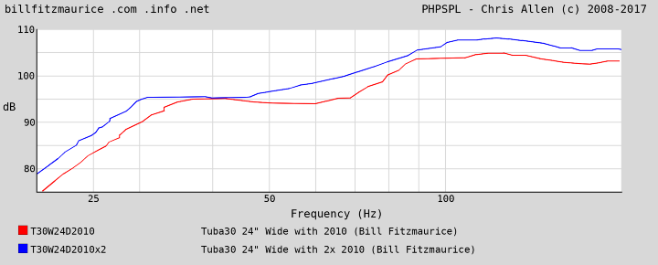

Rich4349 wrote: Mon Nov 27, 2023 11:01 pm There's something odd to the two graphs around 40-45hz.
There aren't too many dual loaded SPL charts in the forum chart tool, but this one with single and dual loaded T30's shows the same thing you're talking about. It seems to be due to a 2x cab having the response of two cabs of half the width, which don't have as much cab working for them, per driver. I know it's confusing and stretches' the mind to make sense, I had the exact same inquiry a couple years ago.
