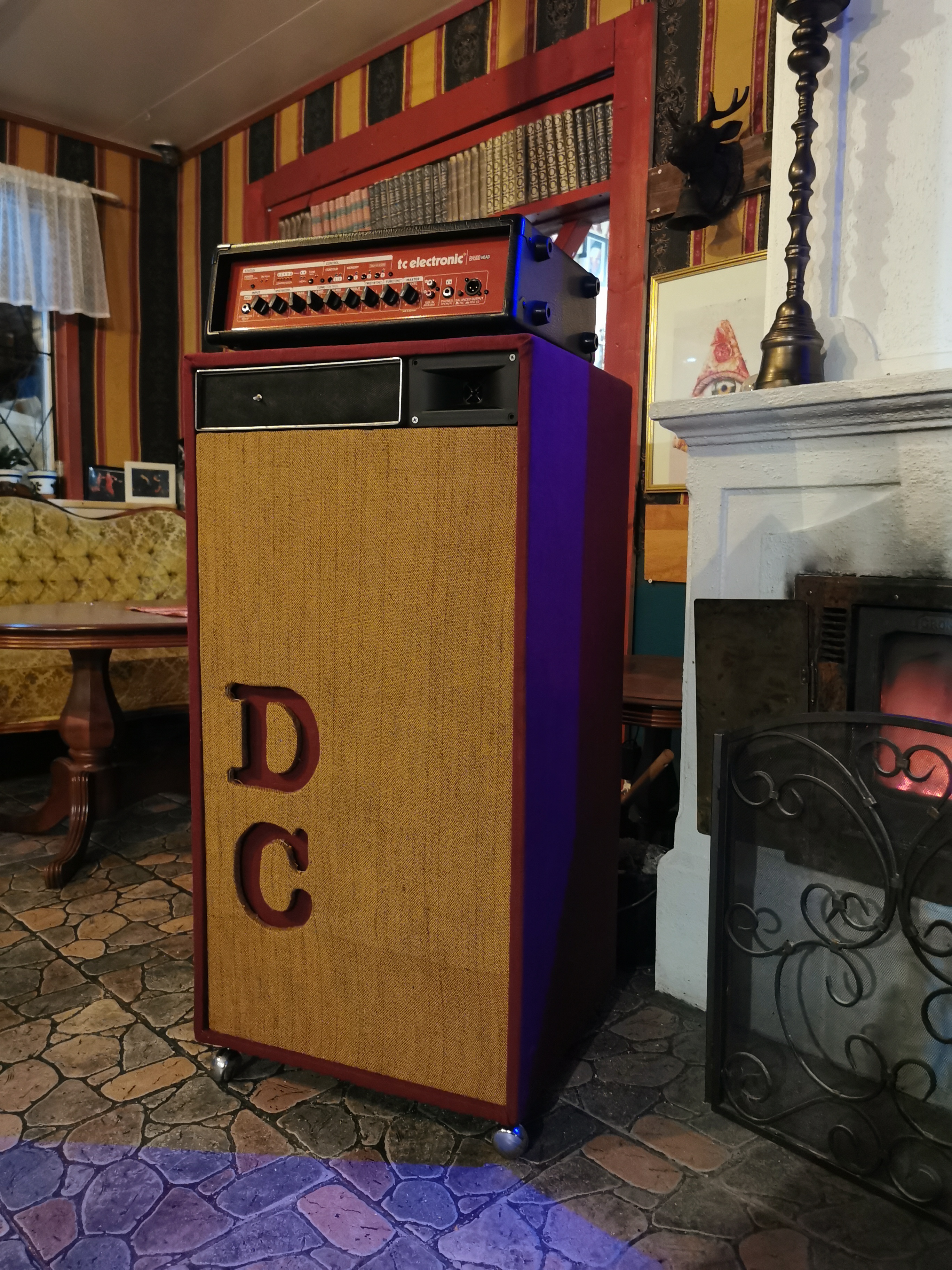

Hi, i've built the OT15 TallBoy. The goal was to make a cabinet to give away to a music store as a secret christmas gift. Last weekend we had a band playing and they needed a basscab so during soundcheck i ran to get the half-ready build and finished the last screws on the back plate, no top section, just a 15".
After the gig, the bassplayer who at first seemed worried to play at a ply-finished, not ready cab came and asked about it since "it might be the best cabinet i've ever played".
So.. Now i want to build another.

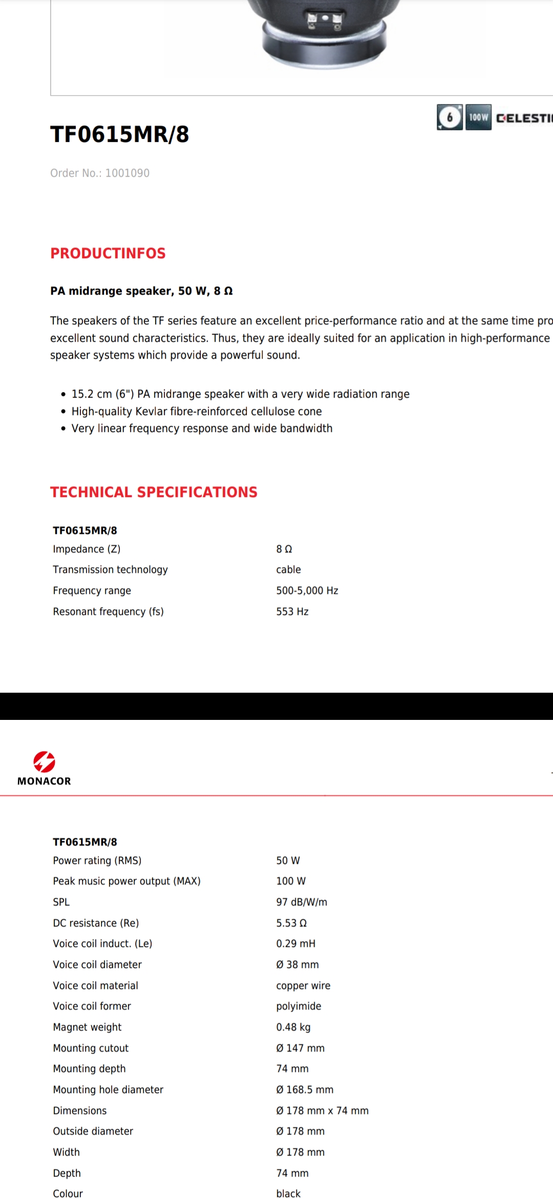

But for the existing one i want to put a top section that is possible to turn off and I want a mid driver that is easier to get a hold off here and my questions, since i'm not putting the cbmra in this one (due to time, budget and availability) are:
What are the most important thiele in closed back alternative drivers?
Fs?
Qts?
Vas?
Power handling?
How bad is it to close an open one, maybe calculating the box and what to think of then. (plans says must use a closed back, i know)
Are there other elements, maybe from eminence aswell, since its out of stock here.
Thanks! The build is super Even when not done yet!

Fs is the only spec to be concerned with in a closed back. I can't recommend anything not knowing where 'here' is, you should add it to your profile. I assume it's not the US, as the CBMRA is plentiful here.
Re: Ot15tb drivers
Thank you Bill.Bill Fitzmaurice wrote: โMon Nov 06, 2023 10:12 pm Fs is the only spec to be concerned with in a closed back. I can't recommend anything not knowing where 'here' is, you should add it to your profile. I assume it's not the US, as the CBMRA is plentiful here.
Is there a frequency range you could name to stay within? The cbmra will be my guture option when It's available for my own box. It can be found here (sweden) but at a way too high price whre its not out of order and it'll probably be a larger order from the US when i'll build more cabs. It's also discontinued in the larger shops.
Would it be better to close the back of one and have it tuned to a close fs of the cbrma than buying a closed back with an fs far from the spec?
Lower is preferable to higher than the cbrma?

It's not possible to duplicate a closed back with an open back, you can't make the chamber small enough. There are other driver options. Here's two:

I see. I tried since i had one at home before i read this. Got it down to under 0.1 litres in an angled frame, filled the remaining millimeters with foam-tape. It sounds okay but low in the response. It was a 6 ohm so I modified the x-over to the middle of the parameters between 4 and 8 ohms.
I found a closed back but 4 ohms, is the response going to be higher then?
Modifying the x-over in the same ways as the dual 8 in the bass section? Should i keep searching for an 8 ohm instead? Will double check if i find the ones u sent on the sites here,

4 ohms would require a complete redo of the bandpass filter, and it will have 3dB higher voltage sensitivity.

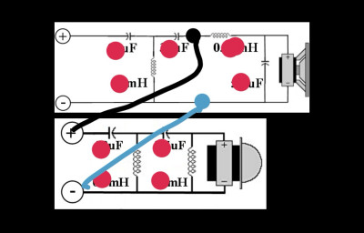

As an electric bass-cab, run it like a three-way aswell? The Speakon plate have an on-off option so i will be able to chosse, just havnt seen a 3-way basscab

Correct on the filters. I wouldn't use a tweeter on a bass cab that has a midrange.
Re: Ot15tb drivers
Can i connect the tweeter crossover after the high pass section in the bandpass crossover? Ergo, taking the signal before the 0.45 mh/5.6 CAP to the tweeter? Would they interfere with each other?Bill Fitzmaurice wrote: โWed Nov 08, 2023 9:46 pm Correct on the filters. I wouldn't use a tweeter on a bass cab that has a midrange.
In that case i could put a double switch there that either gives signal to the tweeter section and The low pass on the mid, or it omits the tweeter and The low pass of the mid sending full high passed signal to the midrange..
Or, if the bass has a rolloff, would it be possible to run it full and keep the tweeter on for the highs as other basscabs, excluding the mid and have a tweeter with it for the top top section (with a pot if the high frequencies are much louder than the rolloff) ?

I guess this is like the celestion?
Edit: i saw now that celestion and Monacor is the same.

Maybe and odd question, but this is how i mean, puttning a double switch but i guess It might be faulty. I cant take + and - to the tweeter from after the high pass section of the mid, it would interfere with the tweeter high pass? As in the picture.Bill Fitzmaurice wrote: โWed Nov 08, 2023 9:46 pm Correct on the filters. I wouldn't use a tweeter on a bass cab that has a midrange.
Otherwise,
Is it enough to break the - side of the filter to turn off the driver or/and The + side?

Don't do that. If you see the need to attenuate the tweeter use an LPad.
Re: Ot15tb drivers
Ah, i see. I wanted to be able to switch between 2-way and 3-way, thats why:) i used a premade circuit board for the mid so i can turn off the highs, i'll simpky put a switch on the tweeter aswell then to turn that off when running 2-way. Then i have a cab that can be used fullrange with the 15" only for el. Bass, 3-way for pa and 2-way for el. Bass with extended mid/high where the mid plays all the way up. Fun! Thank you!Bill Fitzmaurice wrote: โWed Nov 15, 2023 9:07 am Don't do that. If you see the need to attenuate the tweeter use an LPad.
