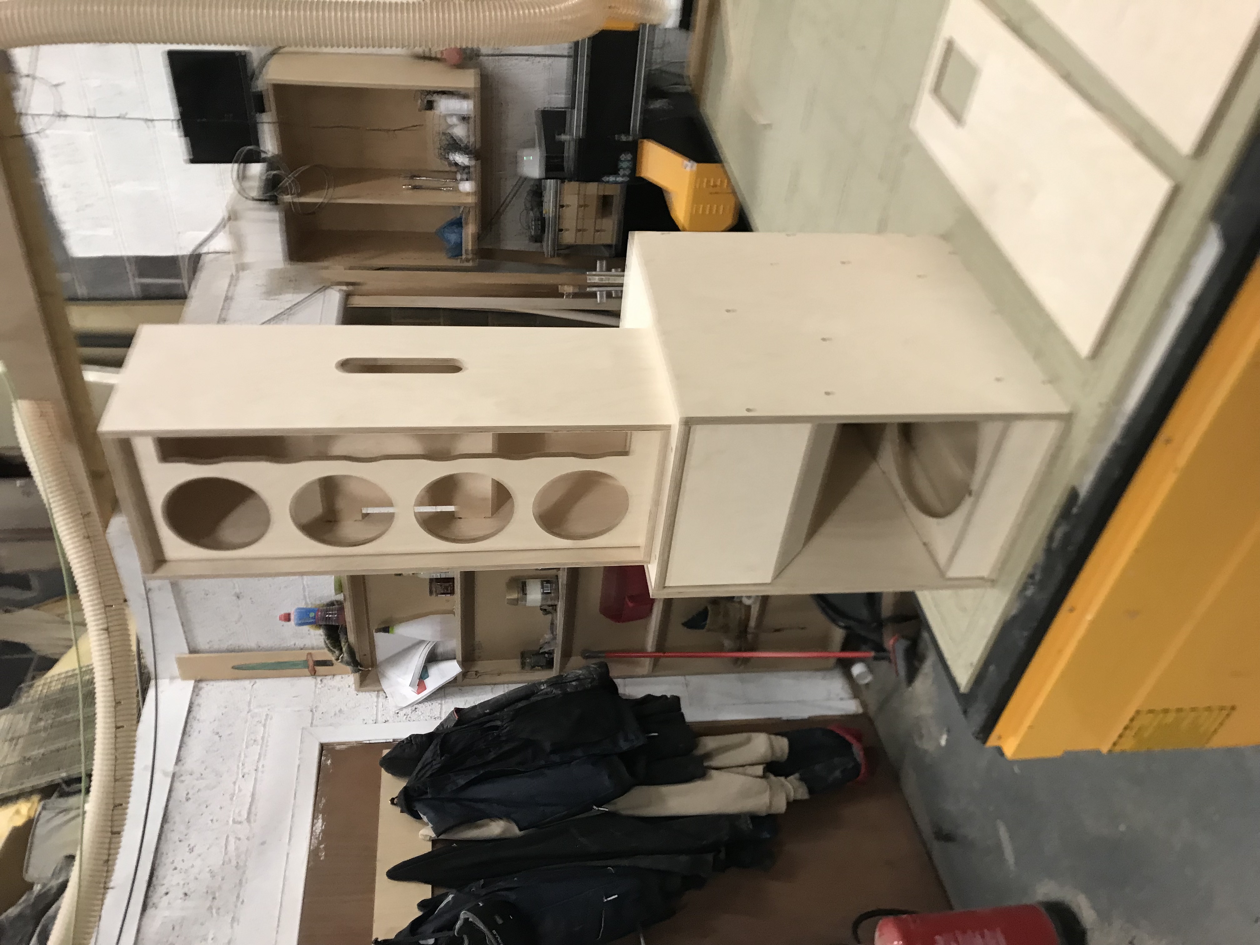

Hey, so in the end I’m building a pair of sla pro’s (against all of your good advice ha ha). Light and portable won over efficiency and volume. Time will tell if that was a good decision or not.
Progress is slow but I’m getting there, I’ll stick some pics at the end.
My question is about drivers. In the plans it says eminence alpha 6. When I came to buy them from blue Aran (uk) I had the option between 4ohm and 8ohm versions. I went for 8 ohm cause more is more right? Now I wonder if that was actually correct.
Which version should I have bought, and if I got the wrong ones is there a workaround? I’m post sure it’s too late to return them.

Oops sorry that photo went in sideways!
Re: SLA Pro 4x6 effiency and suitability for 12v system
8Ω drivers is what the plans are written for and the values of the crossover components are designed for. You made the right choice.
Build quality is looking good
Honestly, the SLA's may not require too much power to keep up with your subwoofer selection. You should be fairly happy with the results. If it turns out you require more bottom end, we can discuss options at that point.
