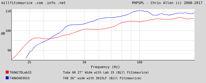

Bill, I'm sure it's a size limitation... would it really be unreasonable large to design a cab that has the extension of a T60 combined with the sensitivity of a T48? How big would that sucker have to be? I'm thinking 6-7 feet long x 30 x 36 and intended to be only used V-plated could still be a manageable package in groups/stacks of 4-6. Would it have to be much larger than that?

It would take thirteen 20" wide single LAB12 loaded T60's, or nine 28" wide single LAB15 loaded T60's, or seven 30" wide double LAB12 loadedT60's to match the output potential of four 36" single 3015LF loaded T48's v-plated at 40Hz. I think the gains would be justified, as long as it could be done in a footprint that's still relatively portable and deployable.
I know you don't, but if you did have the desire to fully utilize the extension of the T60, (transport allowing) wouldn't you rather build nearly half (or less, depending on the configuration) the amount of cabs and buy half the amount of drivers? I'm not at all convinced there's any savings in plywood either. But, a person building something of that magnitude really shouldn't be worried about the cost of ply.

Seth wrote: Wed May 31, 2023 11:06 am It would take... nine 28" wide single LAB15 loaded T60's... to match the output potential of four 36" single 3015LF loaded T48's v-plated at 40Hz.
So to answer your original question, Seth:
Valuing the V-plate as a 4.5th T-48, and from my memory (lol) that Titan's are 2x as loud as Tubas, it would basically be a T-60 of double the volume. So double the dimensions and go with max width. So 60x27x120? It would work as a permanent install, and easiest to build in place.

Is there a way to design a horn path that maximizes sensitivity between 30 and 60Hz closer to that of the T48 and also maintain the extension of the T60, without drastically changing the horn length of a T60? Same-ish horn length, larger enclosure with flair rates (if that's not the correct term, forgive me) to increase sensitivity in that region? Would it be possible to do in an 84x30x36 enclosure designed to be deployed in a stack of 4 or more, V-Plated? I wouldn't mind so much, giving up substantial sensitivity over 60HZ if that helped fit everything in the package.
