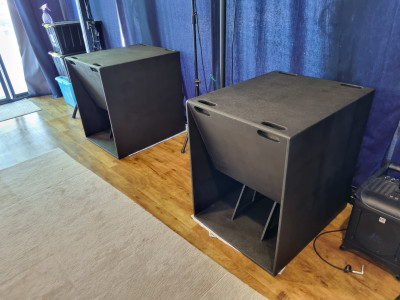

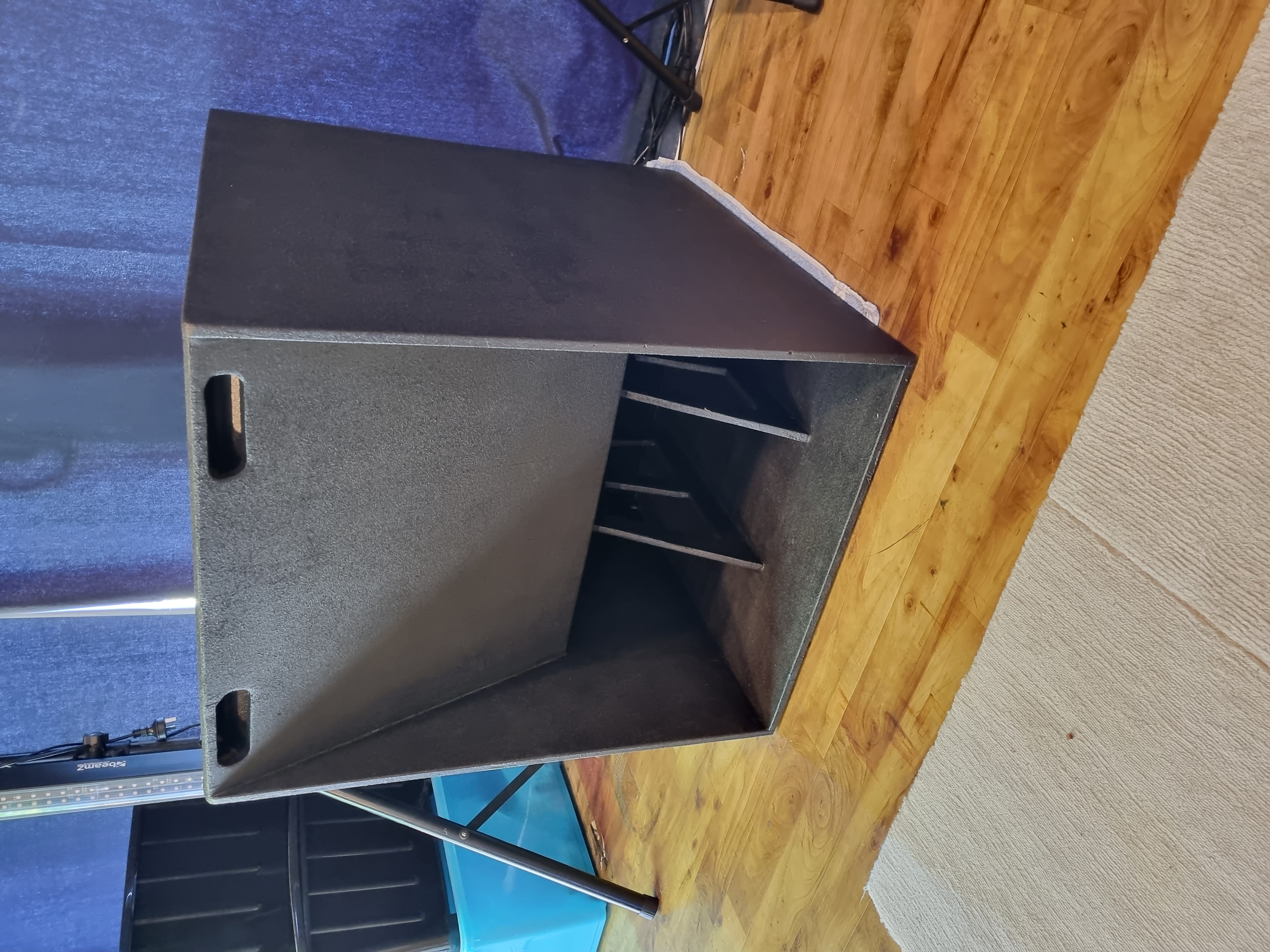

I have also attached some pictures for you

Thank you. The pics aren't for me. They are for anyone else who wants to see what T30's look like. Most people will look through build threads. It may not occur for them to look at a T30/crossover thread.
Having said that, your pics told me something.
They told me that your inclination is to set up aesthetically, not functionally.
To get the best out of your subs, they need to be set up for functionality.
Please read and learn this:
viewtopic.php?t=398
We call it the sub placement sticky.
The reason I recommend this is: your subs have been placed contrary to the prime directive in the sub sticky, so they may be causing cancellations within each other.
Put the subs immediately side by side, and face them at the wall, the mouths about 8 inches from the wall.
You might be quite surprised at the difference.
Just so you know, I'm not picking on you. If someone doesn't tell you you may be doing something incorrectly, you'll never learn.
We all start somewhere...

Unfortunately I cannot face the subs against the "wall" behind them as the "wall" is actually just glass sliding doors with curtains infront![]()

Yes, you may. If you think the doors will rattle more that's not the case, the output pattern of any sub is 360 degrees. Aiming them backwards insures that you won't have boundary reflection cancellations, and it acoustically filters above bandwidth content.Bigrob1234 wrote: ↑Thu Feb 09, 2023 6:23 am Unfortunately I cannot face the subs against the "wall" behind them as the "wall" is actually just glass sliding doors with curtains infront
