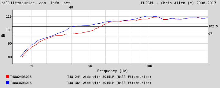

Posted: Wed Nov 02, 2022 8:51 am
by Seth
tribal king wrote: ↑Tue Nov 01, 2022 8:13 pm
...I got a few JBL 2226H subs, looking at the T48 plans it seems they fall within the suggested parameters (Fs=40Hz, Qts=0.31, Xmax=7.6mm), question, does anybody have real world experiences with those transducers in this particular application?
I'm not aware of anyone using that specific driver. However, they are indeed within spec and will absolutely pound in T48's.
That 10dB difference between the CV and T48 at 70Hz indicates to me, if they were both EQ'd to the same target response curve, the T48 would only need about 40 watts to match the output of the CV on 400 watts.
Here's the kicker... the T48 response curve indicated in that graph is for a 24" wide T48. The wider you build the cabs, the more bottom end sensitivity you'll achieve, and you can build T48's as wide as 36". If you're able to stow and transport cabs with those dimensions, it's highly advisable.
Also
The 5.5dB difference between the 24" and 36" T48 at 40Hz is huge. The 36" cab would only require 127 watts to match the output of a 24" cab at 450 watts.
If 36" is just too big, build as wide as you possibly can.
