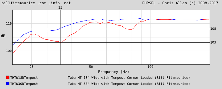

Here's an 18" THT and a 30" THT. The 5db difference at 35Hz means the 18" cab will require 3.2 times the power compared to the 30" cab to create that frequency at any particular volume. If a 30" cab is at 100 watts, the 18" cab would require 320w to match the output.

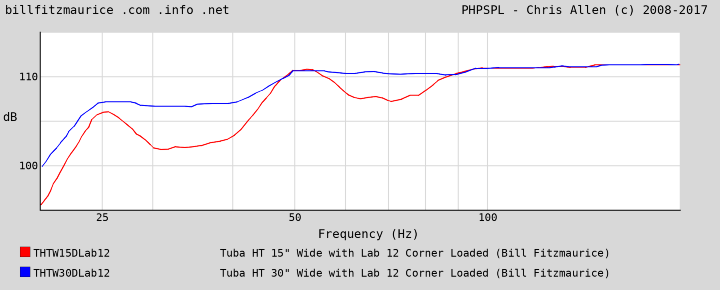

Do you have a similar graph for a 15" (minimal-size) THTLP?
Re: THTLP
Posted: Tue Oct 18, 2022 9:20 pm
by Seth
Here's a 15" and a 30" loaded with LAB12's... not LP's though.
