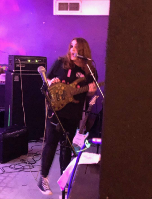

If that's her in the pic, it looks like she's currently using an SVT-810. When I was a kid that's what most bass I knew wanted to upgrade to!
What you build probably depends on what you'd like to achieve and how much work you want to put in it. The simplest cabs to build are the Simplexx... They should be at least as good for better than any commercial cab of equivalent size out there, and are designed as an easy cab to build. To replace an SVT-810, maybe two of the 1x15 bass/keys cabs?
