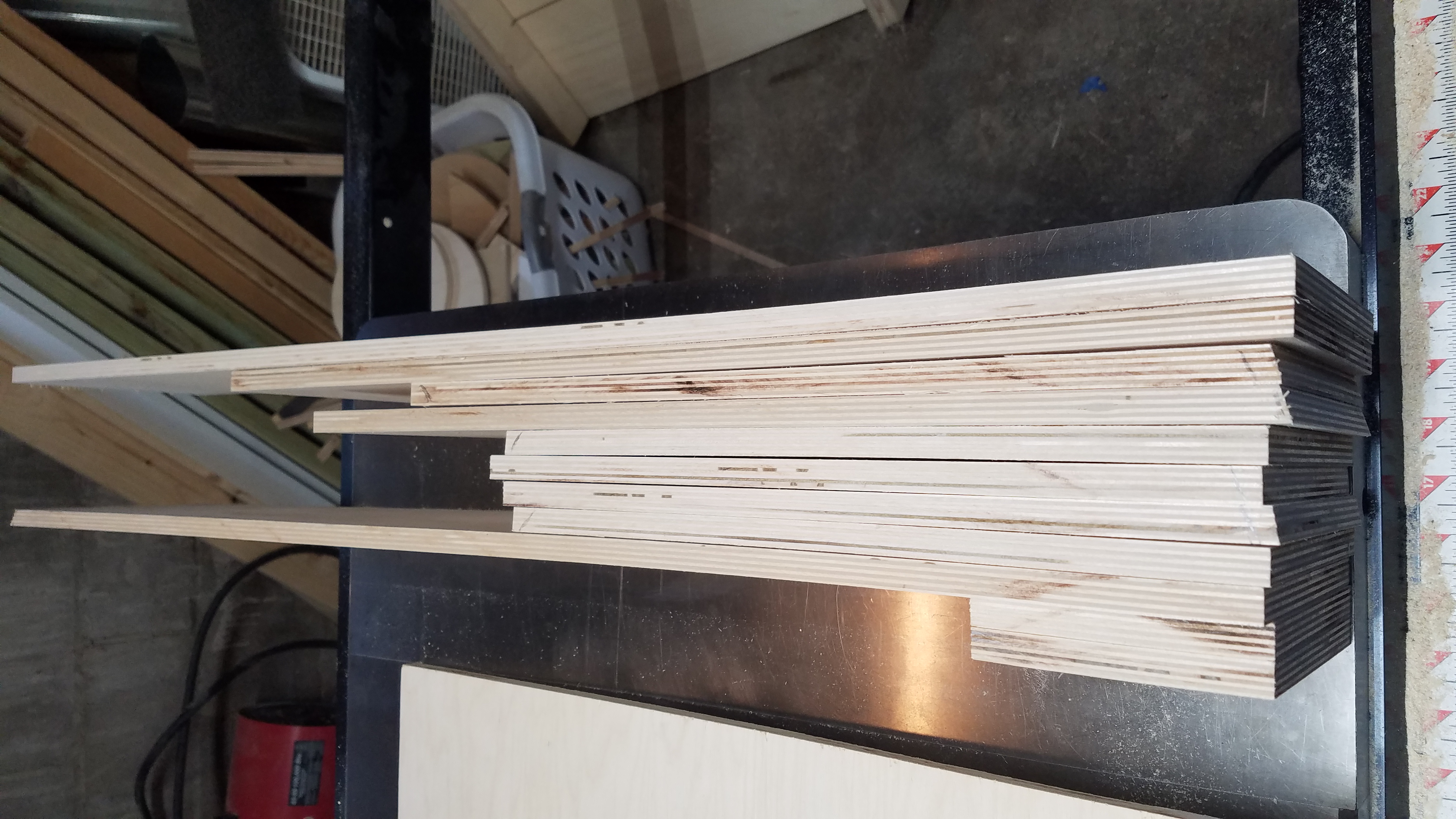

He purchased 3 sheets of 24x30 BB at our local Woodcraft last fall sometime. It's taken us until yesterday (Saturday) to get around to making sawdust. I helped him lay out all the cut plans, and helped him rip down some pieces on the table saw. We also used a circular saw and a guide to get the outsides as well. Once we had the major/odd pieces cut out, we set the saw for 6" and ripped all the rest of the boards into strips to cut the internal panels. Then we set the table saw angle and finished off the angled ends where required.

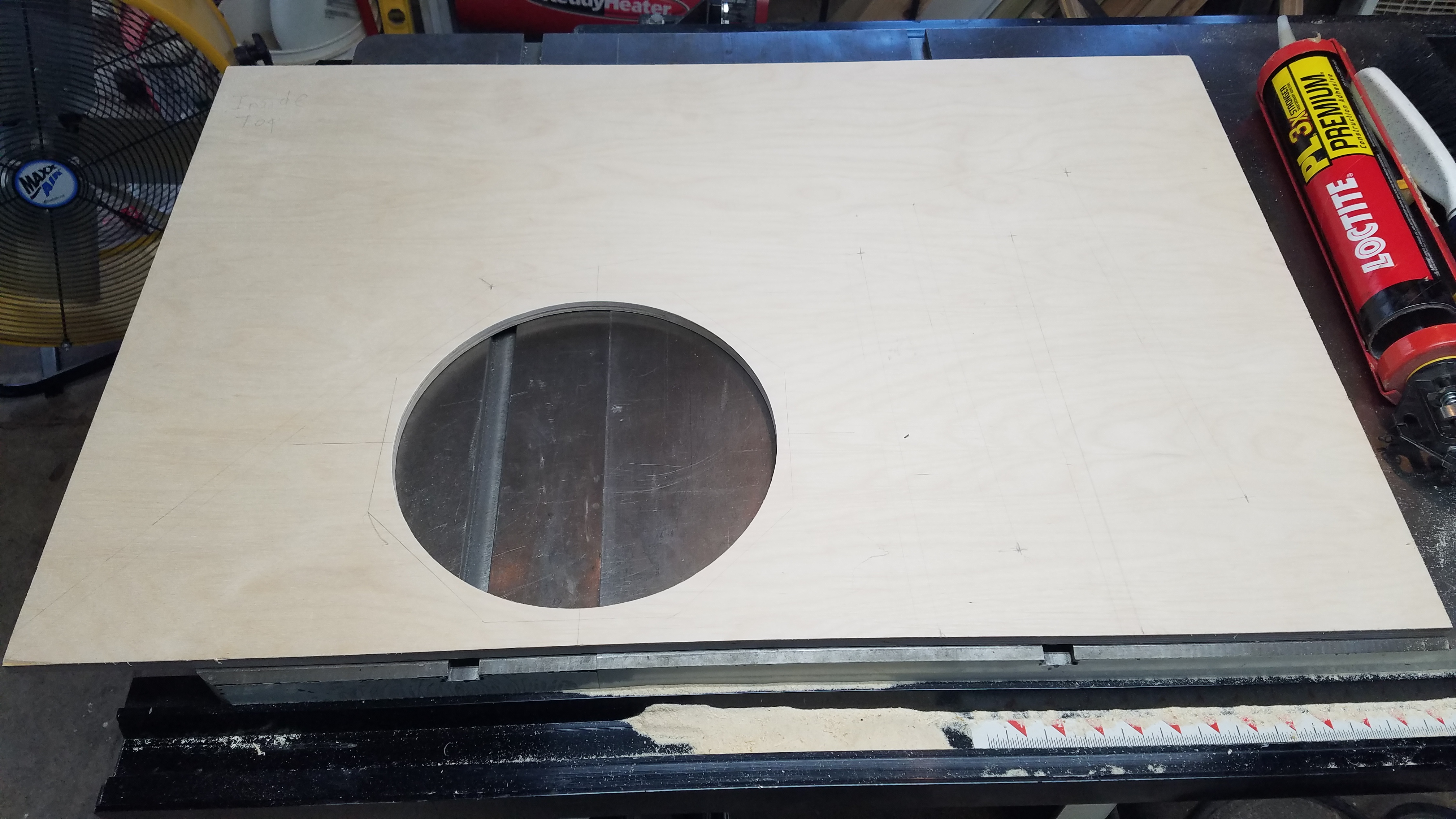

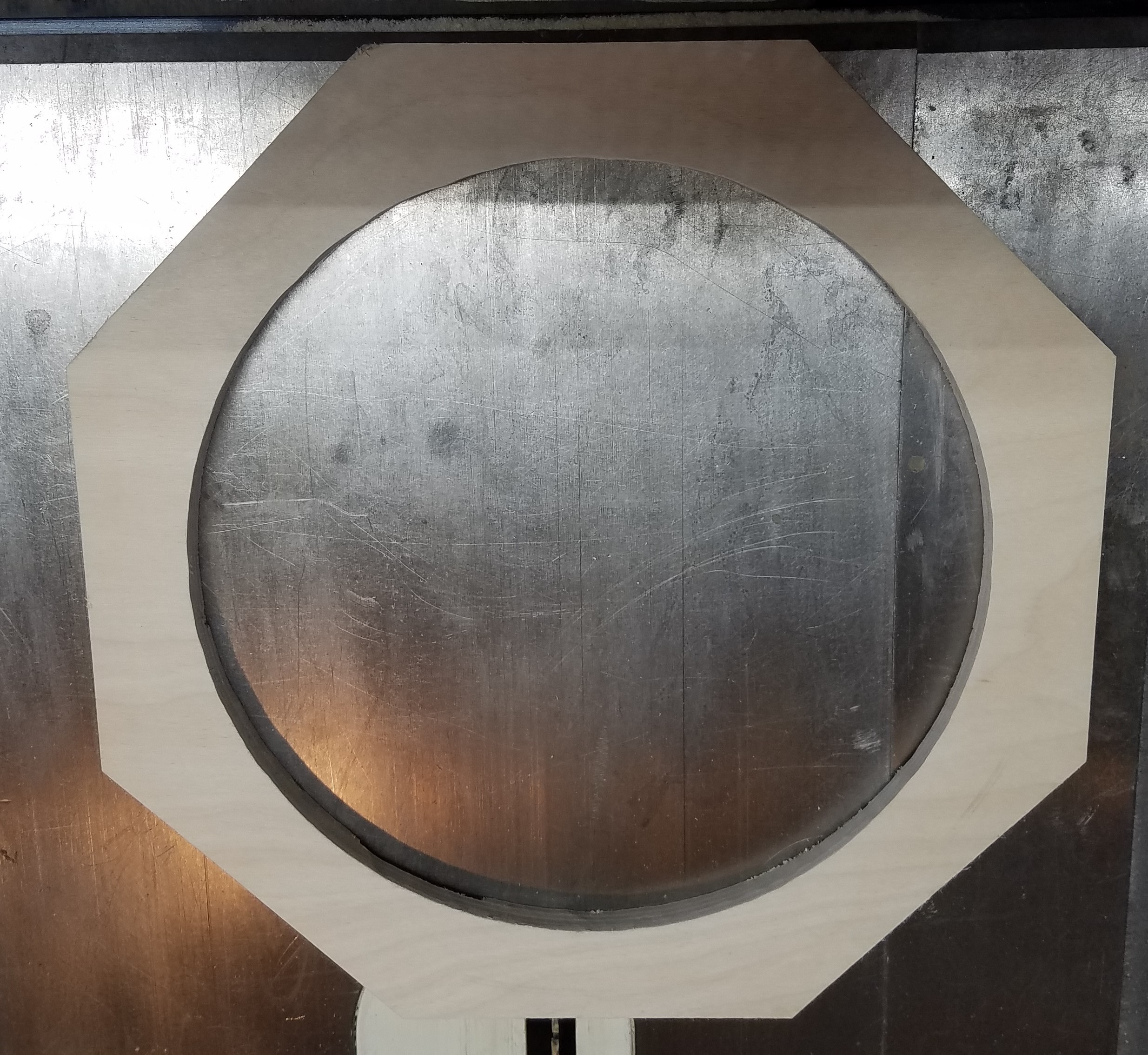

Today I used a roto-zip with 4 passes per side, not cutting too deep, to make the driver clearance hole in the octagon, and the hole in the top/side panel. My oldest stole our router for wedding projects and he's away on his honeymoon so we didn't bother to go steal it back for 2 cuts. I will need it when we round corners nearing the finish line, but for now we are set to glue. The RotoZip works if you only take a 1/16 or so each pass, or take it super slow. And it has an included circle jig so I cut fairly competent circles. Only a little belt sander clean up to remove some odd edges where the RotoZip tilted and cut a bit less than our target radius.

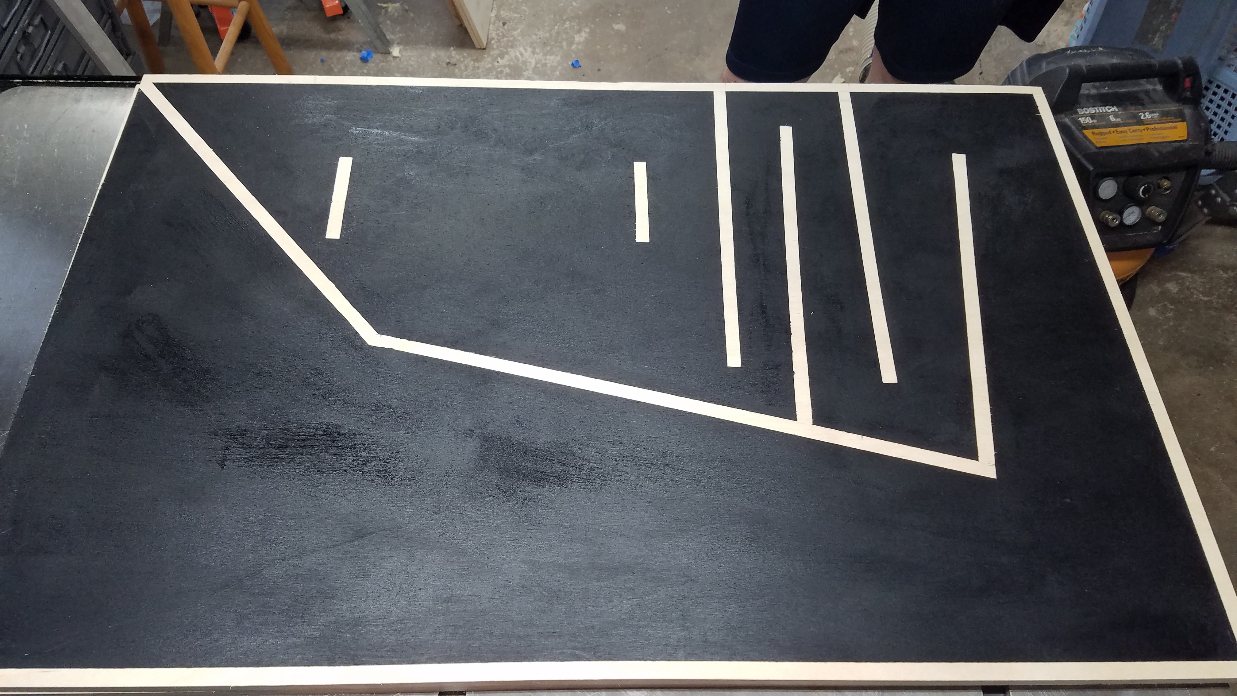

We plan to glue, then shoot 18ga pins to hold it. We'll glue all the internal panels (hopefully) in one sitting and then wax paper over and use second side to clamp it all. Then my son plans to paint the inside (I've created a monster) like I have done with my THT and two Titans. He marked out all the interior points, drew it all up and taped one side off for paint.

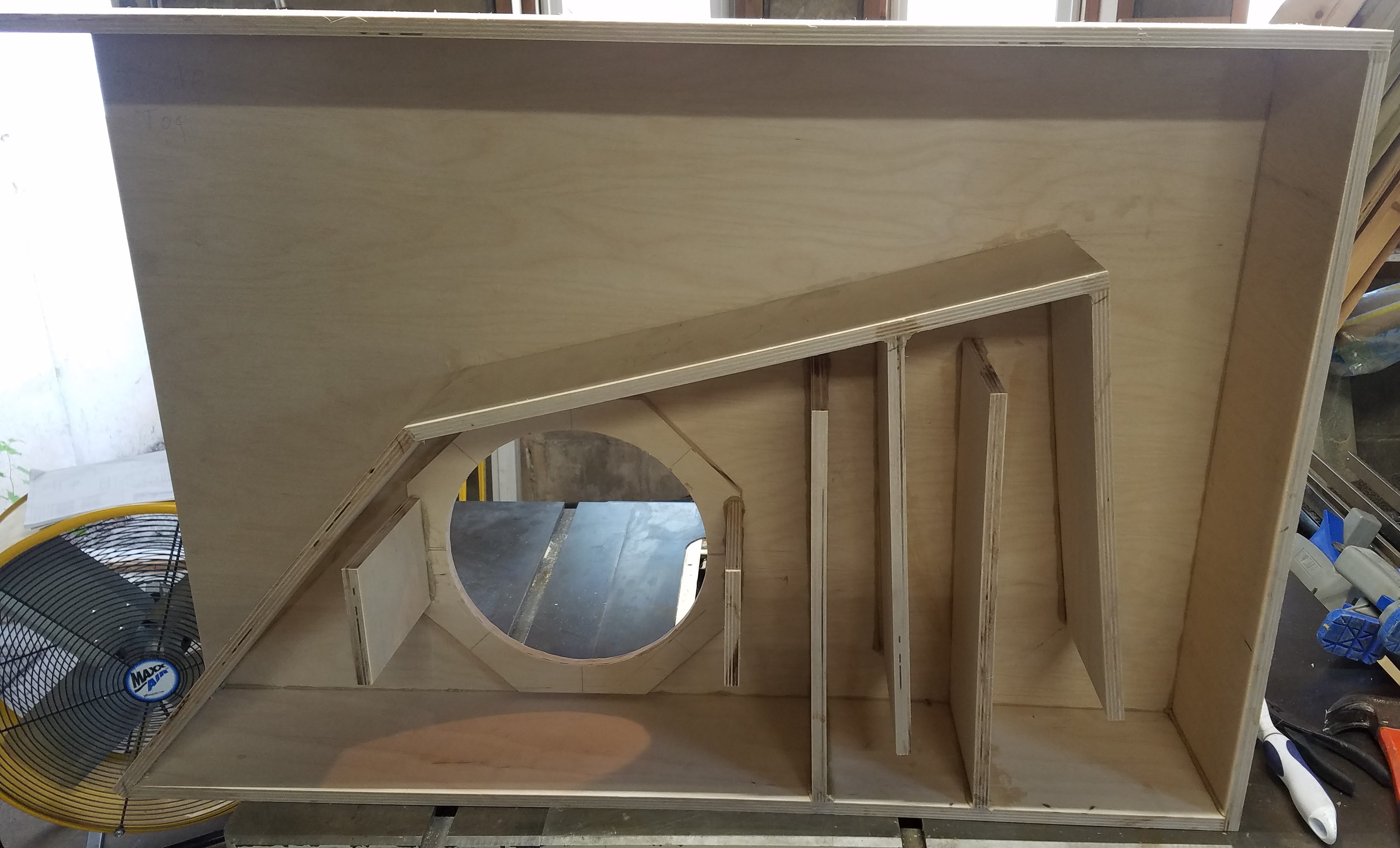

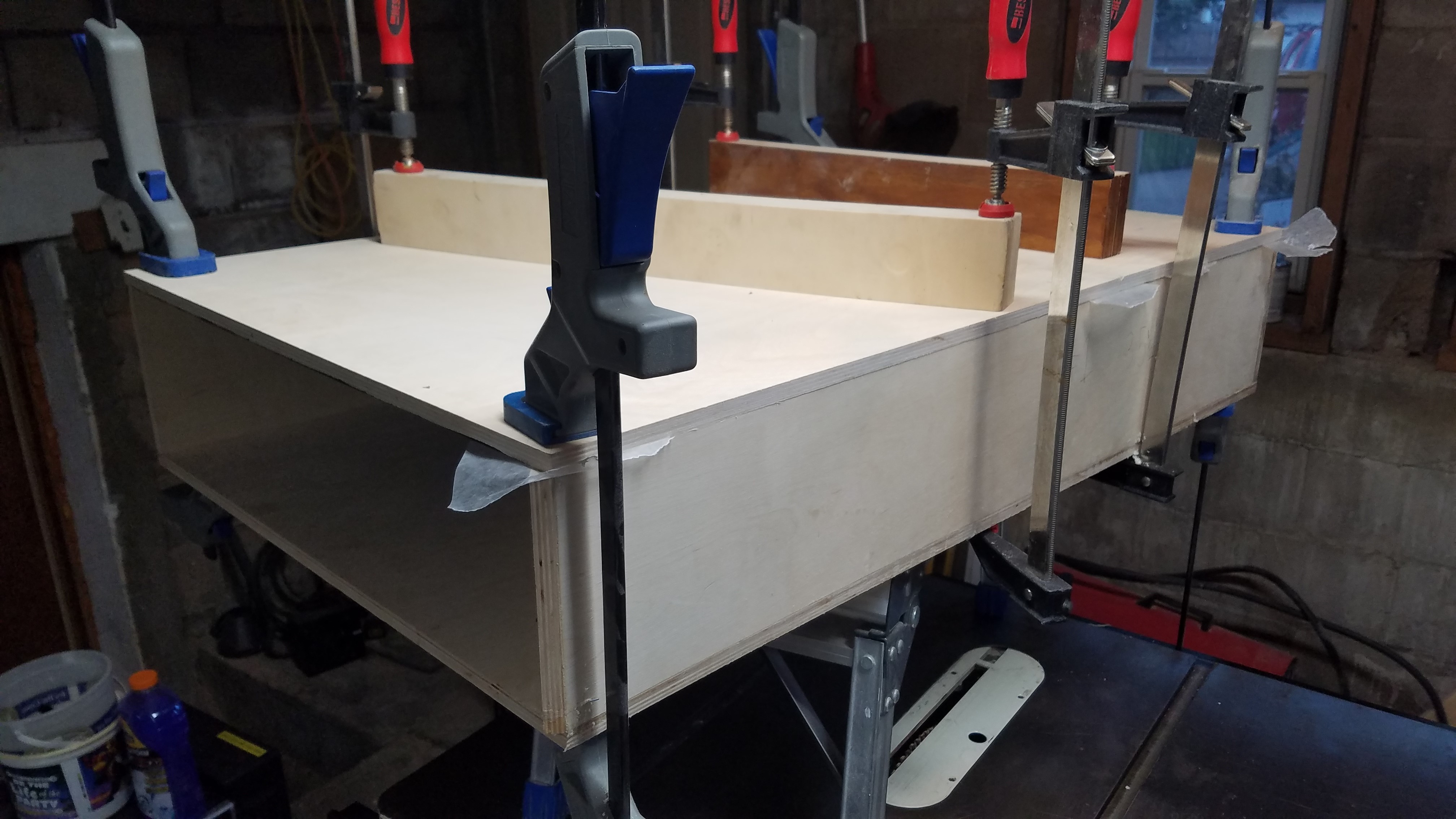

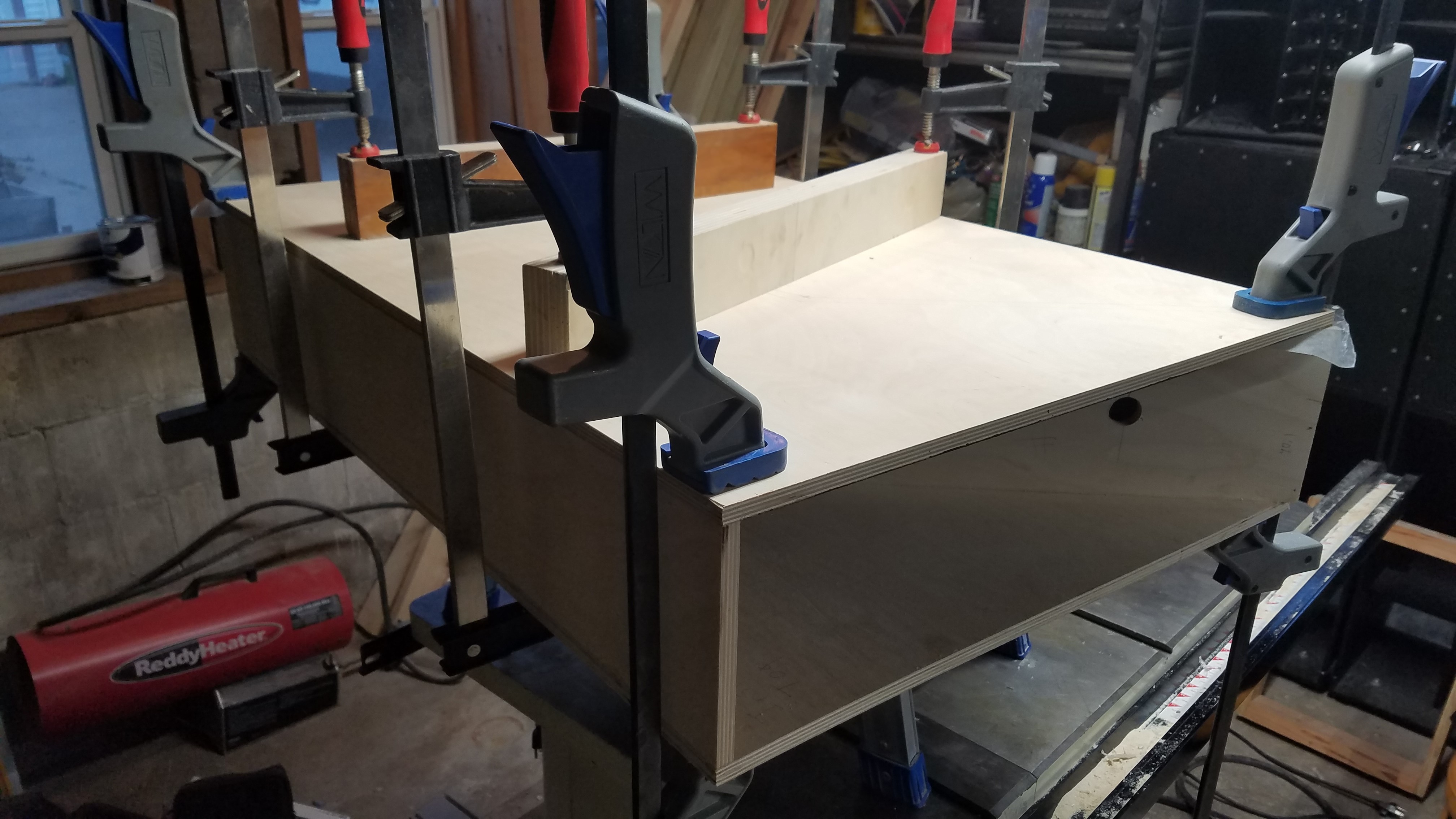

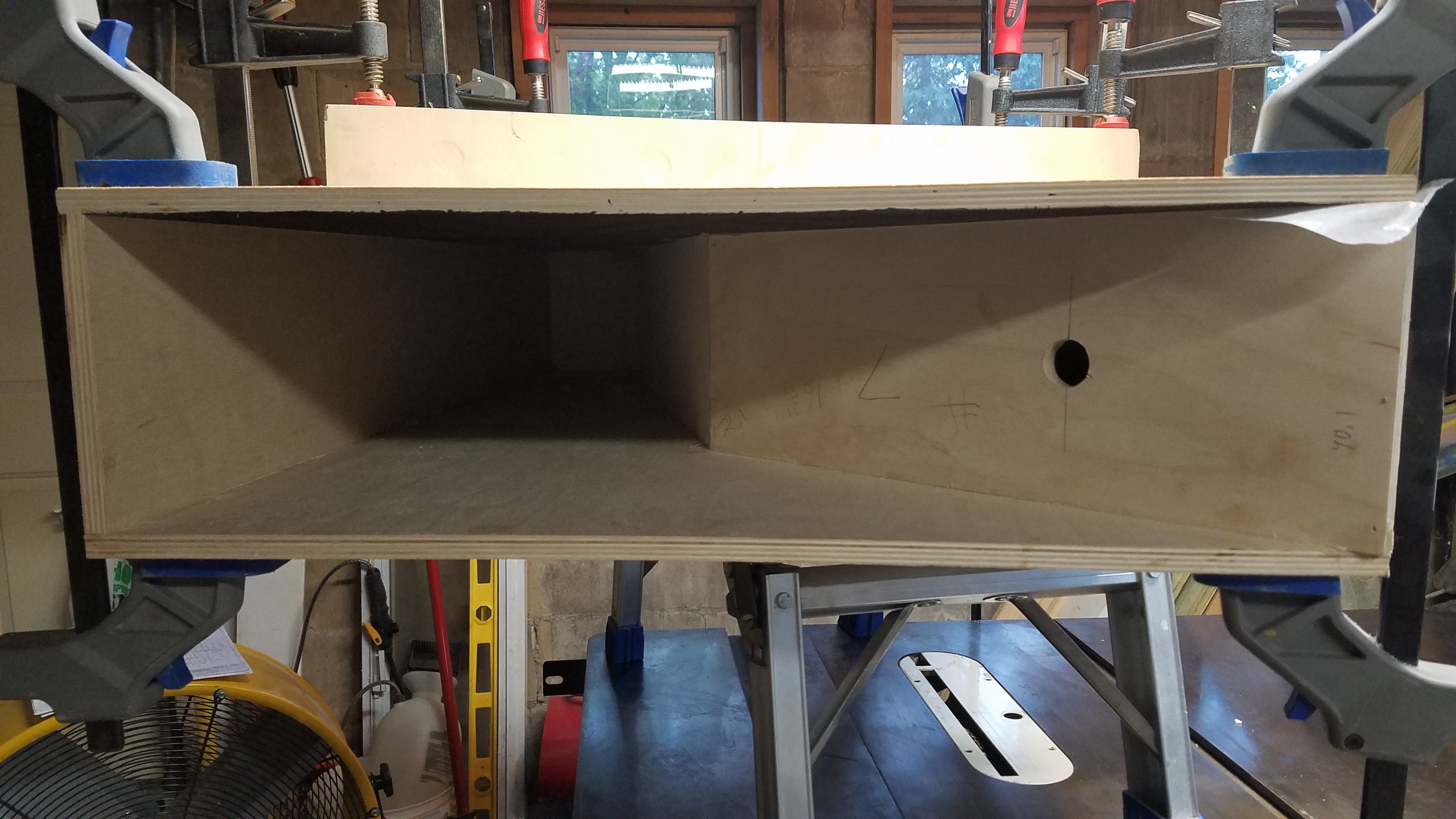

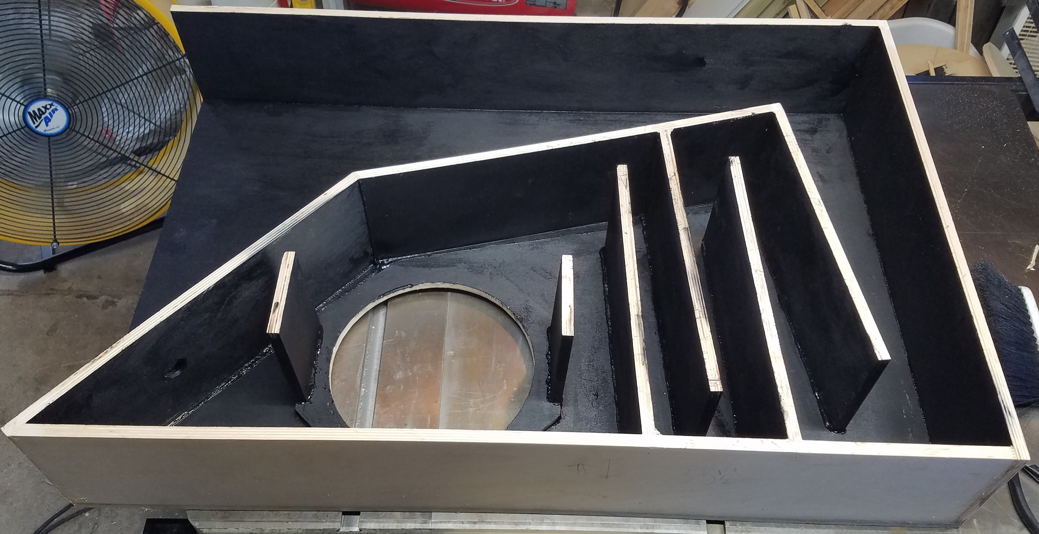

Ok, maybe there won't be a lot of visual detail to this build. Being my second, it's easier. Since we had precut all the panels, this was nearly a slam dunk. I had let the baffle/driver mount set an hour or so and used the chisel trick to clean up the squeeze out. So that part turned out nice and clean. Then Monday late afternoon we glued in panels 1 through 9 all at once and used the top(bottom?) to clamp overnight. We had cut all to length, except panel 3, the one with angles both ends. That one is harder to get on a table saw, being over 45deg, so I decided to let it fly. I'll cut flush with my router after the last side is glued on.
We had layed out all the build lines inside and out on both sides. This gave us nailing guides, paint guides, etc. We started with panel 1 and panel 8 glued and nailed together. I used a cleat to line them up while my son shot 2 pins in them for temporary hold. That gave us some support as we laid it on the side. Then we glued those two to the side, using a cleat at the corner to align, like the plans show. Then we worked down the edge and nailed those two to hold them while we raced ahead. Next, panel 4, then 2, using a carpenters square to hold them perpendicular while my son shot a few pins in them, both through panel 1 and the side. Then on to panel 7 and 6. A little hard to nail 6 and 7 together, but he pulled it off without any nails shooting out the side. Panel 7 to panel 1 was much easier to pin. Next panel 3 and 5, using a square again to help align. Lastly, panel 9, a few pins and we were done. I threw some wax paper over each joint that would touch the second side, then we dropped it on. We started at one corner, squaring up, then clamping. Then we'd work on to the next corner, pulling everything as close as we could. This is much easier with BB over Aruaco, but either would have worked fine. Then after 4 corners were clamped, we dropped two battens across the middle and clamped those to squeeze all the way across. I went back 90min later and scraped the outside squeeze out. My son did the mouth, his wing span allows him to reach all the way in the mouth. So we'll have nice clean corners where you can see in.

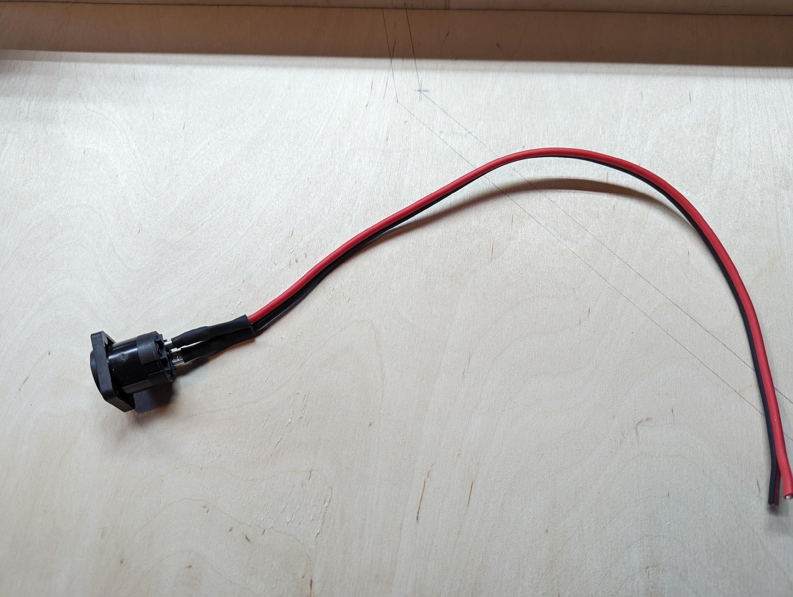

Tonight we may clean up a little PL, paint the inside and perhaps glue the other side on, we'll see how fast the paint sets up. Have to do a little wiring/soldering, and once paint is dry, I'll silicone the speakon in the mouth. I think he plans to use the driver to layout bolt holes and pre-drill for T-nuts and 10-32 hardware, we'll see.

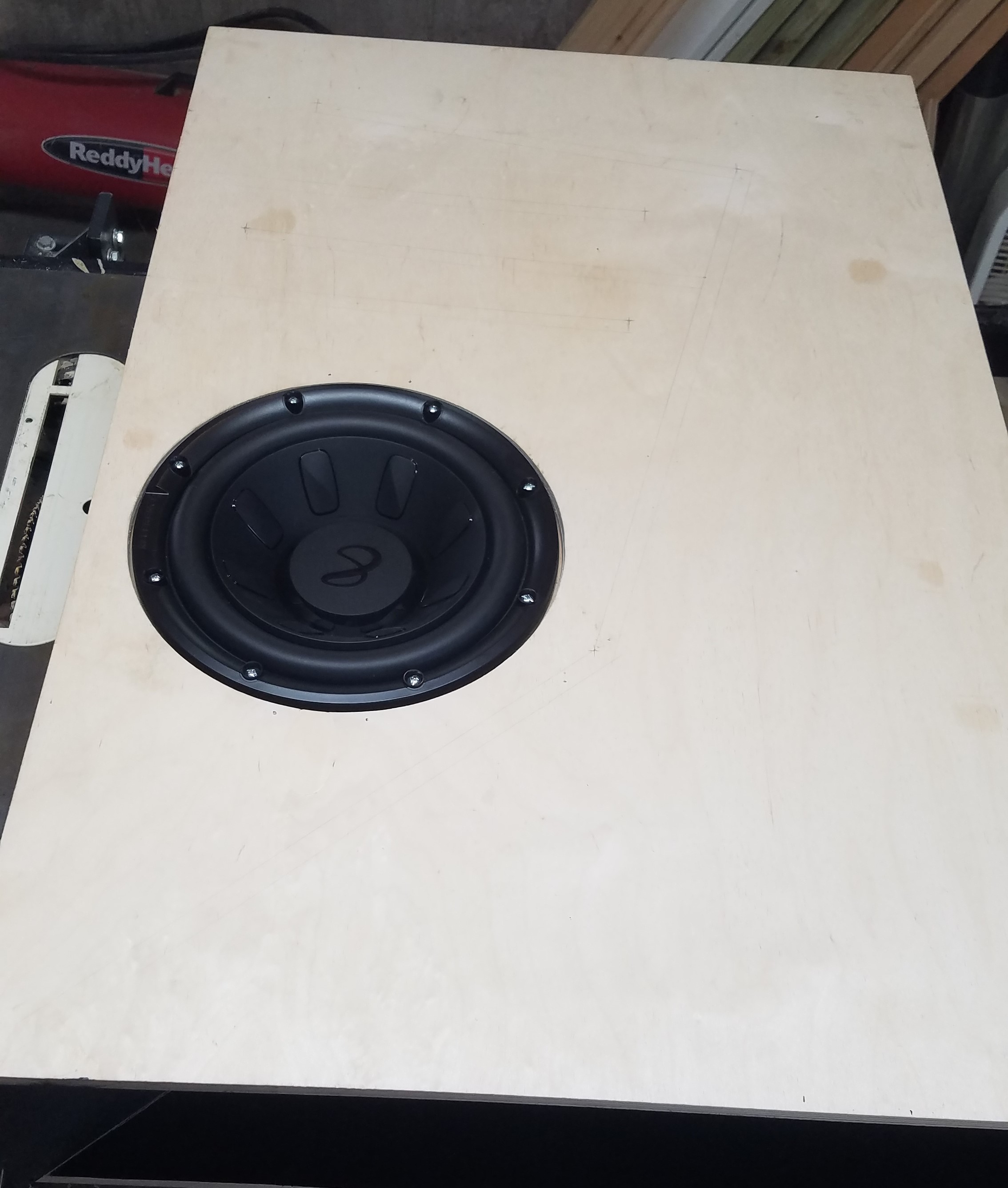

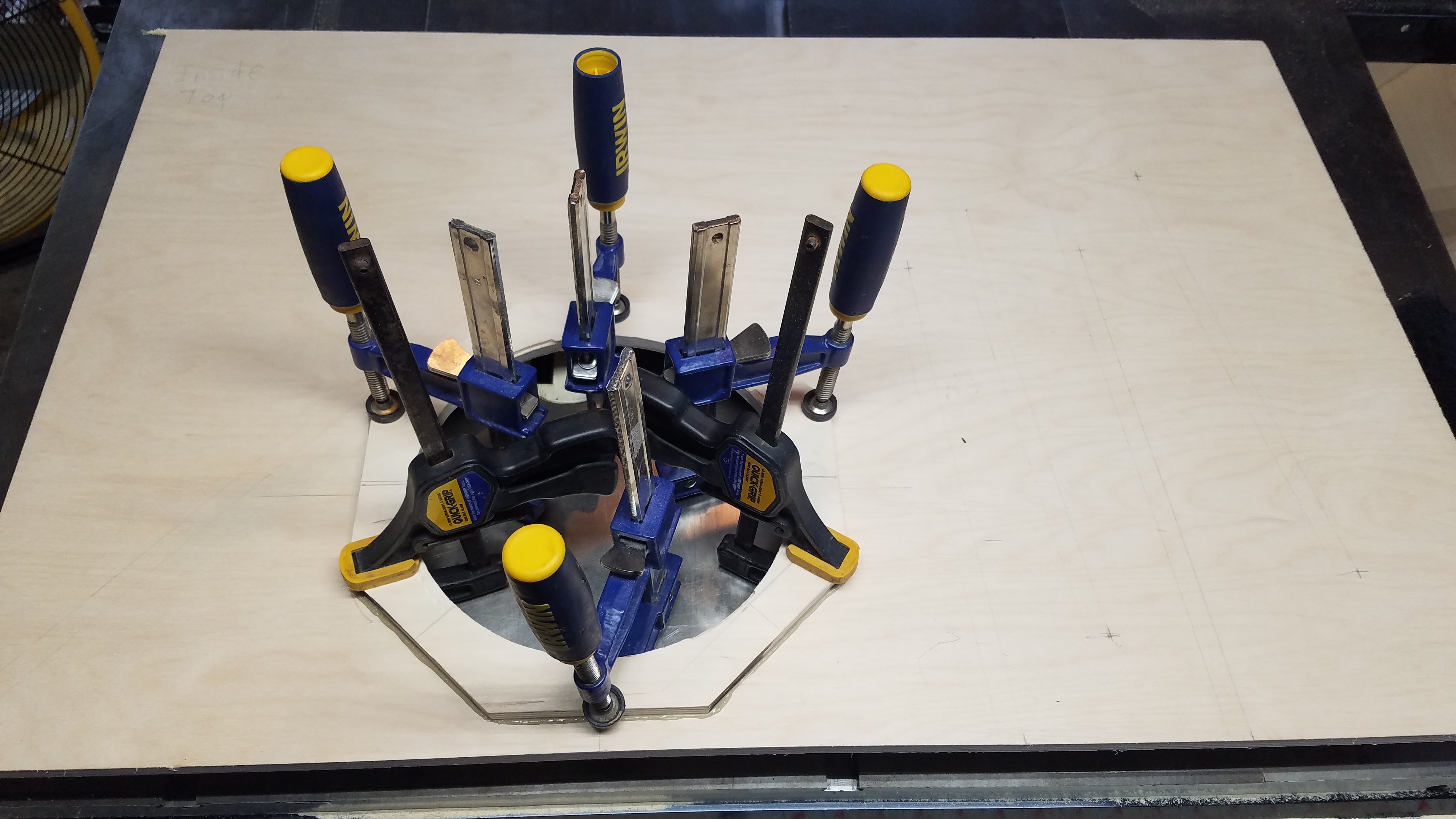

Here are some clamp pictures, not much to look at until I take the clamps off here shortly. OK, in the third picture you can see my overkill DR200/T48 stack. Yes, we had them playing, it's mandatory while working in the shop!

It's been 24 hours, I took the clamps off and cleaned up the mouth a bit more. I'm leaving all the PL squeeze out and my goobers in the path. It's just too tiny to get in there. I was difficult to paint, I need to get a spray gun...
Hopefully later tonight we'll glue the other side on so we can maybe try it out next weekend.

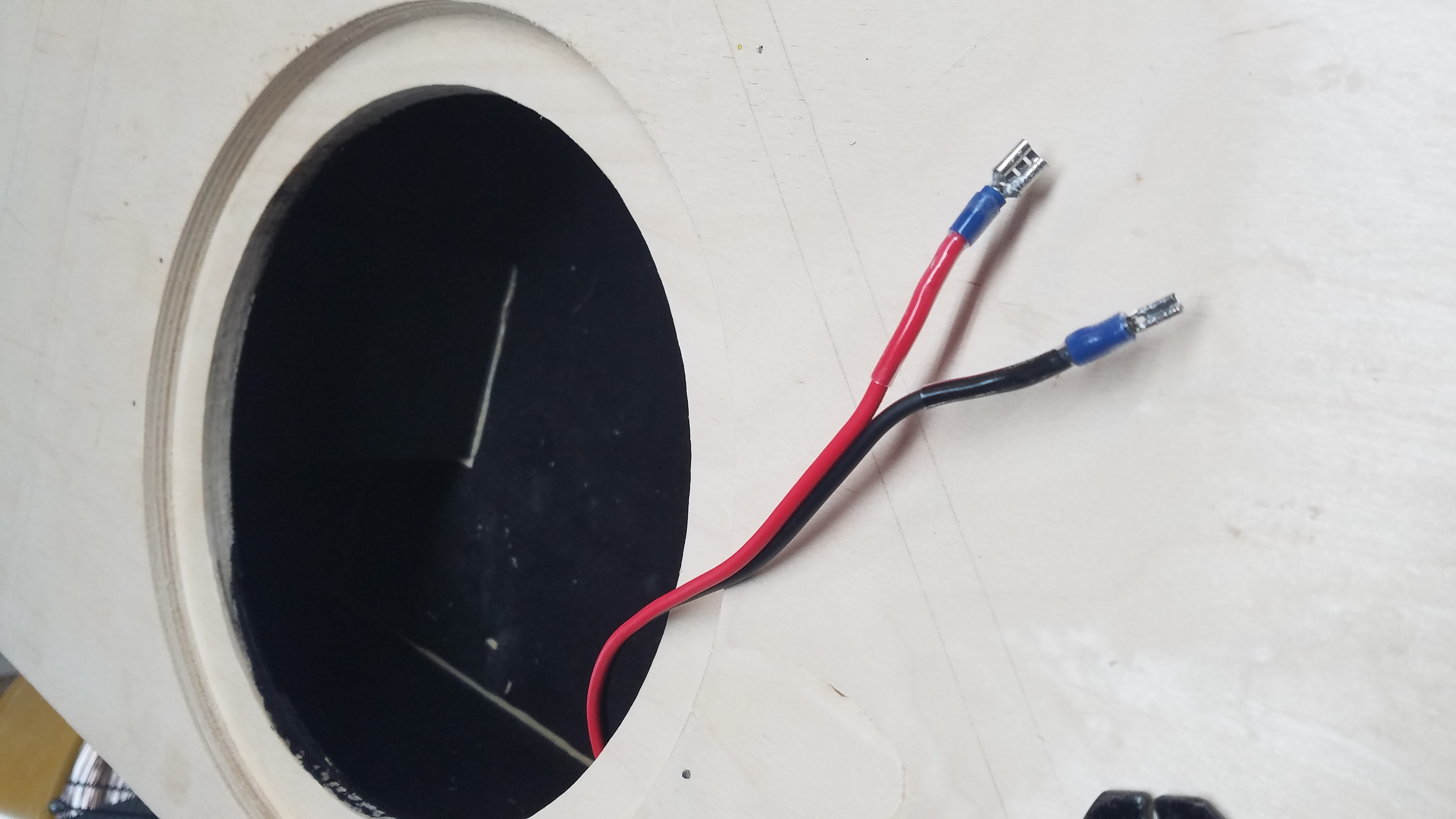

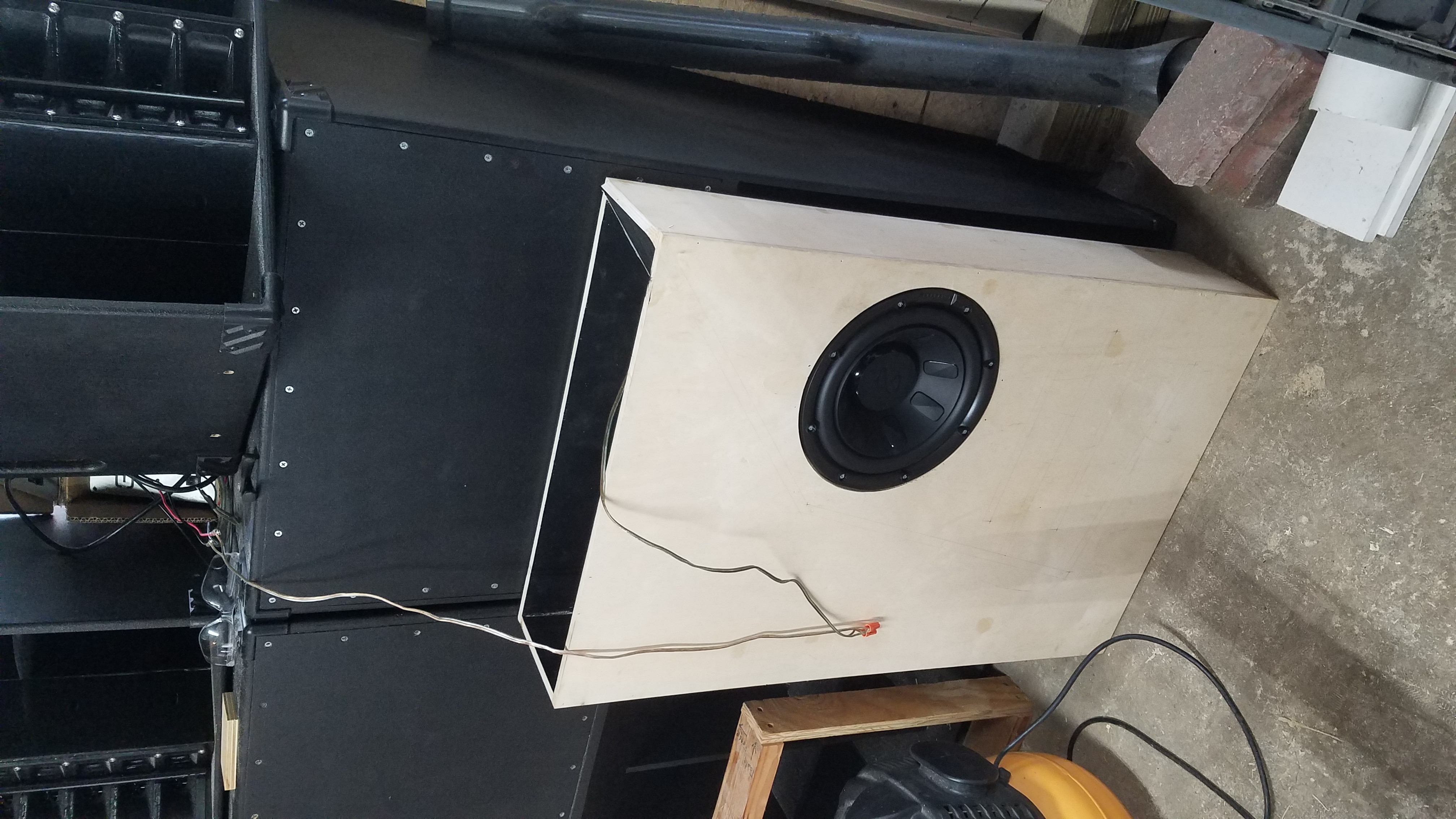

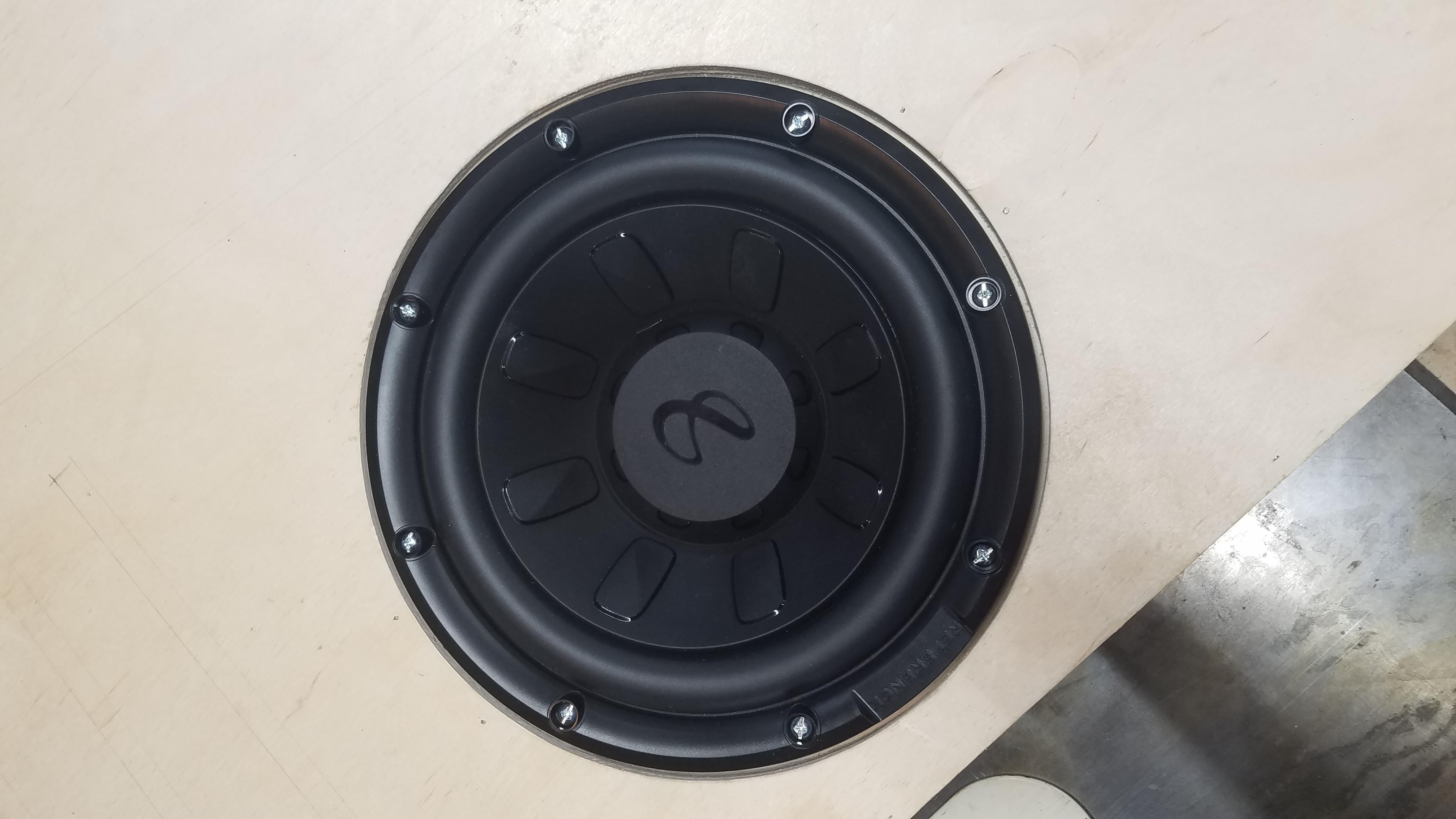

Small update, the second side is unclamped and cleaned up. The harness is soldered and heat shrinked on both ends. We caulked the Speakon jack in when we glued the second side on. Yesterday we re-caulked, it leaked on one edge during testing! We test fit the driver and marked/drilled holes. My son used a C-clamp to pull/squeeze T-nuts in to those holes. Then we did a small sound test and leak test. The Truck Tuba does NOT keep up with the DR's, but you all knew that. We ended up turning them off, just to do the leak test and marvel at the deep bass. We can't wait to hear this with cabin gain!
I need to break in the driver too, didn't even think about that. Now on to outside finishing. We spot puttied all the nail holes. Then I have to fetch my router back from my oldest son so we can round the edges.

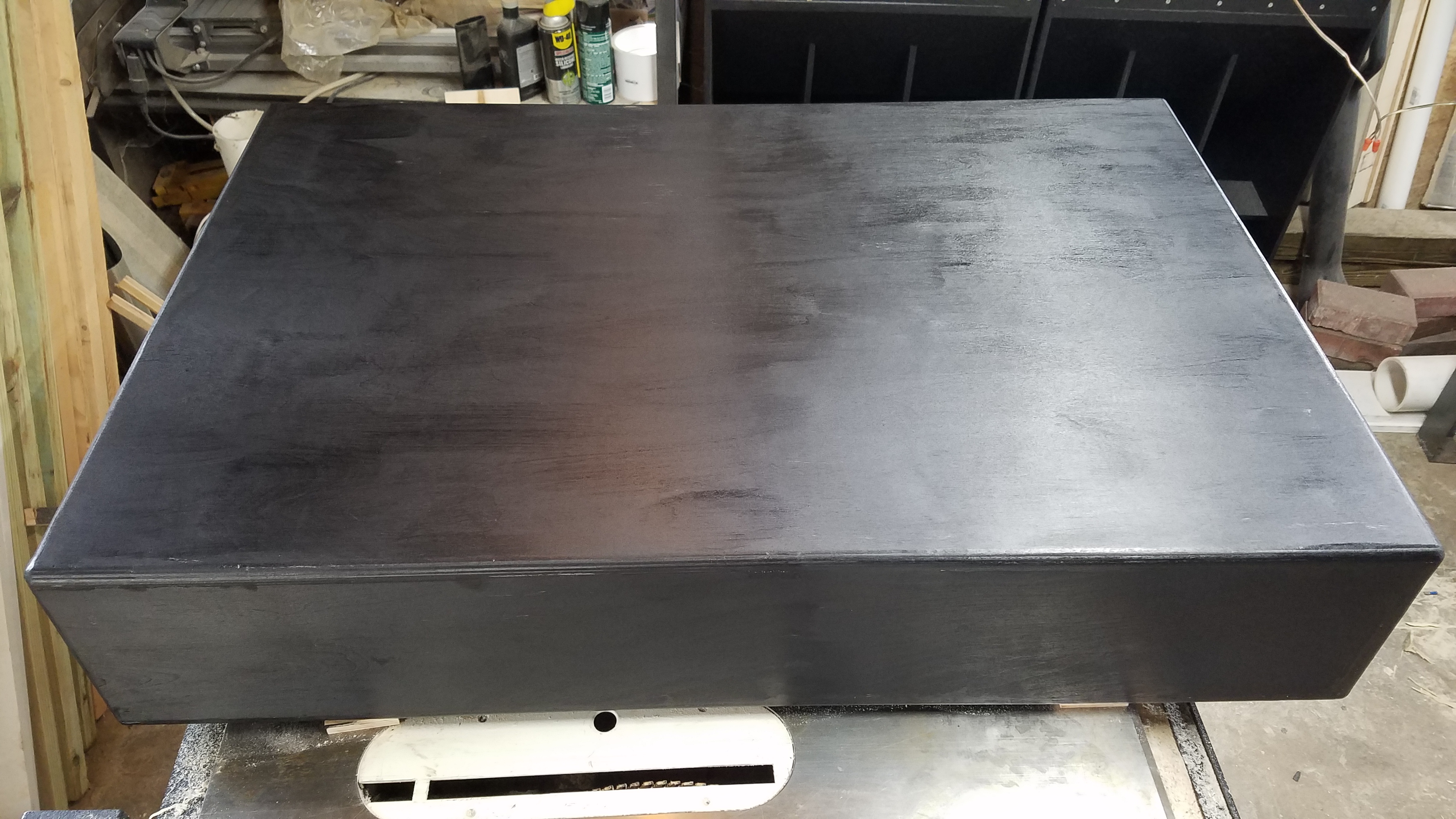

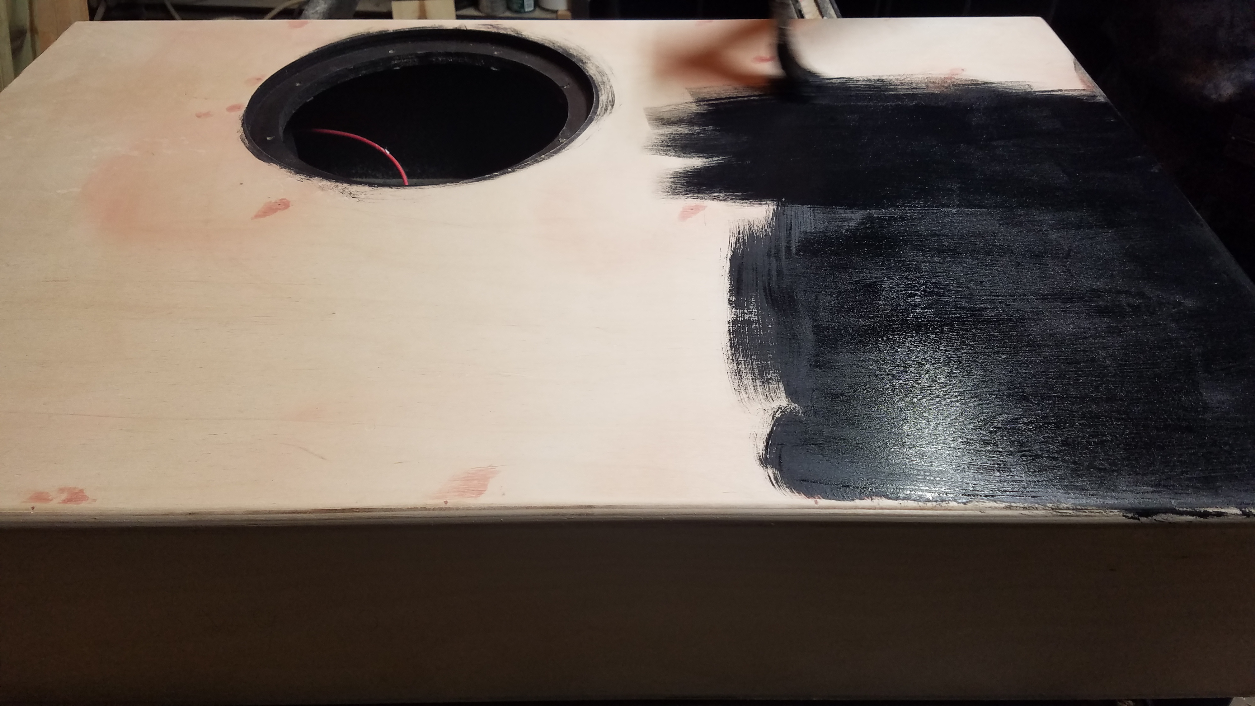

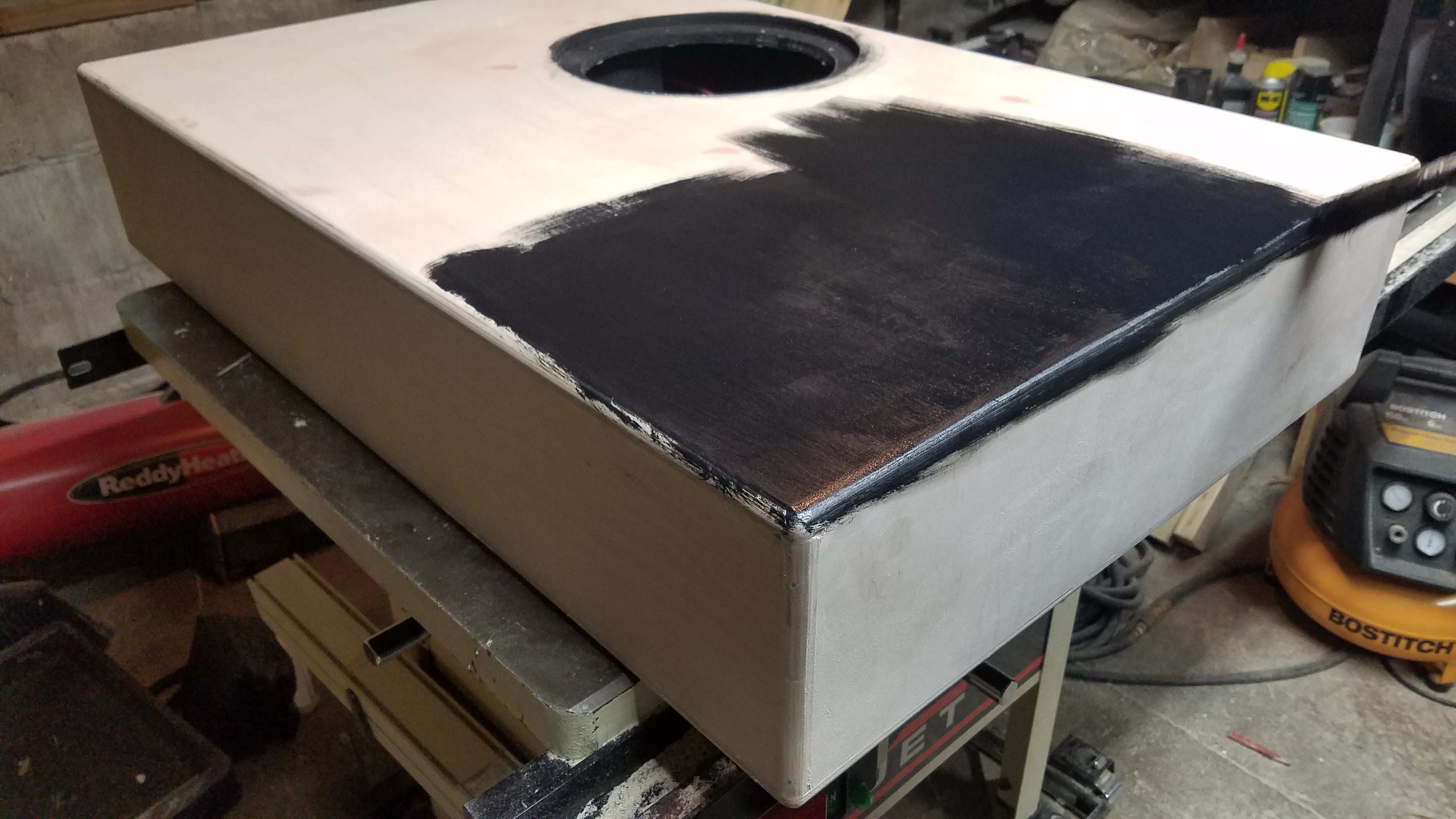

Not much to update, my son's been busy at work so not much progress. He sanded out all the spot putty, and routered the edges with a 3/8 roundover. We should be able to Duratex today, but I only have pictures of him starting to primer. If I remember, I'll take another snap all dressed in black before we Duratex.

Shot of the back side primed. Going to put Duratex on the back today. Humid as heck here, so I don't know if we'll be able to do the front/top tomorrow.
