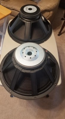

I built this intending to use the Realistic 40-1309. The plan was to build a second one day, because I had 2 drivers. Just. Coz.
Then last summer I came across closeout Parts Express factory buyout B-52 folded horn drivers made by Celestion. Here is the old and the new, and I started building cab 2 last August.

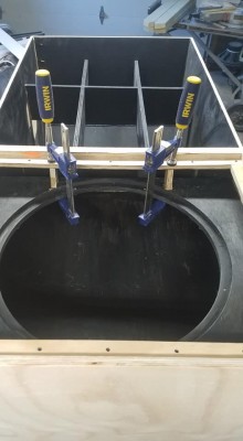

Here is the baffle doubled up and routed out. I put T-nuts in the back and screws on the T-nuts so they don't come out.

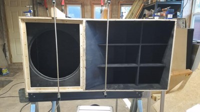

Panel 3/4 glued on, and a wire channel on the top.
I glued up all the frame pieces for the front, cleats and all, and glued it all together. I also cut the front cover a hair oversize and covered it in wax paper to use as a glue jig. I match marked all the drill holes and used it all to clamp together while glue set and to clamp on to the side.

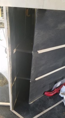

Side profile with all panels and corner reflectors/braces in, mouth braces in before side 2 goes on.

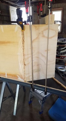

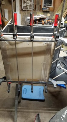

Side two goes on, it is not warped now, but yes, i clamped her tight at first!
I also added some spacers to stiffen the front. I think I need these in cab 1.
I had to place and move them several times to make sure I could actually slide the driver in, since the opening is smaller that the frame outside diameter!

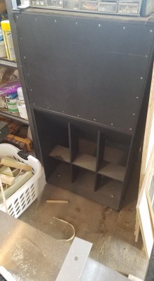

Woofer test fit, some Duratex and corner protectors. Also a shot of my new solder station, that helped me greatly. my 40 year old soldering gun was tired...
