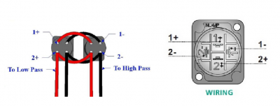

1st doubt:
The wiring detail of the "Neutrik" website says that 2+ and 2- are in a reverse location when compared to Bill's instructions. (see pic)
2nd doubt:
How does the input signal go from pole 1+ to pole 2+? Does the Neutrik Speakon have internal bridges? (see pic)

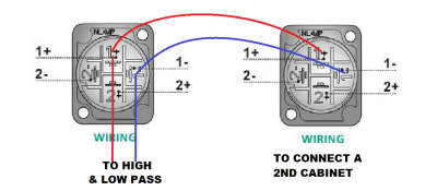

Thanks Bruce Weldy, it was fast!
Do you mean this, right? (see pic)

#4 Post by Bryan Cox »
Yes that's right. This is an internal daisy chain.
