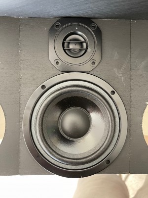

But today I found a woodworking issue. The driver frame is a little bigger than the recommended size and it doesn't quite fit. I'm thinking...sand the bottom of the driver frame or route a little, narrow groove where the frame "dips into the bottom", if that makes any sense. Is there a better way I'm not seeing? Thanks :)

Posts: 28932
Re: 8 driver SLA center channel crossover?
That outer frame could be squared off with the right tool. This is definitely a 'measure twice, cut once' situation. :(
Posts: 3018
#14 Post by Seth »
I'd use an abrasive blade in the table saw and make a sled jig to make the cuts perfect and identical. I have a hadful of those drivers, and best I can tell from the photos, trimming that portion of the driver frame doesn't look like it would interfere with the gasket.
