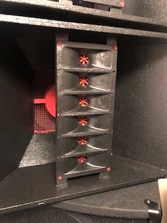

Thank you for the tips for cutting throat panel. I could not get my head around it at first but I finally got it. Here are some pics of the finished cabs.

Nice touch with the red accents.
