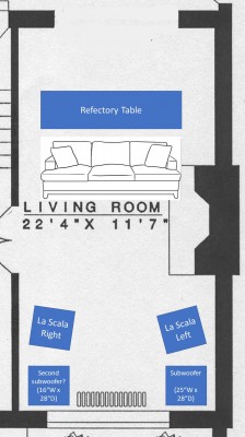

My listening room is long and narrow. The WAF dictates the only places where the speakers and subwoofers can go, even if they don’t sound great there. The only spots available for the subwoofers would be in the corners of the room near the front windows (see image). You will note that one of those spots is smaller than the other (16”W x 28”D versus 25”W x 28”D).
I’d welcome recommendations about what to do given those constraints. Should I:

Two smaller will work better than one larger. THT versus TT is a matter of how low you want to go. Predetermining locations for subs usually ends badly. For one thing they should almost never be located at the same end of the room. You use the sub crawl method to locate the first, then place the second where it does the best job of smoothing the response at the listening position.

I went with two THTLP subwoofers. I made them as small as possible (i.e., 15" wide) which necessitated using 12" drivers instead of 15".
They turned out well. But having 2 subs didn't do as much to alleviate the room modes as I'd hoped.
Now I'm working on room treatment, after which I'll try again with REW to come up with good EQ settings for the subs (each has a plate amp with some DSP capability).

One is as shown in the diagram. The other is in the corner diagonal to it.
