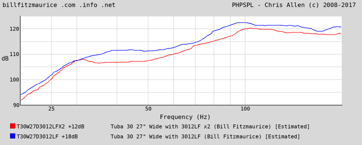

Rick, if you converted your existing cabs to single driver (just remove 1 driver and screw a gasketed disk in it's place) and doubled your cab count to 8 single loaded cabs, you'd have a decent gain in output for only the cost of ply, construction time, and consumables.
There isn't a chart for your exact width but here's 4 double 3012LF loaded 27" wide cabs (RED trace) compared to 8 single 3012LF loaded 27" wide cabs (BLUE trace).

Is that 107dB @30Hz for 2.83V?
Re: FaitalPRO 12XL1200 For Tuba30
Posted: Sat Aug 21, 2021 10:20 am
by Seth
Chris_Allen wrote: ↑Sat Aug 21, 2021 9:10 am
I
believe so. But I couldn't say 100% without verification that the double loaded cab was measured at 2.83. It appears to be consistent with what I'd expect to see at 2.83 though.
And, that's 2.83 into 8 drivers. So, 8 "watts" total. 4 double loaded cabs vs. 8 single loaded cabs of the same width. I added 12dB to the double loaded trace to account for 4 cabs and +18dB to the single loaded trace to account for 8 cabs.
I think the 3-5ish dB gain from 33Hz up sells the scheme, big time. Same number of drivers, same amplifiers... just 4 cabs worth of plywood and time get's 3-5dB. That's huge gains for pennies.
Posted: Sat Aug 21, 2021 10:57 am
by Bill Fitzmaurice
They won't chart like that. Response will be considerably flatter, with less rise above 60Hz, and the low frequency corner will go down by 5Hz or so.
It is certainly a static comparison that doesn't take into account the realistic benefits that occur when coupling multiple cabs and isn't a 100% accurate representation of a real world result. Would you say it's a bad idea to compare cabs in this way, just to get a rough idea? If so, I'll keep that in mind for future posts and either not do it or include a little informational disclaimer for the less informed.
