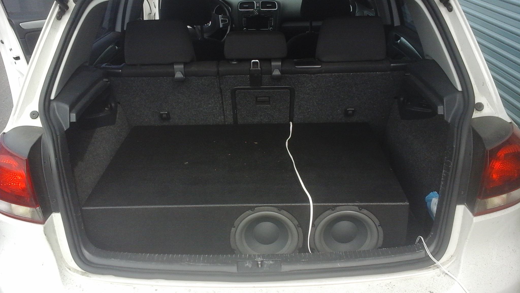

I don't know enough about this stuff to say what effect using your driver will have. However, I've used the recommended 8" driver in a Tall AutoTuba and also a TruckTuba. It doesn't disappoint in the least.
The biggest gains in building a TruckTuba won't be so much in the driver selection, but building the cab as wide as possible... same story as all of Bill's other horn designs... (which you must be well aware of, with your 36" monster!)
For any price, I'd stand and recommend the MCM driver. It works really well. It's just icing on the cake that it only costs $30-$40.
