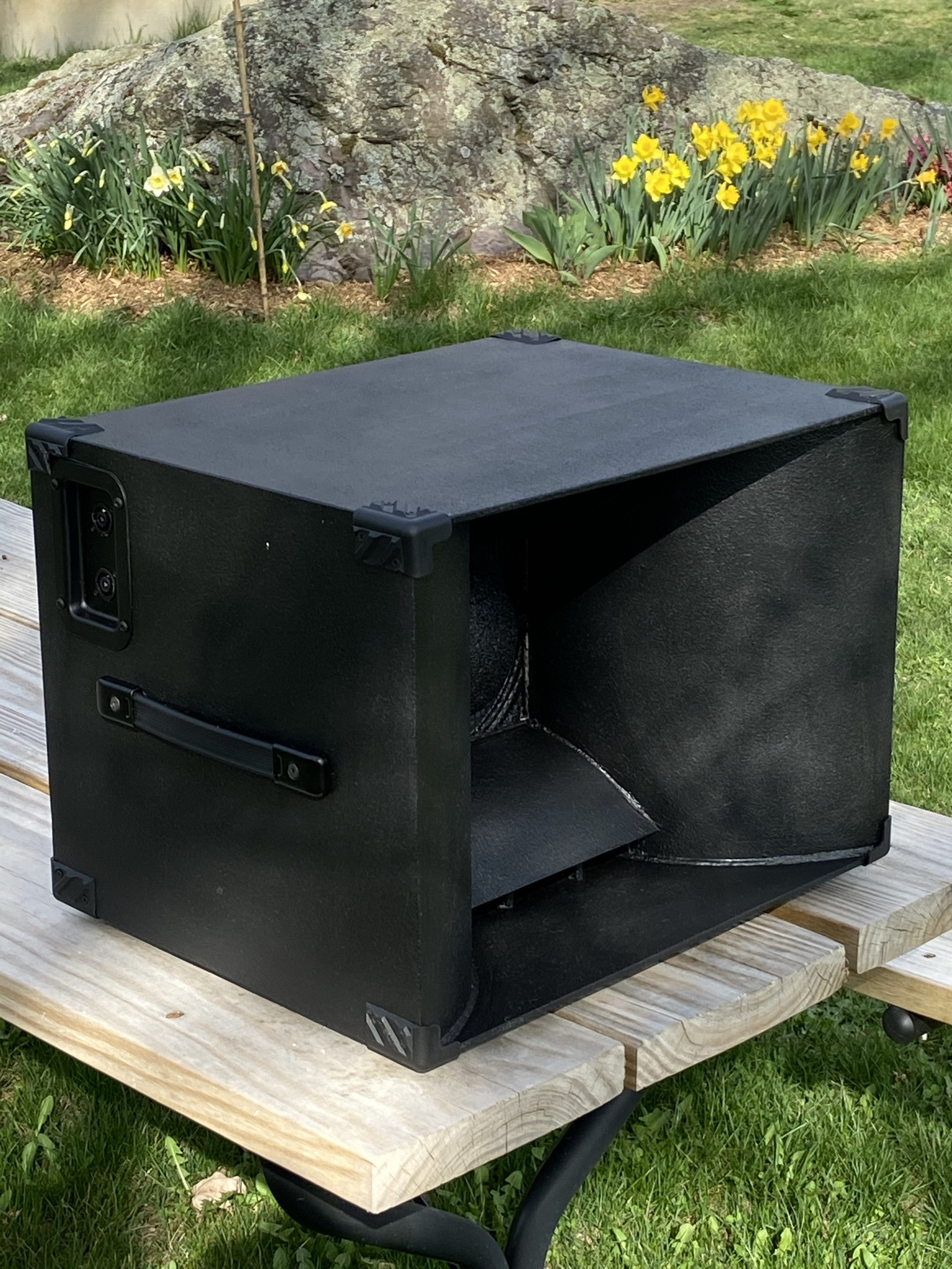

My first ever speaker build. To be used as my ‘grab and go’ bass rig with a GKMB200.
Still testing eq sweep/ranges for my desired tone.
Great build experience.

Good looking cab! Well done
How was the build? Did you complete it fast or spread it out over time?
What driver did you use and did you happen to get a completed weight?

Update: Completed weight = 20.8 lbs with Deltalite 2510
Using GKMB200 (166W @ 8ohm) and P-Bass rehearsed with my loud rock combo last night in our small rehearsal space .. worked great. Volume and headroom to spare. Compliments from the band. "You could gig with that in our smaller clubs". I will try that over schlepping my 2x12 1000W cabinet.
One trip from the car into the rehearsal space. 21 lbs is an easy 1 hand carry. Exactly the 'grab and go' portability that I was shooting for.
Still testing EQ sweep / ranges for tone .. but I have nicely dialed in good tones with both my P Bass and J Bass. For most of my work I favor a 'warmer' 'rounder' tone .. and have been able to achieve.
Overall great experience (aside from my old Bosch table saw crapping-out mid-build). I used the build guide verbatim, no deviations from the plans, steps, order etc. Built over about 3 weeks from start to finish.
On the subject of Titan 39 .. seems like the recommendation here is that a sub on stage would be unwelcome overkill ? I don't have much (any) experience with subs ... but my amp designer friend has been goading me into building a bass amp (his design) and adding a Titan.
Neither supports my 'grab and go' goals .. but for outdoor / larger gigs ?
