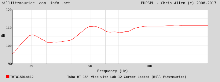

I've been looking for the response of the smallest possible Tuba HT. 12 inch woofer, 15 inch width.
I'm thinking about replacing my corner loaded SVS PC-12nsd with the smallest Tuba HT, on it's side, used to extend the couch. (Is it called a chaise longue in english?)
I will be wall loaded, but i wonder if I'll loose response below 30 hz.

#2 Post by Seth »

Thank you! Guess i don't have to worry about low-end extension.

JensToft91 wrote: Mon Mar 01, 2021 11:34 am Thank you! Guess i don't have to worry about low-end extension.
No, but your neighbors do. :)
