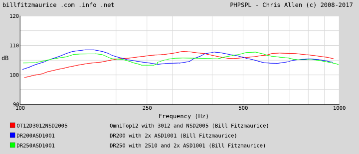

Here's the melded piezo array, ASD1001 compression driver, and NSD2005 compression driver ( The NSD was recently discontinued, but other similar options exist) in an OTop12.
one more thing: otop12 will give me enough punch right? and within my setup they would be the better fit than a dr200?
Again, that depends on your interpretation of what "enough" is. Enough to hang with 4 bass reflex 18's? My guess is yes, but it really depends on the venue and your expectations. If you're like me... there's never enough of anything good in life. LOL
Here's the mid frequency response of the OTop12, DR200, and DR250
