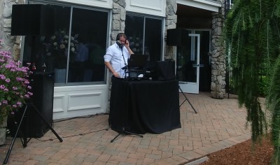

Nice. I assume the T39 is a 3012LF? I don't think I could run on a single BP102 T39.
I always like to see the attention to detail like the taping of the cable to the floor and all the tape being evenly spaced. Makes all the difference to me when assessing professionals.

Re: 10 Years Later - DR200 & T39
That would be my guess. By the looks of the one in the photo and taking into account that the DR200's are 20", I'd say the T39's easily over 20" cab width (max width for a 10" driver) and pushing 30".

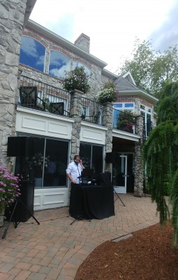

I posted a lot about these when I built them, so if I forget the details, they are there. I kept the tall shot of the venue/house to show the quality of jobs I can do, but you guys are professionals, so you correctly notice the gaff quality instead. Believe it or not, this gig I did with herniated disks, so my amazing wife helped. She carried almost everything. I handed her the gaff tape and told her what to do while I plugged in everything waist high. Bonus: she insisted I buy nice new headphones (ATH-50x) after seeing my old ones crumbling onto my ears.
