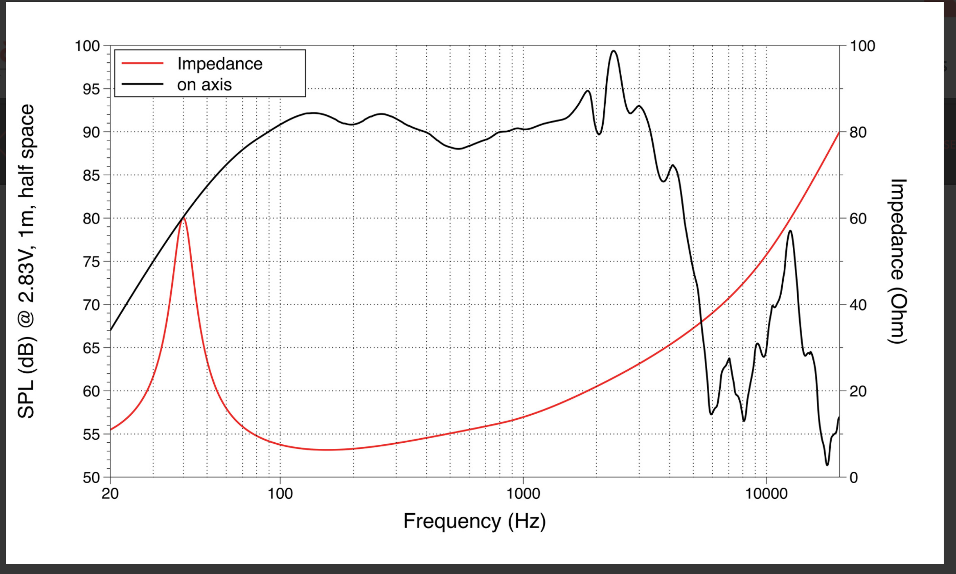

LaVoce SSF 122.50L (possibly sold @ loudspeakersplus and parts-express)
http://www.lavocespeakers.com/lavoce/as ... ER_A.a.pdf
Response curve attached as image

Dayton's and Fane’s SPL charts seem to indicate higher output than a Delta12-LFA from 40-100 hz. The LaVoce is higher from 40-75 hz. Someone please correct me if I’m wrong.

Data sheet charts are measured with the driver mounted in a wall. They have no bearing on what low frequency response is in a horn, or any other enclosure for that matter.
