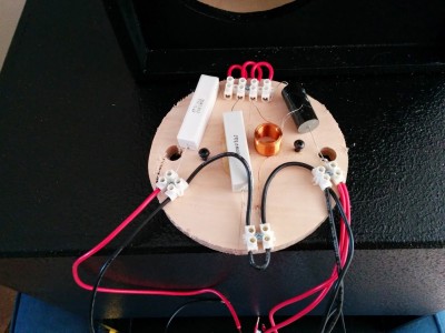

As an example, here is an SLA crossover I built on the scrap ply that I took out for one the drivers. Most people build the each crossover on a separate block. This simplifies testing and installation but takes up more space.

Re: Building Omni 15 Crossovers
Chris, thank you so much for these posts.
Really appreciate you looking through the doc, will amend the mistakes.
It seems like a good website! Fairly reasonable prices as far as i can tell
Great to see some photos of the finished product. Will order all the parts and post some more questions as soon as we get building...

Can I just ask what those screw attachments you used to connect wires together are called?
They are called terminal blocks.
You can get them at any DIY shed, builder's merchant, hardware or electrical supply shop.
They are used in residential and commercial wiring to join mains-voltage cable in the UK.
Probably confusing for our American friends, they (I believe) use little plastic-encased conical springs that you twist onto connections instead.
