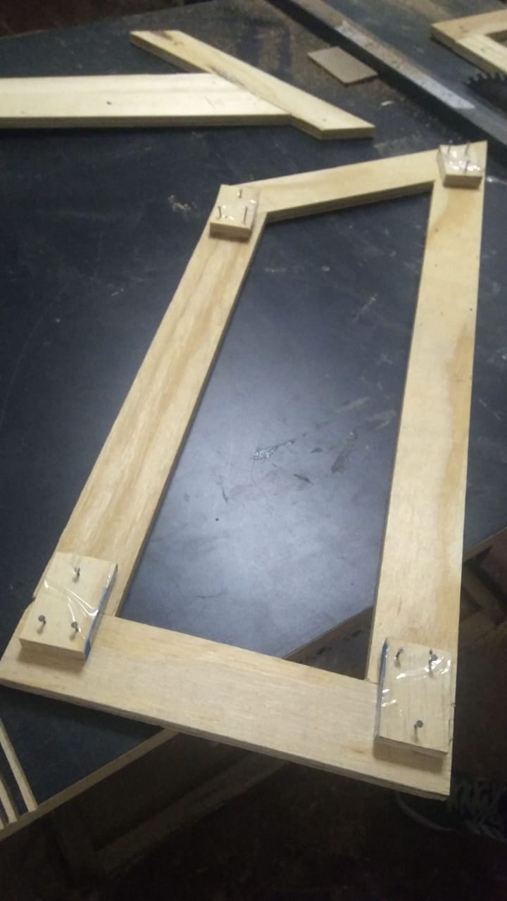

Hi, how are you guys?, I'm building 4 T60, 2 27" Lab15 and 2 20" Lab12, I have a problem with the braces, some don't get glued, and some detach with some easy pressure on them, what could I'm doing wrong?, any tips?, I attach picture and videos.

Hi Seth, yes I'm using plenty of glue. As you can see in the picture, I'm using a piece of ply and nails to join the parts, this is the PDF of the glue (it's in spanish) https://www.miceli.com.ar/wp-content/up ... /k-515.pdf

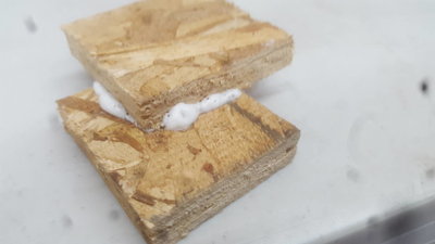

Here's what I'd try... instead of butting the parts end to end, cut each piece full length and glue the full overlapped portion for increased bonding surface area. Also, I may try spritzing the joint with water and keep it in a warm place for at least 24 hours. I'd try it out on test pieces first until I found an acceptable solution.
Posts: 3170
Re: T60 Build, problem with braces
#11 Post by Seth »
Here's what Gorilla Glue (popular option here in the States) looks like after curing. Gorilla Glue is an expanding polyurethane adhesive, however it is not recommended as a construction adhesive for any Bill Fitzmaurice designs that require airtight construction.
I'd think the glue you're using would/should look similar once cured.
In any case, you just have to do the best with what's available in your area if you can't find the recommended adhesive, PL Premium Construction Adhesive.

Yes, I know. I can glue them like this pic i attach, it's not the best looking, but i think i will work.

That looks worth a try. Black paint will hide that pretty well too. I'm curious how and what works out for you in the end. Please keep us posted on your success or lack of success. Could help someone else in the future. Good luck :thumbsup:

A very basic lap joint would look better than that, and even have a little more contact area.

Thank you, yes, the problem is there is more than 400 parts to mill, for the braces xD
