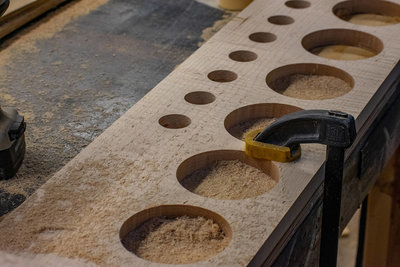

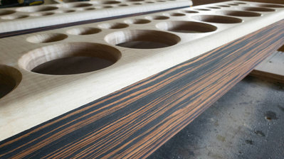

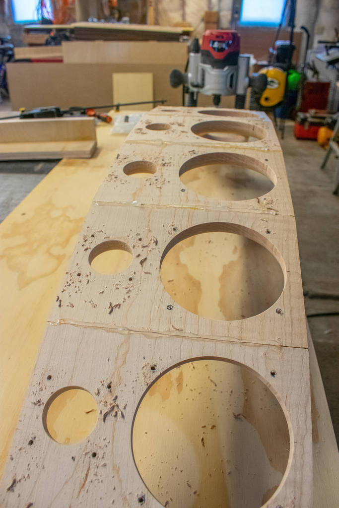

Forstner bit used for the tweeter holes, and a 1/4" up-cut spiral bit in a router with a circle jig for the woofer holes. The front baffle is 15/16" curly maple milled down to 3/4". I made the 3 baffles all at once - trying to carefully measure to avoid another run to the hardwood supplier! Once all the holes were cut I used a 1" round-over bit to make them "pretty".

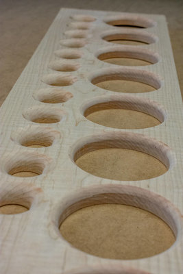

Once all the holes were drilled, I cut and glued up the baffle for the Curved SLA

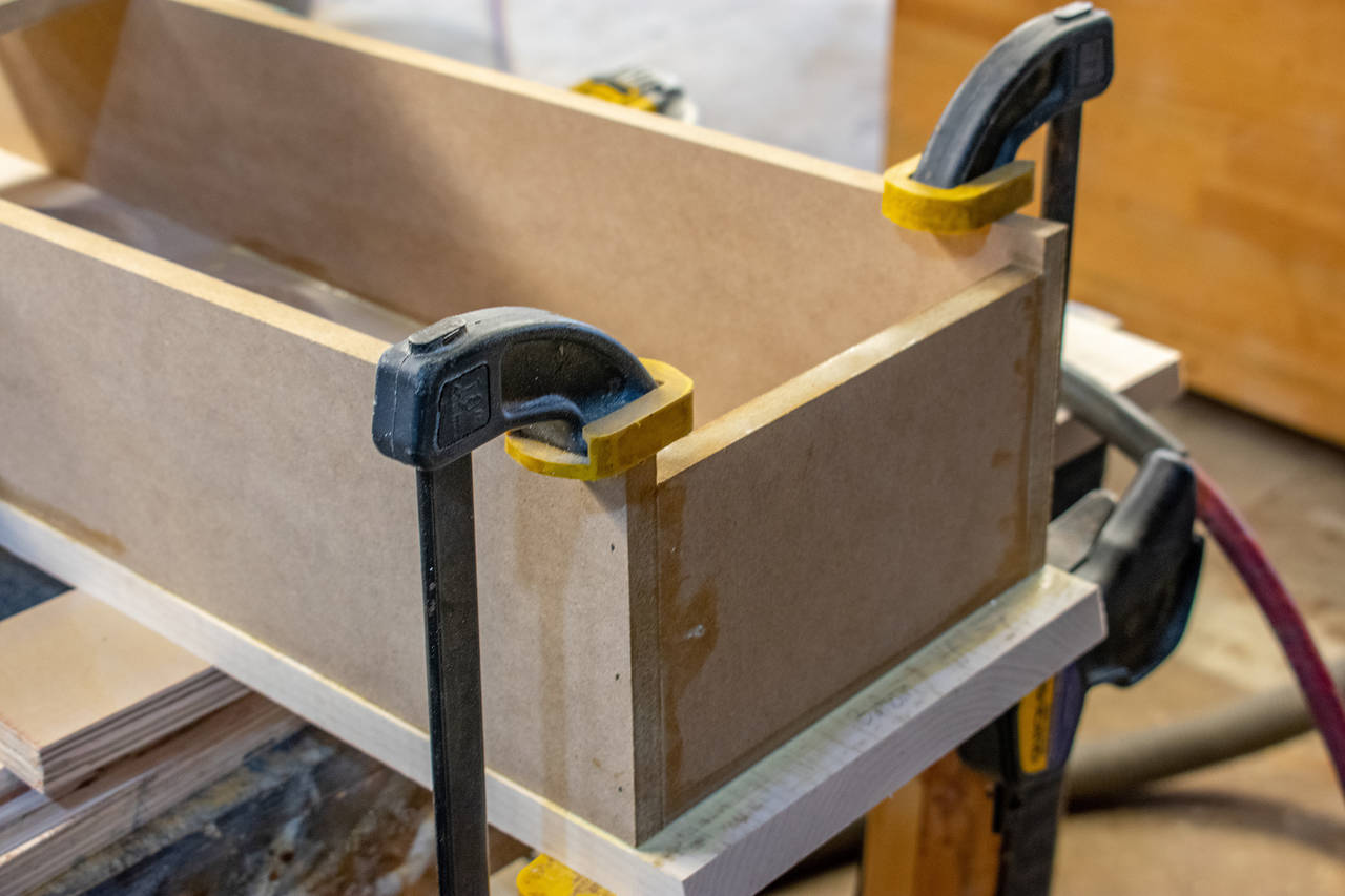

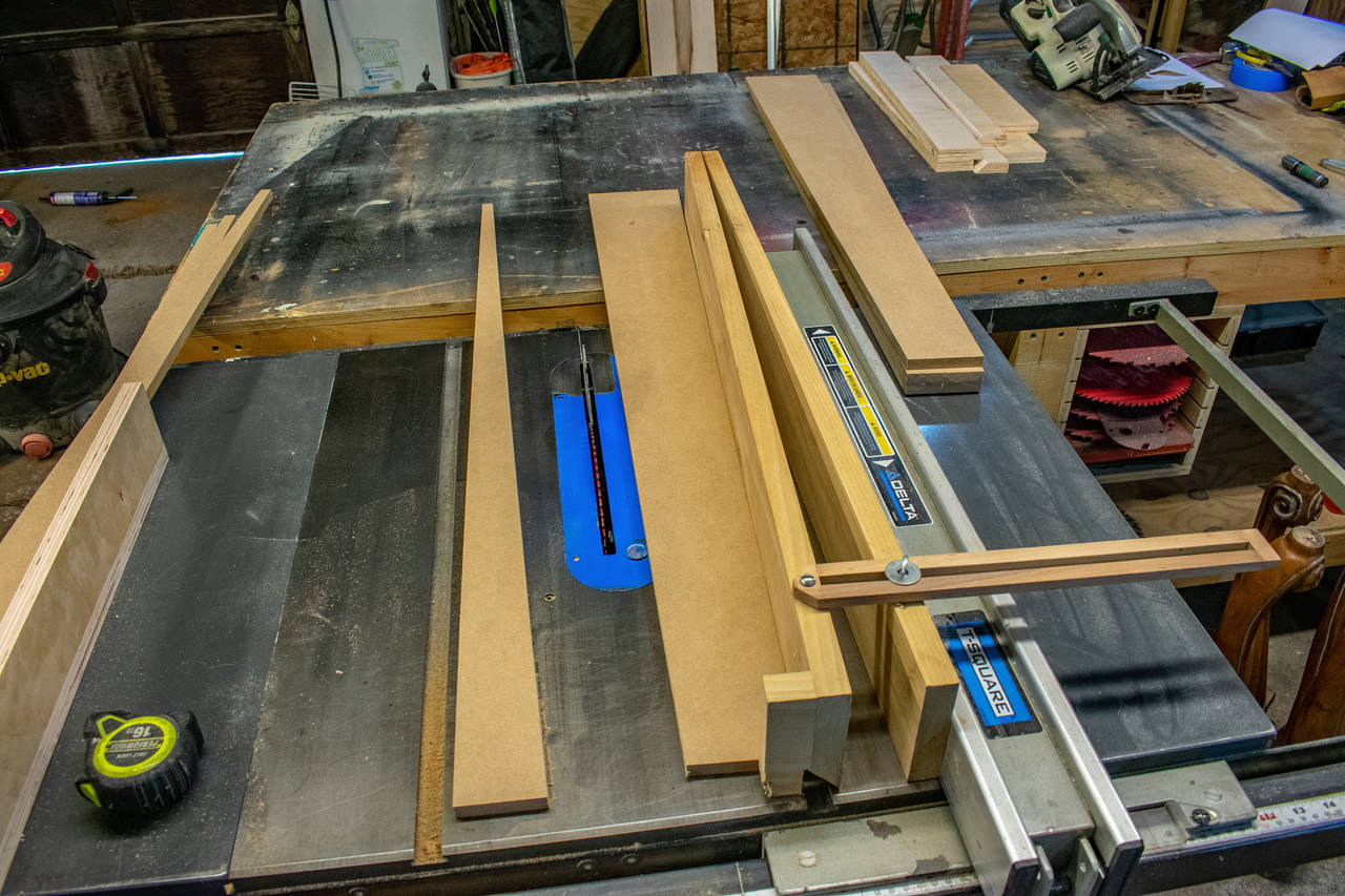

Boxes were 1/2" MDF(only because I was going to try my hand at veneering for the first time! I also got to use my homemade "taper jig". I found the plans for it somewhere on the internet, and for the 20 minutes it took to make, it has been exceedingly useful to me for repeating(safely) the same angle cuts repeatedly.

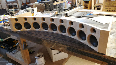

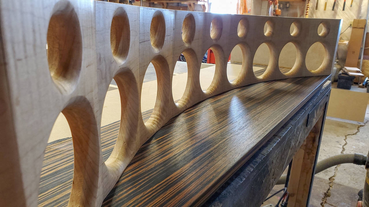

As the boxes on the THLAs were drying, I went to work on the box for the Curved SLA.

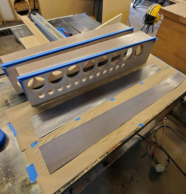

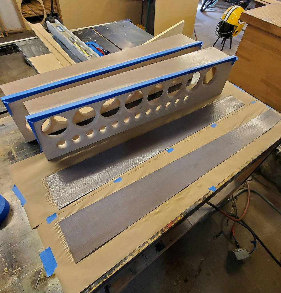

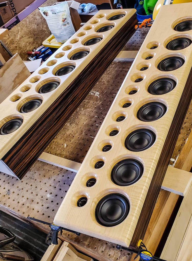

Once the glue was dry on the TLAHs - I took the plunge and applied the veneer! A little nerve wracking, but it all worked out ok.
I purposefully made the front baffle of the TLAHs about 1/8" wider than the boxes - hoping that the veneer would take up the rest of the room. Usually my plans fail miserably, but in this case I didn't even have to use a flush trim bit!! It's the little victories!
I used a mechanical center punch to mark the driver mounting holes....all 232 of them. Then used some blue tape as a "depth-stop" on a drill bit to pre-drill all the mounting holes.....super fun!

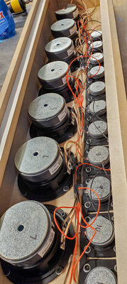

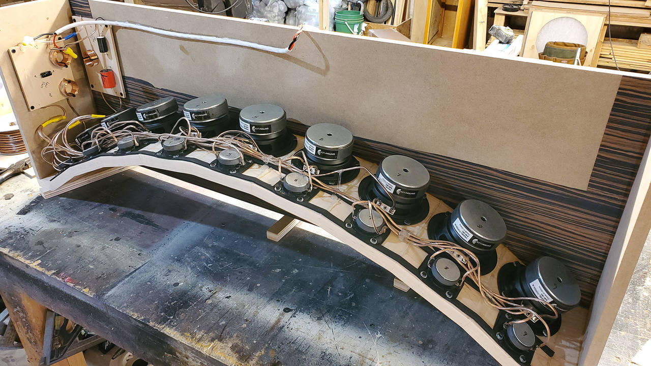

All the drivers were mounted(with speaker gasket tape from P.E. between the driver and the baffle) so that the miles of wiring could commence!

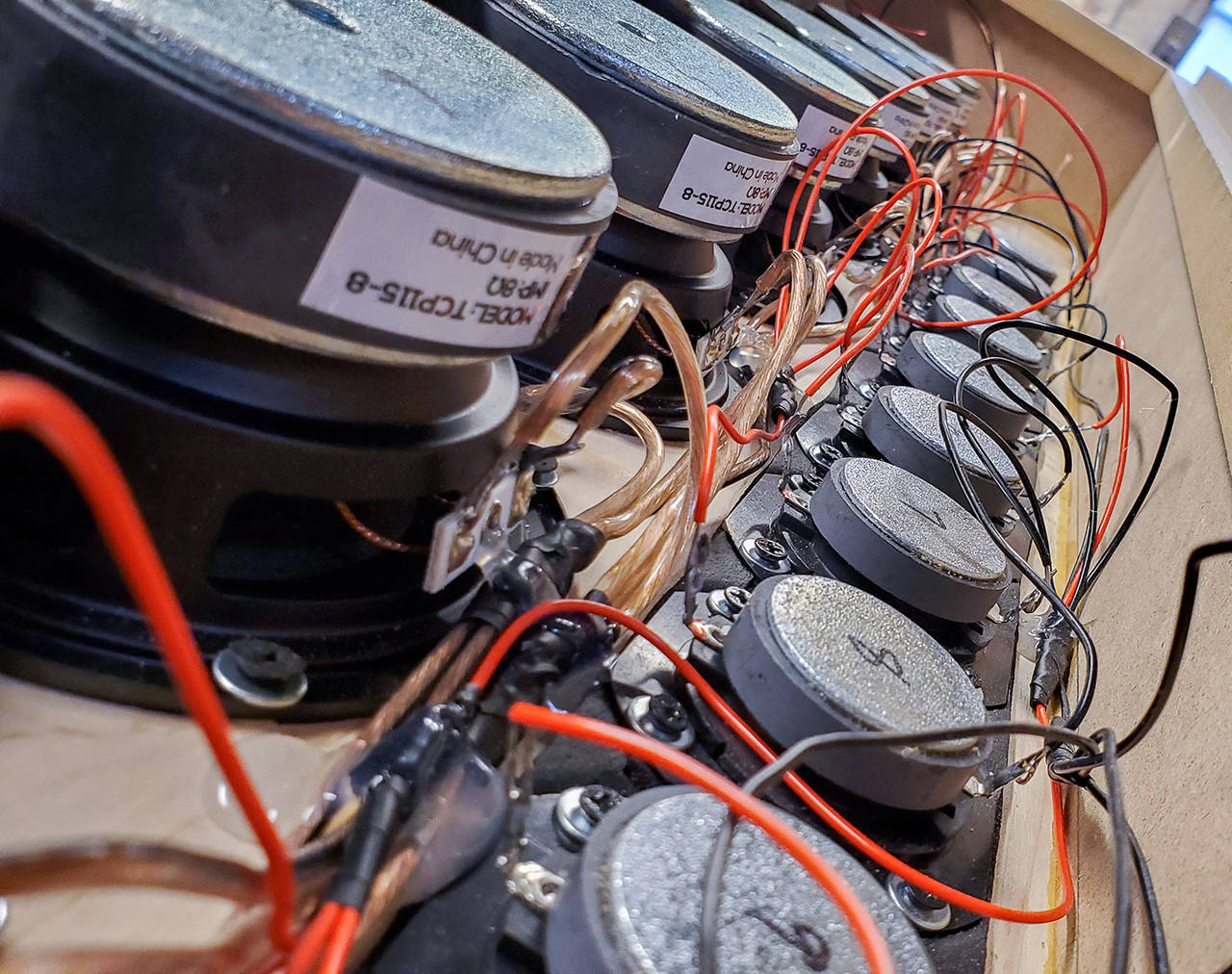

....and commence it did!

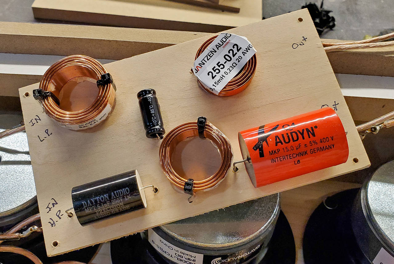

My first attempt at a crossover. All soldering was done on the back of the board, and it was mounted with #6 wood screws and small washers(between the box and the crossover board) as "stand-offs". Hope it's up to muster!
I actually made the crossover boards for the SLA first, and mounted the LP and HP to separate boards(for some reason), as you can see in the above pic. To save space in the TLAHs, I used 1 board and liked the look of that much better.

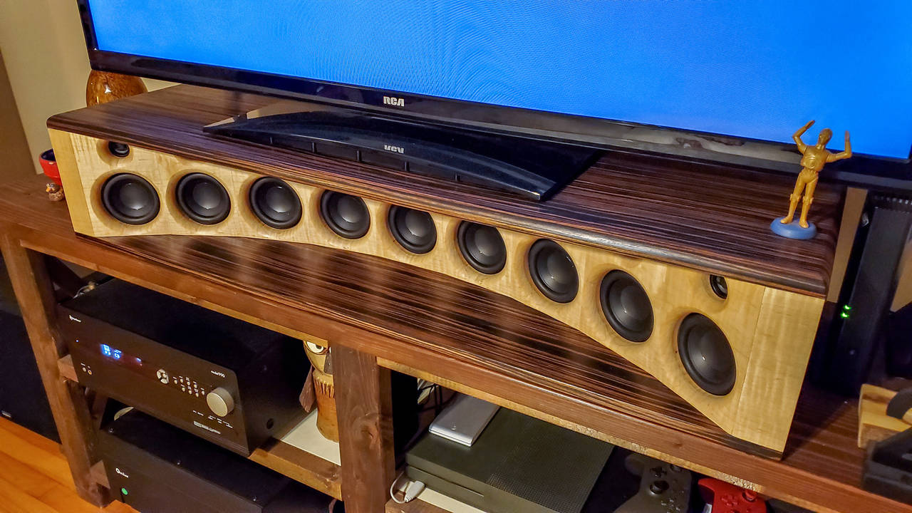

All said- the build took a little longer than I thought it would, but I was really taking my time to get everything perfect. I was going to do black duratex or something similar, and my lady-friend said that if they are gonna be seen...."Shouldn't they be beautiful?".....so she picked out Curly Maple for the baffles and some gorgeous(yet expensive!) Ebony veneer for the boxes. I think they look great!

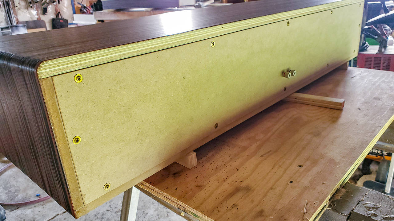

The party is all up front on these babes..... only satin-nickel finished binding posts from P.E. reside on the back

With regard to putting the high and low pass filters on different boards, there are two reasons for that. One is to lessen the possibility of a wiring mistake. The other is to insure that there's no cross talk between the inductors of the respective filters. If you do put both on the same board they should be separated as far as possible and mounted on different planes.
Ahhhh. That makes sense. With this new knowledge- I will be making adjustments to the boards(separating them). Thanks Bill! I love the look of all of them together, and the efficiency is crazy! Definitely a great match to the THT! It's official that I now have the "diy bug" and will be getting ready to plan/build the 2 surrounds and 2 atmos speakers that I want.....and maybe another THT!
