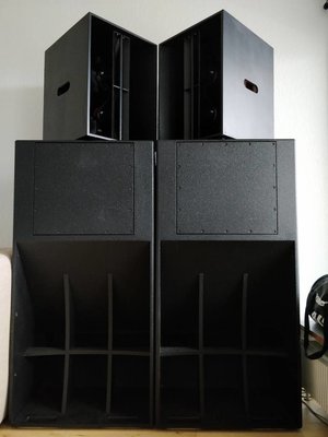

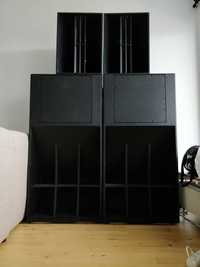

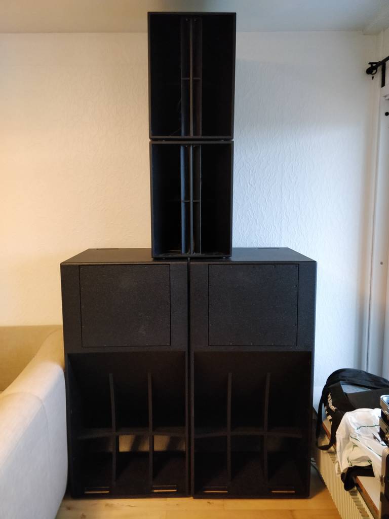

Hello guys,
Story short: we're gonna do an outdoor party where we can't use the speaker stands for the top speakers - don't trust them on the underlay as it's in the forest.
Therefore I've tried various setups to find the "best" solution for this party. It's only about 100 people and we won't blast anything near war volume.
The setups I've tried so far:
Cross firing tops:
Cluster tops:
Line array tops:
My favourite was the cross firing setup. The dispersion is just unreal. I tried it in stereo, and it sounded great - probably just reflections from the room, so won't work outside?
Cluster is just no way and the line array in mono sounded empty compared to the cross firing in stereo. Maybe it's just indoor dynamics?
What do you prefer to do in such situations? I'd prefer to spread out the tops, but it's not really an option this time.
Also the subs will just be side stacked like in the pictures, as we won't need the power of the V-plate - and it's probably safer to have an "acoustic limiter" in regards of noise compliants.. :D also it's quite aesthetic and practical in this setup..
Also we're gonna raise the tops 30cm with some boxes and then strap it all together.
Btw, this is our living room setup. On 3rd floor. And yes, we get a lot of complaints :fruit:
Thanks in advance.

the vertical stack is going to have extremely,extremely narrow vertical hf coverage, but if aimed correctly would work the best. side by side is going to have horrible combflitering in the horizontal axis, so do not do that... crossfire, i have no idea but i imagine there is going to be a lot of comb filtering with that as well as you walk around... so i would avoid
If you need wider horizontal coverage then one cab can provide, then splay the tops outwards at their -6db points, otherwise stack them and spend some time with the correct angle to have the hf end up right where you need it vertically. my guess is if you angle them a few degrees downward, you'll be in a great spot 70ft out or so. bonus is as you get closer to the stacks, you'll walk out of the hf coverage, and it wont kill people up close... also if you don't need the headroom or a wider horizontal dispersion. and want to retain more vertical covrage. use one top...

nick mineau wrote: Tue Aug 20, 2019 2:22 pm crossfire, i have no idea but i imagine there is going to be a lot of comb filtering with that as well as you walk around... so i would avoid
If you absolutely can't go vertical, go crossfire.

What about the "line array" option but with the top cab very slightly rotated (to avoid the stack falling over or the top cab falling off) with the diffuser rods on axis? Or maybe some sort of swivelling HF horn if the tops and bottoms aren't permanently glued in place (in my cabs they are affixed with two screws a side but one bolt going into the diffuser rod each side would allow me to swivel if I wanted a wide dispersion 2 stack.

That's called a spiral array, and it is an option, if correctly implemented.

I've experimented with spiral arrays and they do provide very even coverage but can be unsafe to rig.
