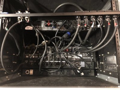

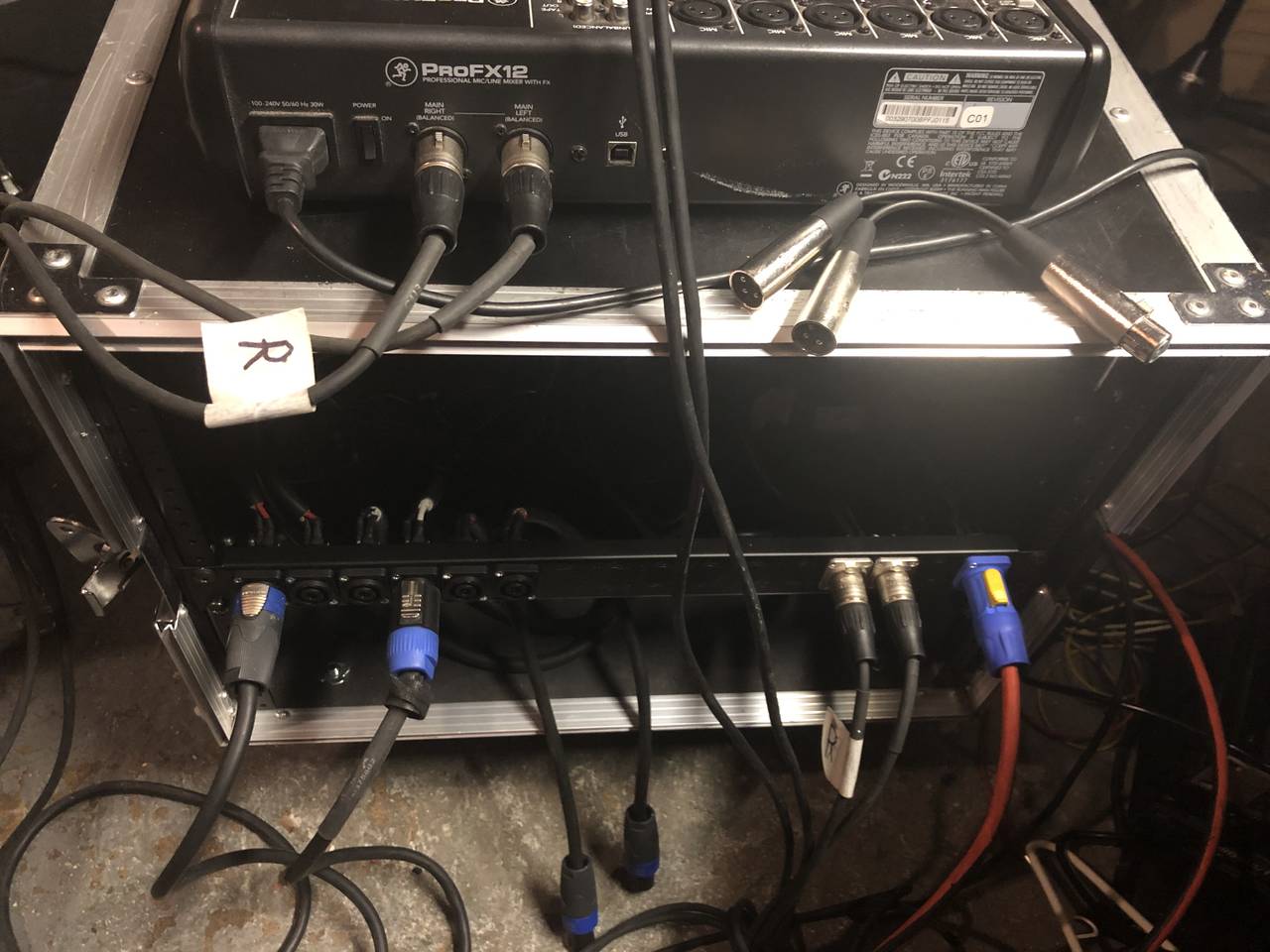

I recently ran across a great deal ($75) on a Road Ready 8 space amp rack which I have already built a caster board for since I had 4 heavy duty casters laying around.
I also installed a break out panel on the rear for quick connections.My questions are:

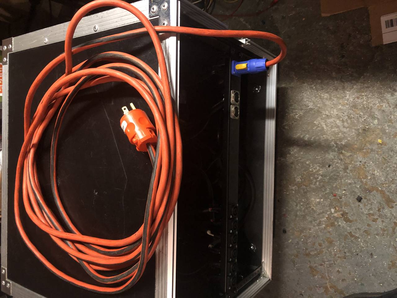

1) I built a Neutrik power connection on the break out panel and I made the cord about 20 feet long,will that cause a problem ?
2) should I make that cord shorter ?
3) there will be times when I will be running 8 subs and will be putting another QSC GX7 in the rack (the loose Neutriks at the bottom of the rack are for that amp,already connected to the panel.
Should I use a signal from my empty #5 and #6 outputs on my DCX2496 or can I use a splitter like the one near my mixer in the picture and share that signal with both sub amps ? Any pros or cons ?

My power cable to my rack is 25ft. So, no problemdjtrumptight wrote: ↑Wed Jun 26, 2019 9:47 pm Also,can I safely run 3 amps from the same power conditioner ?
I run 5 power amps in my rack off of one Furman. So, no problem with 3 GX7s.
To daisy-chain those amps, just build or buy a TRS to TRS 1/4" cable to run between the two. The 1/4" and XLR on those amps are parallel. So, no problem....

Thanks Bruce,so the XLR splitters in the last picture I posted wouldn’t work to split the signal between the 2 amps ?

I didn't see that in the picture....djtrumptight wrote: ↑Thu Jun 27, 2019 11:15 am Thanks Bruce,so the XLR splitters in the last picture I posted wouldn’t work to split the signal between the 2 amps ?
They work, but then you are sunk if you want to add another amp to the chain. Most of those are built with crappy connectors and have lousy strain relief.....but, strain relief really shouldn't be an issue in this case.
So, fire away! If you add another amp at some point, you can address it then... I run three amps for my subs, so the first one gets the xlr, then the other two are chained with the TRS to TRS....hand built with Neutrik connectors.....just cuz I'm kinda' anal.....
And my stuff don't break!

I run my subs off of just 1 channel on the processor. Reason being is that if you want to make any changes you only have to do it in one place, not 4. Save the extra channels for when you need to add a fill speaker or something. Use the splitters like you have or Bruce's idea with 1/4. Doesn't matter how you daisy chain the amps as long as it works.djtrumptight wrote: ↑Wed Jun 26, 2019 9:44 pm Should I use a signal from my empty #5 and #6 outputs on my DCX2496 or can I use a splitter like the one near my mixer in the picture and share that signal with both sub amps ? Any pros or cons ?

I like to label my breakout panel L/R. etc on the top lip. Makes hookups brainless especially if you are reaching from the front and are looking at it backwards.
Unless you need the visibility, go get yourself some black 12/3 sjoow cord. I have a strict "no orange or yellow cords" on the stage policy.
*** I should add that in the US for stage use, code does technically specify that all cords on the ground be SOOW (a heavier duty version of SJOOW). It takes some persuasion, but 12/3 soow will fit the blue powercon. 14/3 is also acceptable for 15 amp circuits.

I actually got dinged by a fire marshal who said that Orange cords are for 'temporary emergency usage only'.CoronaOperator wrote: ↑Thu Jun 27, 2019 4:46 pm Unless you need the visibility, go get yourself some black 12/3 sjoow cord. I have a strict "no orange or yellow cords" on the stage policy.
I do everything in my power to avoid orange cords. In this case, I had used all of my available black cords and used one orange cord to run a short LED light chain.
Fire marshal was cool, I explained I was out of my handwired black cords. He said it was good for the night, but he didn't want to see them any more if I could help it.
Years later, I joined a church that wired EVERYTHING with orange cords...projectors/lights on ceiling, all stage/video/audio, etc. Made my eye twitch, LOL. Took me 2.5 years to get rid of them all.

Orange cords are like neon lights to marshals that say "come inspect me!" You could technically use any color you want if they make it but it has to be the right type and have the ul listed writing right on the cord saying what it is: Although the NEC (national electrical code) says you have to use extra hard usage cord (SOOW) for anything over 6 feet for what we do (sjoow is okay for under 6 foot runs), the code itself isn't legally binding by itself, final say comes from your AHJ (authority having jusisdition). Your AHJ could be a fire marshal, electrical inspector or anyone else that has the authority where you live over your wiring practices. "Most" inspectors would be completely fine with SJOOW for our size shows, especially if routed away from vehicle and foot traffic. Only way to be absolutely sure is to call and ask. SOOW cord is heavy, expensive, takes up too much space and is a pain to use, it's like wrestling lead garden hose.
