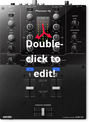

If you are using a DJ mixer to play music you can do the same thing (less the vocal effects) by manually turning down the mids outlined in red while you speak. If you are speaking on behalf of another DJ and don't want to reach over him while he plays, then put the outputs of his mixer into the inputs another mixer off to the side and do the same thing.

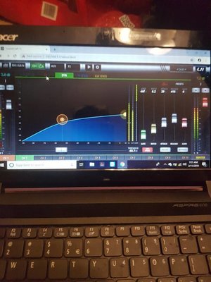

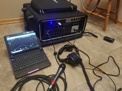

So I did a little experiment on my UI-16. It doesn't have sidechain ducking like the x-air's do but I just muted the second channel manually to prove the concept.
Here was my setup: Headphones, mic, UI-16, and cellphone for music off of youtube

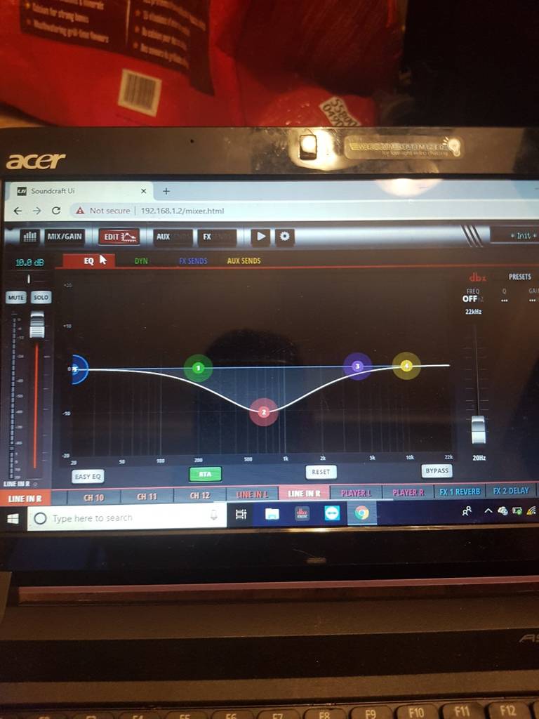

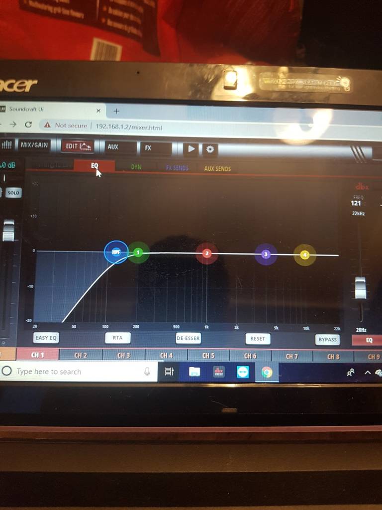

I played with EQ cuts to the music channel to find the freq slot that matched my voice. Then played with vocal mic compression, attack, release rates, high cut and level to fill the hole I just made in the music.
I then duplicated the music channel and carved out the opposite of what I cut and added that back in. Then I just muted that channel when I spoke on the mic to simulate a sidechain ducking compressor.
Here is my mic high pass: ...and as predicted, I had to use HEAVY compression to be heard without raising the overall sound level: Here was the cut to the music channel to make a slot that fit my voice: Here was the duplicate channel to replace that cut mixed over top: Now I just played music and when I spoke I just muted manually the duplicate channel with the mid boost. A ducker would be MUCH Much smoother as you can adjust the attack/release times (fadeout and back in) to be much more seamless.
Here is the result:
http://s000.tinyupload.com/index.php?fi ... 4106894758
It recorded very quiet so I used audacity to give a 30db boost to the recording so that might affect the noisefloor some but I think the results were good and the concept sound.
