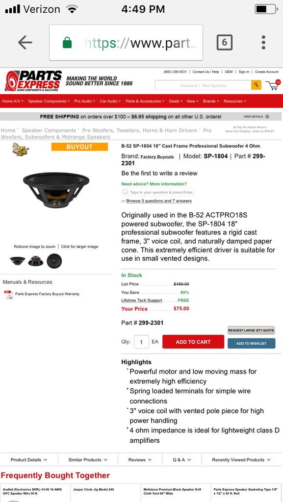

I came here 2 years ago looking for: best bang for the buck, DIY or die, underground audio solutions and philosophy. I found it. What does that mean exactly.
Well today if I were to try to build on my own a portable sound system what would I do on my own. I would shop for gear and research right. I find these buyouts at a smoking price. They seem to be a great solution let’s model them best I can.

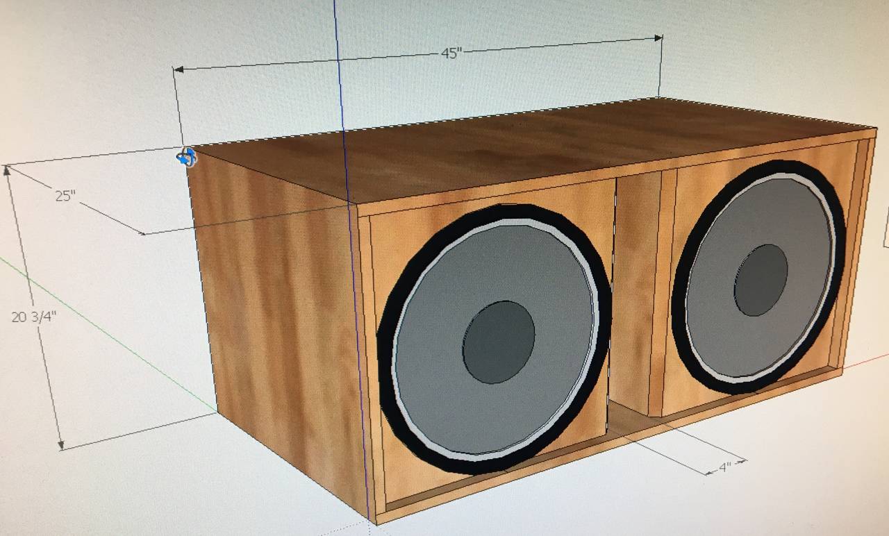

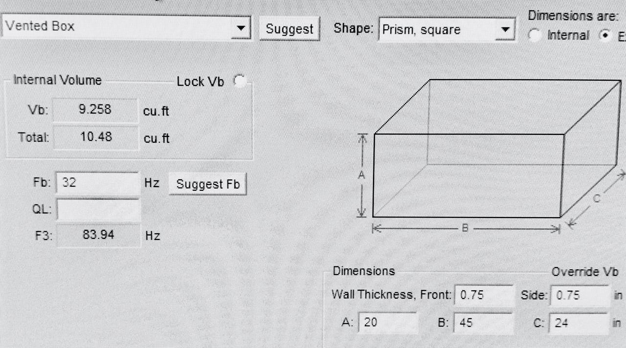

Next I would design an enclosure and if the combination suits my goals/needs then I’m done. I like the price and way that two of these subs models with my program.
This cabinet is pretty close to a tuba45 in its dimensions!!! It’s output aka spl and frequency is pretty similar to a tuba45 cab as well at least it models that way. The dual b-52 18” cab requires 1100w where the tuba45 needs 300w.

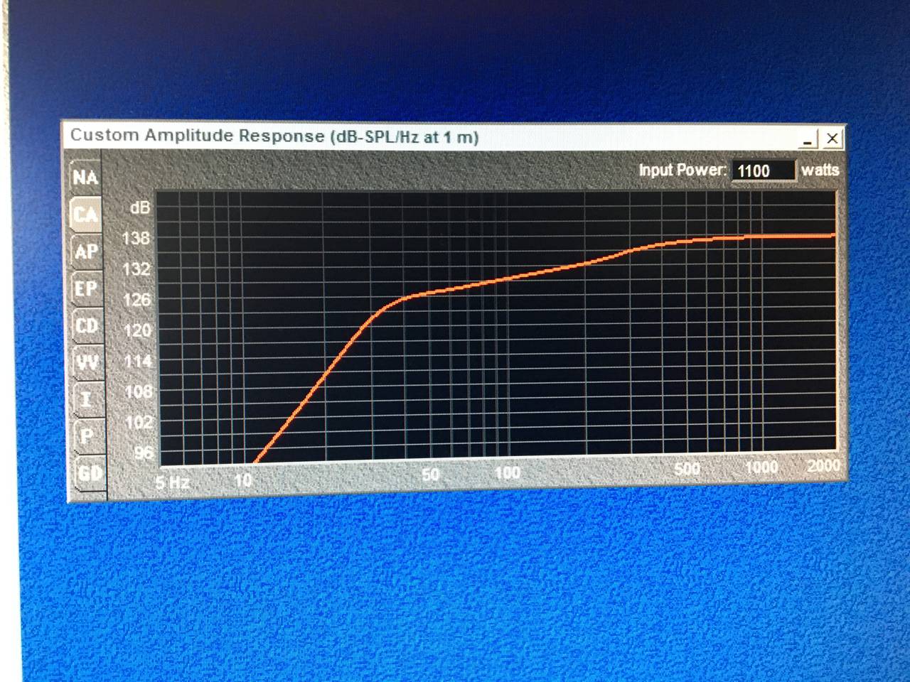

It maps like it will play within max Xmax to 35hz at full power what do I know like I said if I was on my own this is best I can do on budget.
