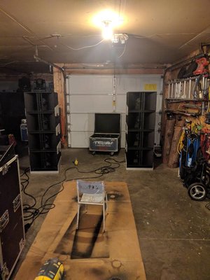

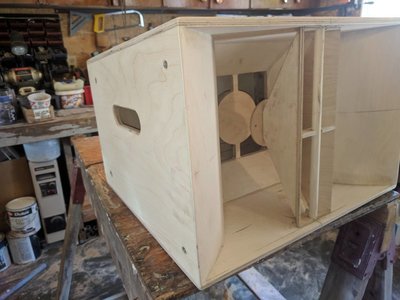

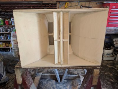

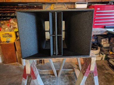

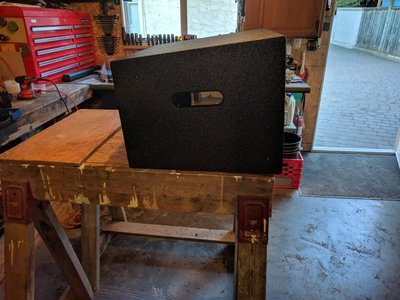

Well it only took 7 months of build 1 day a week because its all i had time for. They are finally done.
I Took all of bills plans and transposed into AutoCAD and hand all thr ply cut at a cabinet shop and upgraded the upper and lower stack bracket cut from 6061-T6 Aluminum at a local water jet shop. I had the coating done at shop that sprays a lineX comparable product. I had other speakers done with duratex but imo thr lineX product is far superior.
I used Deltalite 2512 and Faital HF108s. Could not be happier with the sound quality on these.
8 x J-Array Adventure.

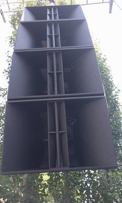

He's holding out on us some of the real speaker porn pictures:
Srry PrismAudio, this one was too good not to share
Re: 8 x J-Array Adventure.
Frankly that scares the #### out of me.CoronaOperator wrote: ↑Sat Jun 16, 2018 5:13 pm He's holding out on us some of the real speaker porn pictures:
Sorry PrismAudio, this one was too good not to share
PrismAudio, I hope you've explored Canadian law and flying cabs.
Bill has always said any of his designs are not to rely on the structural integrity of the cab to fly them, and that each cab should be wholly enclosed in an approved structure (signed off by a structural engineer).
Maaaate, if that falls down, it's all on you...
