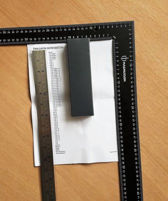

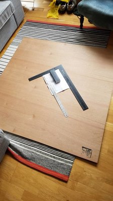

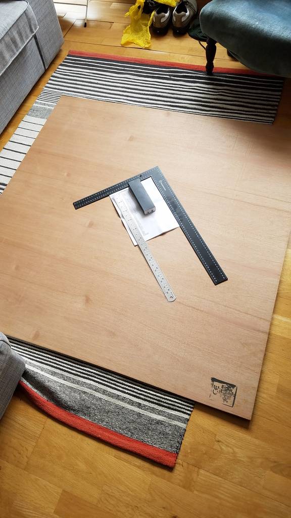

Trusty cutlist created, thanks to - http://delphiforfun.org/programs/cutlist.htm
*Part dimensions covered to protect IP
I had the timber yard cut all 6 4'x8' panels to a manageable 4'x4' so 12 panels total. Time to get busy with marking up for cutting!

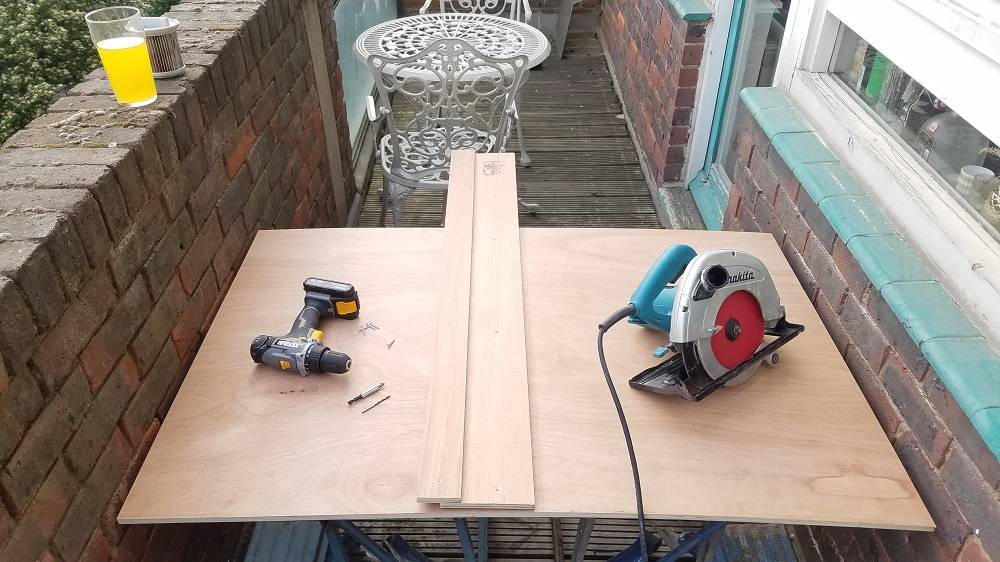

It has been a lovely weekend here in London and I have managed to make a good dent in all the cutting!
I have to say cutting 48" wide panels on a 50" wide balcony is a little snug..

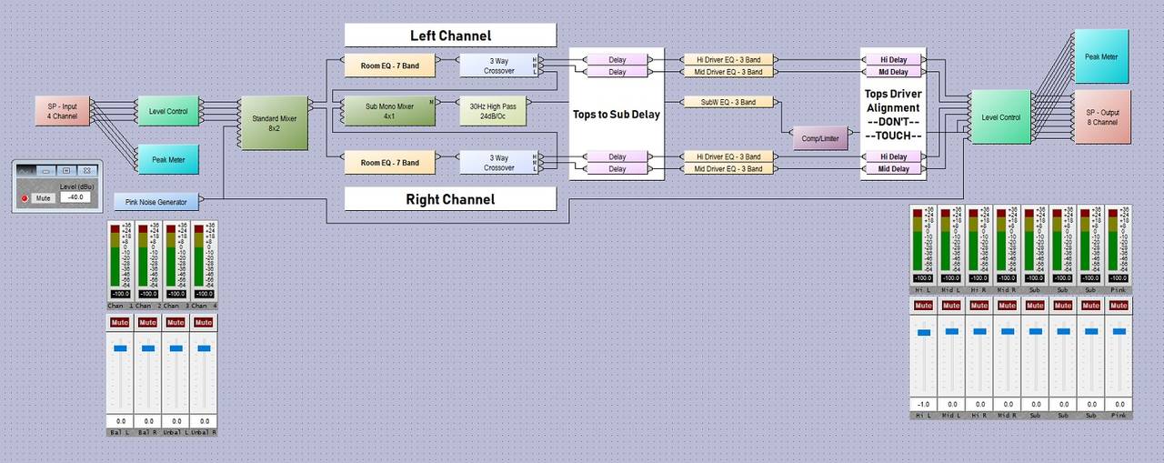

This evening I have been setting up my loudspeaker management for how I want to use the system. The setup below adds EQ and delay on the right for EQing and time aligning the individual drive units in the OT12's. There is a delay section to match the tops to the subs and the 7 band PEQ's on the left are used to tune the system to the room. Last of note is that I have set up the pink noise to have its own output as well as running through the signal chain. This will allow me to feed the noise back into my laptop and use it as a reference signal to do system tuning with SysTune Pro. Brick wall limiters will be set for driver protection on the NZA4-400.
Man, I've got to say kudos to you guys building cabs without a a workshop and lots of tools.
Alex
AFAIK, using EQ post crossover alters phase. So I guess you need to ignore the EQ capability on the right for the individual component drivers.
Or, if you alter EQ post crossover, go back and check phase at the crossover point(s).
Setting delay is also going to alter phase, and since delay is also post crossover, again check phase at the crossover point after altering delay.
Checking your system phase at the crossover point is absolutely essential.
You may have to mess with it a bit, but setting your EQ on the left (pre crossover) will eliminate most of the "issues" as I described above, other than if you add delay...

Hi Grant,
My thinking was i would start by EQing(outside open space)the individual OT12 drivers then set their delay/phase to each other(using SysTune), EQ the sub in the same way with ground plane measurements. Once those were set lock them so they dont change when visiting different venues. Then when i arrive at each venue I setup the speakers and using SysTune I align the tops to the subs(delay/phase) then use the room EQs to tune the whole system to the room/venue.
I am by no means an expert and this knowledge has come from learning on the internet so may well be floored, having explained it do you think it will work as intended?
Thank you for your help!
Alex
My thoughts:
Phase is frequency dependent. Therefore, the only delay you can add is at a crossover point (subs to tops), so you can then check phase response (unless you want to go to FIR filtering).
Subs and tops need to be in phase at the crossover point. Mids and HF need to be in phase at their crossover point.
Personally I think it's almost redundant to setup delay for drivers in tops (ie between mid and HF) because there will be about 1 maybe 2msec in that setting and we simply can't tell that small a difference when applied. By all means play with it though.
I would be more inclined to save a 7 band PEQ (left on your flow chart) for subs and tops as a system save, and tweak it at each venue.
This is what I do, but with GEQ.
Mirror imaging an SPL chart is a great way to get a start point for EQ...
