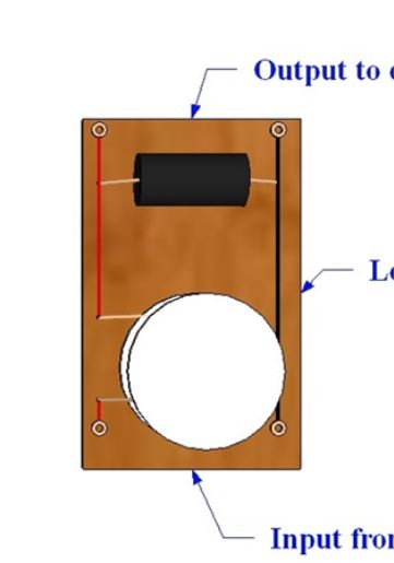

So... first thing i'm not sure... what is this circle hole from the simplex 12 build document?
It's the paid plans... i posted a small picture, don't want to post this stuff as free as little as possible, let me know if it's not accepted here.

Electric Wisdom wrote: Fri Mar 02, 2018 6:36 pm So... first thing i'm not sure... what is this circle hole from the simplex 12 build document?
It's an inductor

Grant Bunter wrote: Fri Mar 02, 2018 8:18 pm
It's an inductor
Ohhh thanks :) haha
