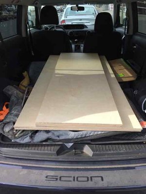

Started building my second round of T30's that will be a bit smaller than my original 28" ones. This pair will be at 21 inches to better fit in my car. Putting matching Lab12's in them. Can't wait for the drivers to arrive...
