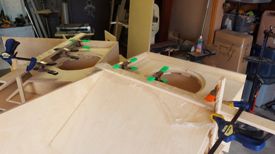

Day one effort - woohooo panel 1 installed! No braces are shown since I took the pic after PL was cured. All panels were screwed in place using panel screws from Leland. They seem to work quite a bit better than drywall screws.

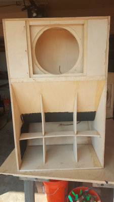

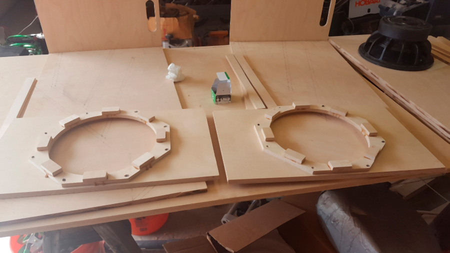

Day 2 - Panel 2 (the baffle) takes a lot of time between cutting driver hole, driver anchor, and those little driver anchor blocks.
Day 3 was getting panel 2 and driver reducers installed. Also spent some time on the OTop12s.

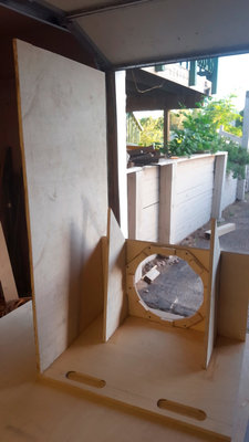

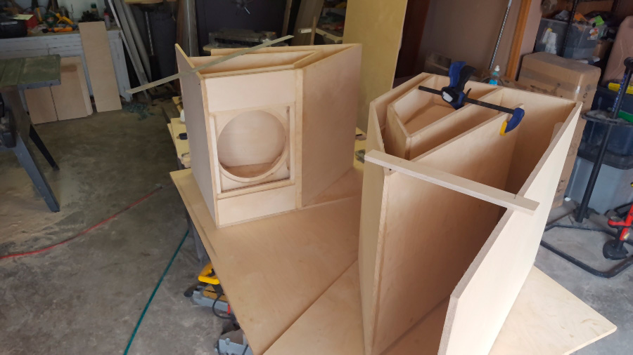

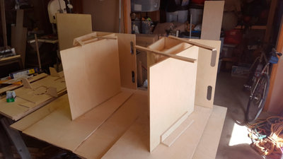

Day 4 I managed to install panels 3, 4, and 5. All went smoothly. Glue, screw, and shoot some brads makes it go quick.
Also spent some more time on the OTops.
Day 5 was the install of the panel 3/5 brace. Man those things are a PITA to get in without getting PL everywhere. The glue is not noticeable in this pic since I scraped out the mess. I actually had to go back later and add more glue to the brace on one of the cabs since it was everywhere besides where it was supposed to be!
I also installed panel 6 and panel 6 extension.
Panel 6 extension was a little tricky until I figured out the right clamping configuration. Always looks easier once you figure it out.

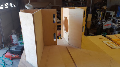

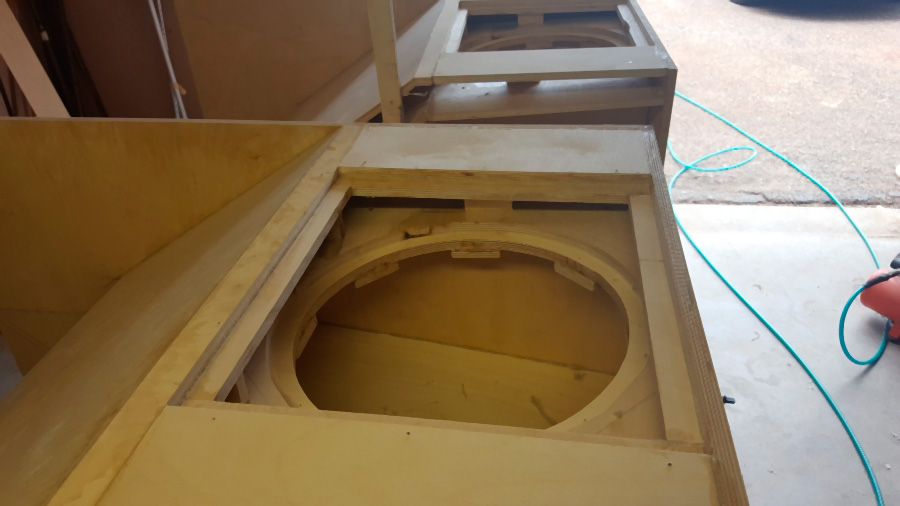

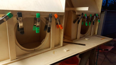

Oh yeah - day 5 was a long day. After dinner I went out and installed the vertical and bottom horizontal flanges on the driver opening.
Figured I'd wait on gluing in the top horizontal brace until I checked the driver fit.
Day 6 I glued in the flange braces - another gooey, gluey mess but there in there solid.

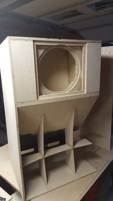

Here's the obligatory photo of the beautiful internals of these babies:

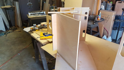

Day 7 was panel 8 (the back) install.
Gluing those big panels in place is scary for some reason. I lucked out and did not have any major panel warping that was not easily corrected with screws and limited braces.

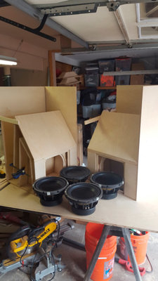

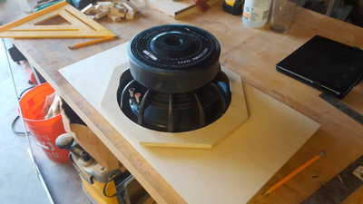

Another obligatory photo of the pack of drivers:

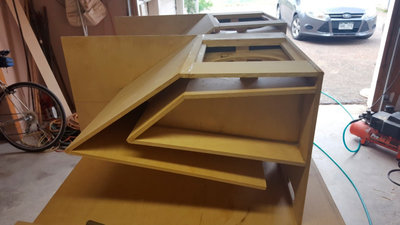

Day 8 was the big panel 6/10 brace install. I just had to do the swoopy thing with them.
