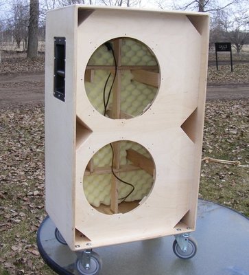

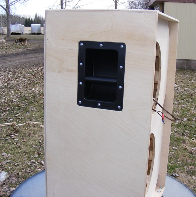

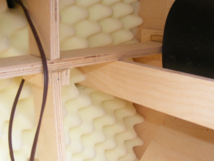

Here's some photos of my 212 box before I close it up. I made a few minor modifications with the bracing. Because the center of balance location for the scoop handles interfered with the upper cross brace, I had to move that one back a little, requiring a slightly angled vertical brace tying the two horizontal braces together.

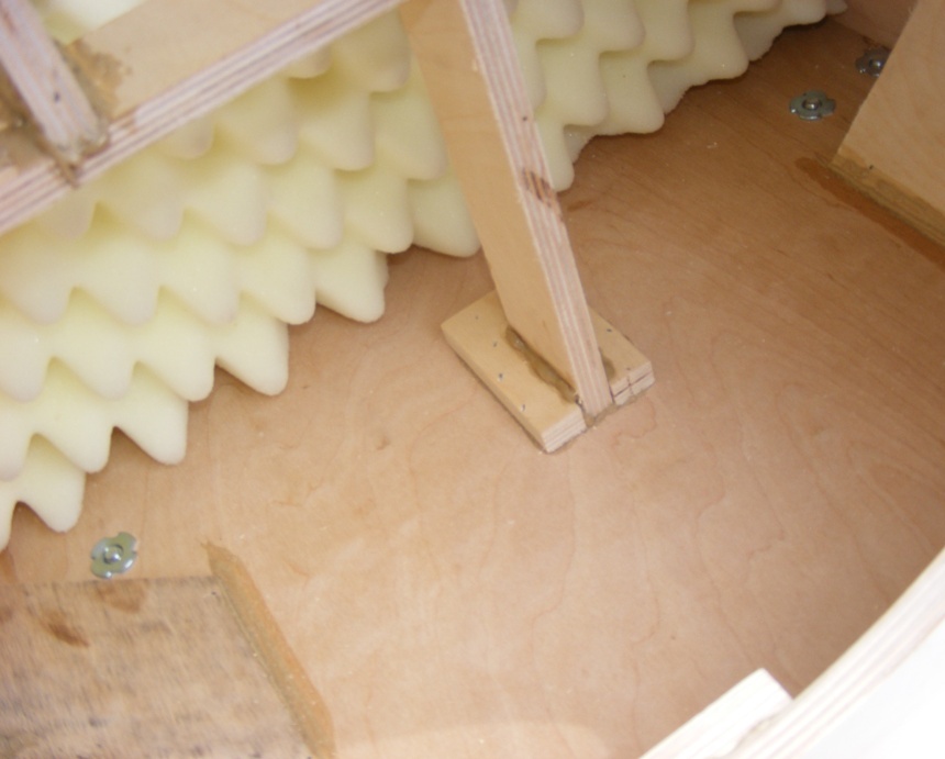

Also, I made some little U shaped blocks to glue the braces against the sides of the box. These increase the gluing surface area greatly and eliminate the need to nail them in from the exterior side of the cabinet; fewer nail holes to fill.
I also increased the setback for the baffle board from 1 inch to 1-1/2 inches to allow a little more protection for the grills when they get installed; to accommodate this, I increased the width of the side panels, top and bottom panels to 15 inches.

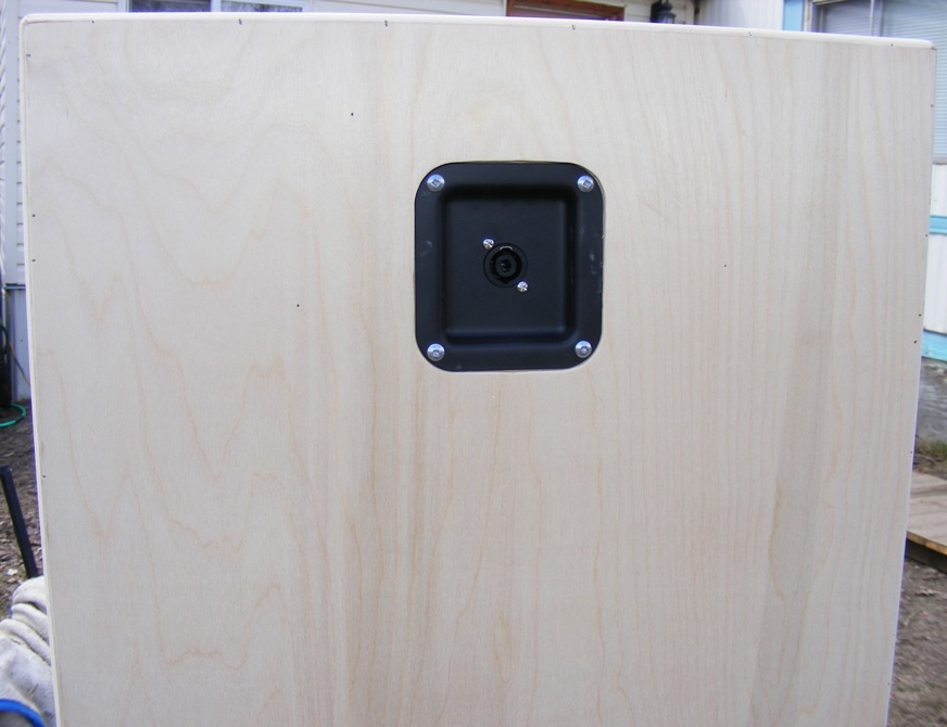

Once the varnish is completed, I'll seal up the handles and jack plate. I'm not entirely convinced the supplied rear gasket on the speakers are effectively sealing; I might run a thin bead of DAP on the gasket to augment the gasket seal.

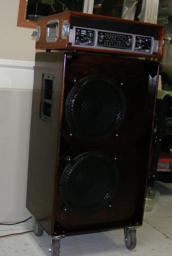

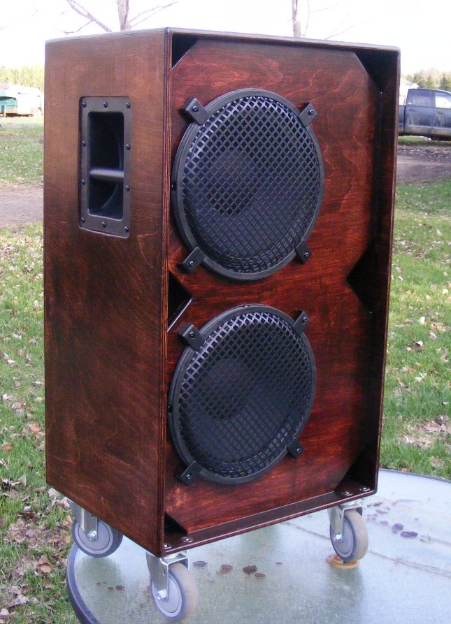

All done.
Just have to get a slip cover made for it.

Thanks. I meant to stain it cherry, the same color as the amp rack, but I somehow grabbed the wrong can out of the cupboard. I realized something was amiss after I applied about a square foot on the baffle board, but at that point it was too late.
Oh well, I guess it offers some contrast.

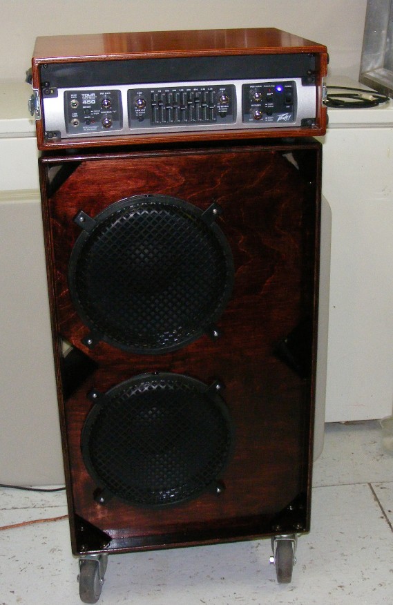

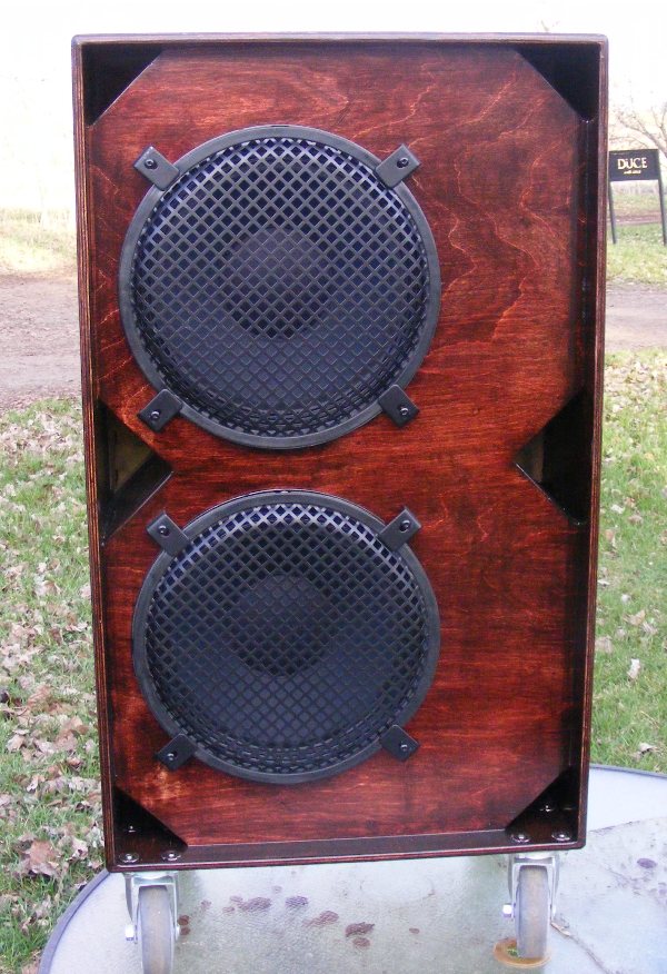

More photos with better lighting-

Vintage look, modern sound - fantastic.
