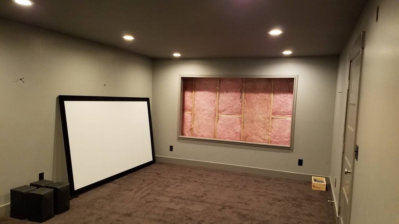

Sheet rocked, painted, carpet installed, screen installed... just a bunch of wiring and speaker/projector mounting to go... Getting close!!!

I began hanging speakers and placing the table tubas last night. This room is more difficult that I thought it would be. We tried multiple positions for the subs and the best so far is firing forward into the false wall at the front of the room. (I haven't tried the rear of the room yet.) I found the phase HAS to match, otherwise in position 2 (see pic) the bass sounds like a blown woofer - almost no bass at all. In this scenario (opposite phase) if you step into position 1 or 3 it sounds amazing. Once they are in the same phase position 2 sounds pretty good. Still a bit better in position 1 and 3 though. One interesting thing I found is the distance from the right and left walls seems critical. At first I had them about 6 inches away from the wall. Moving them within an inch from the wall made the most difference. (I left them about 6 inches away from the front wall.) I'm thinking the furniture will help and I plan on adding some bass traps, sound panels, etc. Just not sure where to start with those.

Most of the problem is the listening position. You're getting a cancellation null from the reflection off the rear wall meeting the original wave out of phase. That null will occur where the distance from the LP to the rear wall is 1/4 wavelength. I'd try placing the subs right behind the couch. Rear of room won't help, then you'll be getting the cancellation from the reflection off the front wall.
