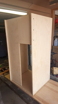

Started on my Tallboy this weekend.
For anybody else near Denver Colorado, I found Baltic Birch at Consolidated hardwoods for a decent price. 1/2 inch 5x5 was $45 a sheet.
Here's the basic cab shell:

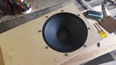

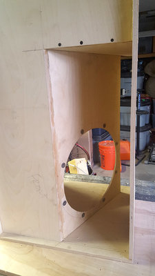

Baffle cut was made with a jigsaw (very slowly):
Baffle installed:
Everything is screwed and glued which helps assembly proceed without waiting for glue to dry. I'll most likely pull the screws when finished and fill with bondo before sanding everything.
When sitting on it's base there is a very minor wobble (bottom is not totally flat) I haven't decided if I should try to force it out using bar clamps or just make up for it when I install the feet. It's only about 1/8" off but it bugs me.

One thing I forgot to mention. In my excitement to get the woofer mounted on the baffle I forgot to epoxy the hurricane nuts. Is that going to cause problems for me?

jdmrivera wrote:One thing I forgot to mention. In my excitement to get the woofer mounted on the baffle I forgot to epoxy the hurricane nuts. Is that going to cause problems for me?
Don't know, but now's the time to go and fix it. Then you won't have to worry about it.
The problem with hurricane nuts is when they spin and you have no access to the other side like in the titan/tuba builds. On the tallboy you always have access to the back side.

jdmrivera wrote:Don't know, but now's the time to go and fix it. Then you won't have to worry about it.
Thanks. Does anybody have any neat tricks for getting them out and re-inserting without damaging the wood. I suppose I could insert a bolt and try to tap them out.
Don't even try. At this point, use 'em the way they are. As CO said, if you have to get to 'em at some point in the future, just take off the back.

Bruce Weldy wrote: Don't even try. At this point, use 'em the way they are. As CO said, if you have to get to 'em at some point in the future, just take off the back.
Well there ya go. Bad advice from me. :slap:
I would've inserted a bolt and tapped them out, but I trust Bruce to steer ya right. :cowboy: <- Texas smiley
