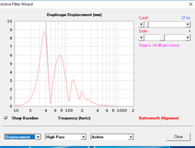

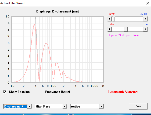

Hello, so I have a horn subwoofer question that has recently come up due to some measurements I've made with a horn loaded subwoofer I designed. Basically, beyond a certain input threshold the response from 40-50 hz sucks out (compresses) almost completely, as in more input = same output. The enclosure corner frequency (length of horn) is approximately 38 and the pressure peak is centered at 40 Hz (which correlates to the maximum mouth velocity). At the level that it is compressing the pressure is relatively low (simulation says 4.6 kPa throat side, 2.5 kPa differential). Throat velocity is less than 7 m/s and exit around 4 m/s at this point. I'm at a loss as to what is causing this acoustic phenomena and was wondering if anyone else had encountered this. For the record the rest of the passband more or less doesn't compress all the way to full power, including the upper air velocity peak at 85 Hz.
Is there standing wave behavior in play and if so is there something I can do in the design to mitigate or avoid this problem? Also, any help into how I can simulate this phenomena would be appreciated. I'm considering learning how to input the design into ABEC to try and understand it better but that will take some time.
Edit: Note this cabinet has a compression ratio of 2.4~ and uses a 15 inch transducer in a front loaded horn configuration

Driver excursion at the frequencies i'm talking about is close to a minima, and well within the linear region of the driver (15mm 10% BL distortion). Onset of compression happens around 50V, measurements were taken with highpass set as shown in sim. The driver can handle 110V thermal for 2 hr in free air, I'd suspect it will do 100V sustained in cabinet, excursion with highpass it should be fine to 120V.

According to the sim that shouldn't be the case, not even close, excursion should be within klippel XMAX to full output.Bill Fitzmaurice wrote:The driver has reached xmax.MissileCrisis wrote:beyond a certain input threshold the response from 40-50 hz sucks out (compresses) almost completely, as in more input = same output.

I know the excursion isn't the problem because it is reflected in the distortion (mimimum distortion point near minimum excursion point at ~43 hz). What I can't simulate is the non-linearity of the air and the increased mechanical load caused by the fold of the cabinet. I believe it to be a fluid dynamics problem. I did step up impedance measurements today and the notable effect of increasing input voltage is the lower resonance peak (35 Hz) decreases in magnitude progressively. the upper peaks remain basically the same and the impedance minimum rises and falls based on level (heating of the voicecoil). I'll grab the data tomorrow.Radian wrote:Then what's the problem? If the sim has all the answers, what does the real world matter?MissileCrisis wrote: According to the sim that shouldn't be the case, not even close, excursion should be within klippel XMAX to full output.

your previous graph displays excursion minima at 49hz. what is sd and mms of driver. full t/s parameters would possibly be helpful. driver may be unsuitable for horn loading. higher voltage distortion measurements may reveal the answer, but I would measure a 2.83v response curve, and another response curve at the highest voltage you are comfortable measuring at (reposition microphone at a distance that will maintain the same magnitude measured). graph the difference between these 2 measurements for your compression graph.MissileCrisis wrote:I know the excursion isn't the problem because it is reflected in the distortion (mimimum distortion point near minimum excursion point at ~43 hz). What I can't simulate is the non-linearity of the air and the increased mechanical load caused by the fold of the cabinet. I believe it to be a fluid dynamics problem. I did step up impedance measurements today and the notable effect of increasing input voltage is the lower resonance peak (35 Hz) decreases in magnitude progressively. the upper peaks remain basically the same and the impedance minimum rises and falls based on level (heating of the voicecoil). I'll grab the data tomorrow.Radian wrote:Then what's the problem? If the sim has all the answers, what does the real world matter?MissileCrisis wrote: According to the sim that shouldn't be the case, not even close, excursion should be within klippel XMAX to full output.
