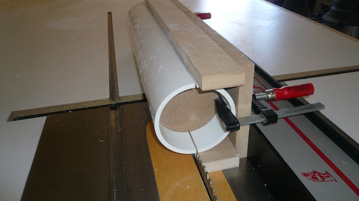

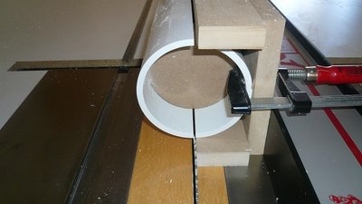

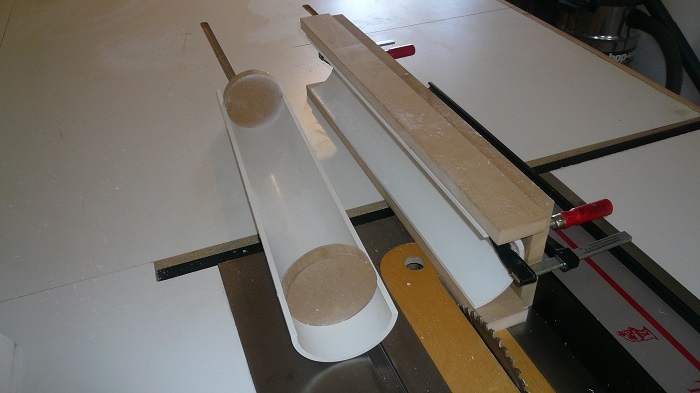

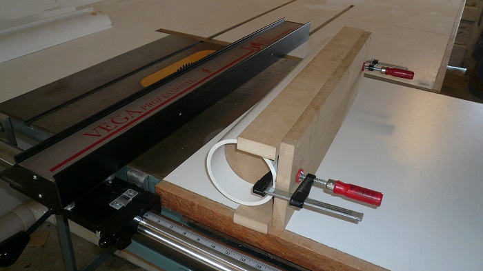

came up with a simple yet effective way of halving pvc pipe to make reflectors for the dr280s i'm currently building

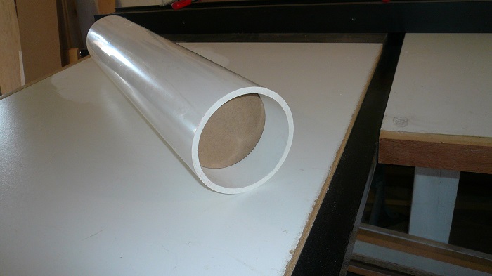

cut 2 disks from mdf to fit i.d. tightly
clamp to jig
clamp to jig
cut one side flip jig cut second side
pipe closes down on disks not blade
pull apart and repeat safe and easy

Ah you figured out the secret recipe of putting a plug in the pipe. The only kicker to that is the ID of differing brands of pipe varies more than you might think.
I hate cleaning up after cutting these things. Damn electrically charged shavings.

LelandCrooks wrote:Ah you figured out the secret recipe of putting a plug in the pipe. The only kicker to that is the ID of differing brands of pipe varies more than you might think.
They are messy alright. As for the differing i.d., i cut a small section of the actual pipe i'm using to trace a circle onto mdf and sand to fit :D

I'm brainstorming for the non-table saw user: Maybe you could make a second jig to go on the other side of the pipe, clamp that together, then use your jig/circular saw to slice it down the middle. Only issue I see is you're cutting through the jigs.
David Raehn
Posts: 676
Location: Colonial Beach VA
Re: cutting pvc
#7 Post by David Raehn »
Without a table saw, you can do just like Hotrod did, but add another bit to the top and bottom pieces to make it work like a circular saw sled.
