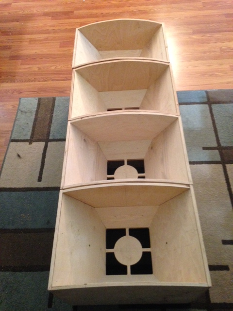

So after haunting the sight for awhile I have finally finished all the remodeling on the house. That means I can get back to building the Otops I bought parts for over a year ago. I cut everything and preassembled four units before having to go do a show today. Nothing glued yet just test fitting of parts and screwed. Should make assembly quick and easy tomorrow. I also made a master set of blanks that don't have any angles cut on them. I used a router to clone all the parts in a matter of minutes. just screwed the master to the plywood and let the shank of the bit act as a guide. Worked great. Used a 5 1/8" hole saw to make my phase plug discs. I still need to make the port/handle cuts and fit the landing for the back plate. I should have them assembled tomorrow. Then I can get started on the CD horns. I had planned on building an rtm mold and making fiberglass horns but I will retrofit those at a later date and just go with the wood horns in the plans for now. I have to many new projects at work right now to do an off hours "government" project. Can't tie up the machine time. The curved front I went with made them a little more difficult but I really like the look. Anyway I will try to post pictures of my progress as I go provided I can stay on task this time and life doesn't cause any more interruptions.

It looks like I will be using crossovers in these instead of biamping as I had originally planned. We are trying to reduce weight in our amp rack and have been buying up all class D's (already changed out the entire monitor rack). Seems silly to buy extra amps and add weight when a correct crossover is already available.
Raining today so I couldn't get anything done. I was afraid to use PL inside a freshly remodeled house. The wife might frown on dropping adhesive on the nice new hardwood floor in the background of the pic I loaded in the first post. I'm pretty sure divorce would slow down the build a little.

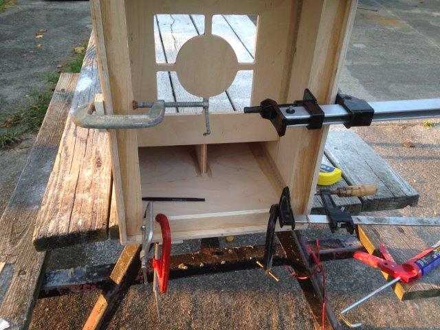

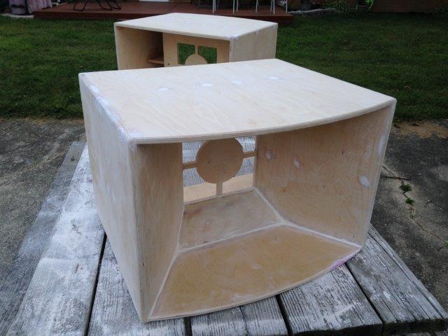

A little more progress with some pictures.
Been working on a surprise for the CD horns. Hope to be able to post some pictures of that tomorrow.
Also making a slight alteration to the front of the baffle when mounting the phase plugs. I have to complete the horns before I can implement it though. It plays no effect on the shape or size of the plug.
Plenty of glue squeeze out
Roundovers done and all the holes filled and body work complete

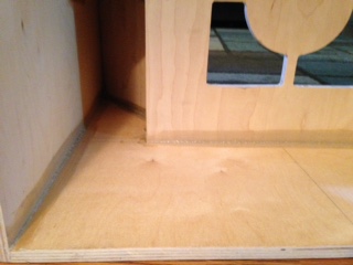

Got the stop rail for the back plates installed. Yes I know I need to double the thickness. I plan to lap the corners when I glue the second layer on.

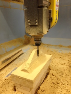

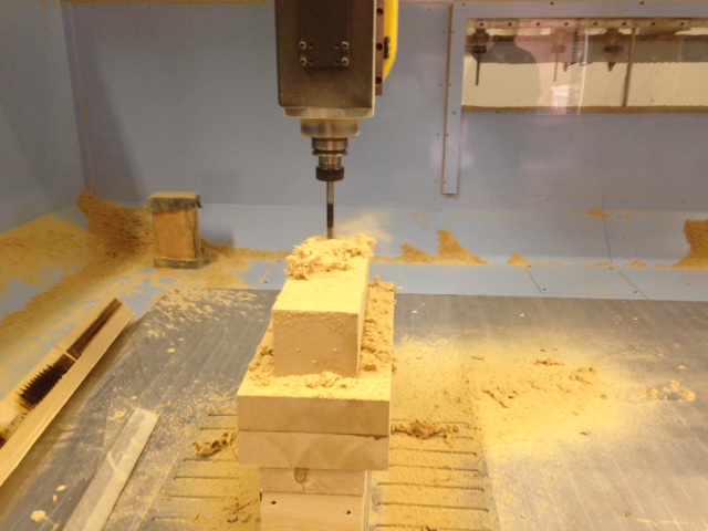

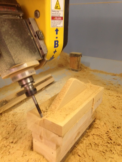

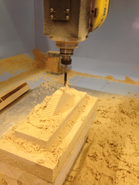

Well I haven't posted for awhile. I decided to move forward with making fiberglass horns. I am not going to RTM them (molded smooth on both sides in a closed mold) because of time constraints. I am however making a mold for open molding them. These will be smooth on the interior and have a rough glass finish on the exterior.
Got a block together and started machining today. Our engineer who is a much better programmer than me when it comes to patterns posted the path for me. Got the rough path done today and will run the finishing paths tomorrow morning. I should have it sealed, painted, sanded and waxed by the middle of next week. After that the parts are easy to make.
My plan is to pull a master pattern from the temporary wood mold first. If I can pull 5 pieces after that off the temporary I will finish my cabs before going back to make a permanent mold. I will use four for myself and would like to send one to someone of Bills choosing or Bill himself for testing.

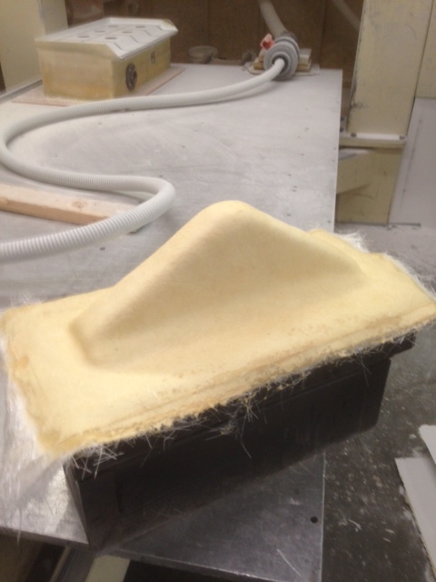

Well, ask and you shall receive.
Here are some more pics of the progress of the glass horns.

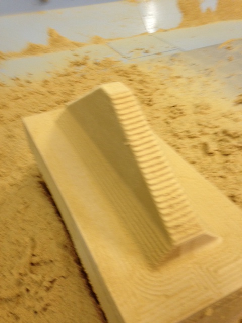

finishing pass
finishing pass
finished block
finished block

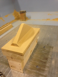

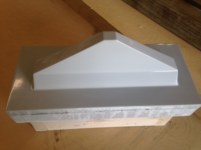

finished temporary mold
permanent mold made from non shrink resin

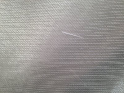

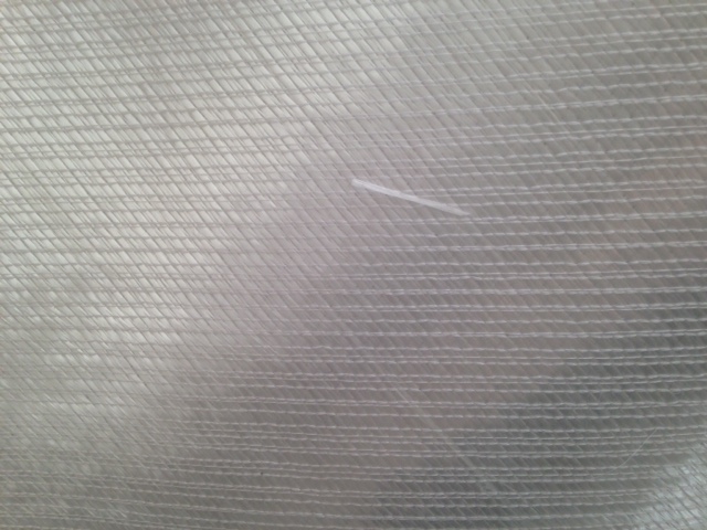

the glass is random fiber sewn to a bi-directional cloth VERY STRONG

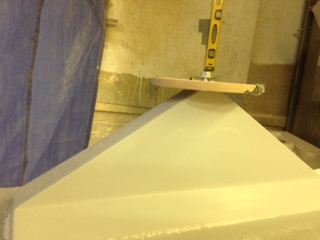

Correction to the last pictures. The one marked "permanent mold" is actually the permanent pattern to make the permanent mold from.
The story continues below:
mold with add on for flange

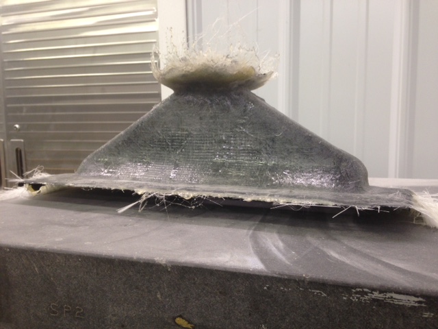

rough molded horn
rough molded horn

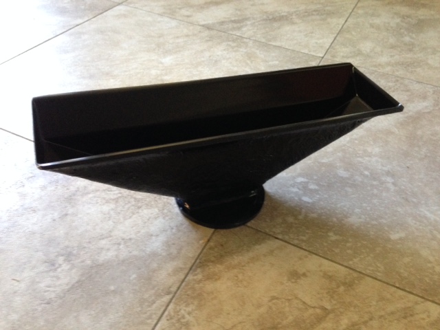

finished horn
finished horn
